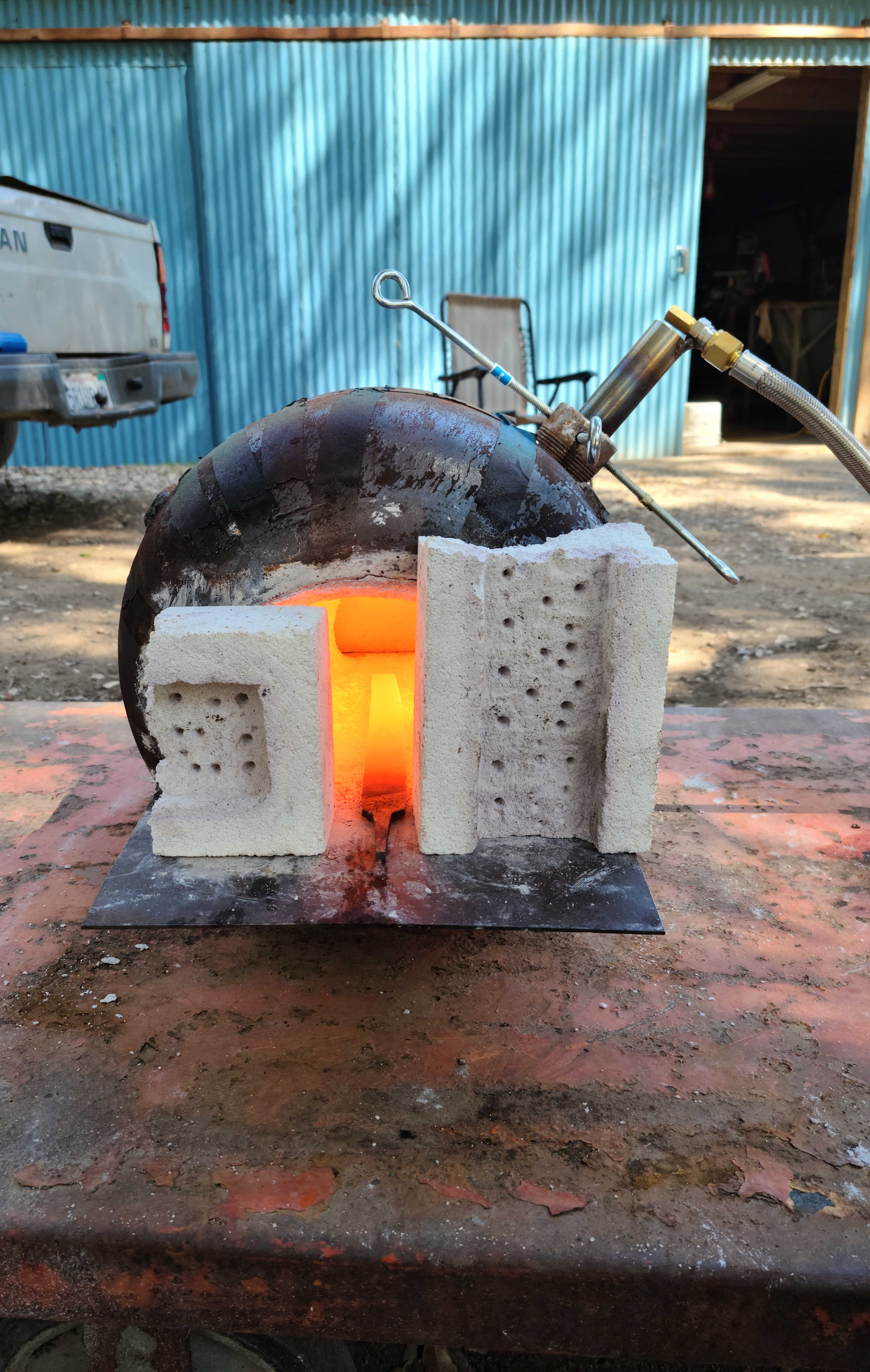

WRLD Posted April 9, 2021 Author Share Posted April 9, 2021 Fired the rigidizer to dry it. Had a little bit of trouble getting the burner to stay lit. I think it was angle problems. Ran it at low for a bit then turned it up to get it red. Noticed the food coloring is gone? Also the blanket feels firmer but not rigid. 32 minutes ago, Frosty said: If you're using Kastolite do NOT try to "DRY" it! It's a WATER SETTING refractory and will be MUCH stronger. Ahh, should I have left the blanket wet with rigidizer before the kastolite? I assumed Dry rigidizer & blanket then kastolite & letting it dry slowly Quote Link to comment Share on other sites More sharing options...
Frosty Posted April 9, 2021 Share Posted April 9, 2021 My above was for curing the Kastolite. You did right for the rigidizer. It just stiffens the blanket up it doesn't make it hard. Don't worry you're doing it right. I may have misread something I didn't need to post the warning. Frosty The Lucky. Quote Link to comment Share on other sites More sharing options...
Mikey98118 Posted April 9, 2021 Share Posted April 9, 2021 1 hour ago, WRLD said: Fired the rigidizer to dry it. Had a little bit of trouble getting the burner to stay lit. I think it was angle problems. More likely it was all that super-heated steam, blowing the flame out. Just another curious non-problem Don't forget to drill a tiny hole in the bottom of the shell, for steam and water to run out through, because your next layer will not be able to get rid of steam fast enough otherwise. Quote Link to comment Share on other sites More sharing options...
WRLD Posted April 9, 2021 Author Share Posted April 9, 2021 That makes sense. Kastolite 30 is probably going to take me a couple days. I'm worried that my floor will give way if I flip it to coat the roof. Would It be better if let it dry enough to flip it then proceed with the high humidity cure? Or cure the floor then in a couple days do the roof? Quote Link to comment Share on other sites More sharing options...
Frosty Posted April 9, 2021 Share Posted April 9, 2021 Let the Kastolite set before turning it over or it might sag. Once it's set it's pretty strong, no need to cure it before rolling it over, set up will be fine. Frosty The Lucky. Quote Link to comment Share on other sites More sharing options...

WRLD Posted April 11, 2021 Author Share Posted April 11, 2021 Last bit of kastolite is setting. My shop has been around 86°F today. I've kept a damp towel over the forge, Everything seems to be curing pretty nicely! Quote Link to comment Share on other sites More sharing options...
Frosty Posted April 12, 2021 Share Posted April 12, 2021 That's a great temp, wet it and throw the towel IN the forge, and bag the forge in plastic. Once Kastolite sets you can't wash it off in a flowing creek, I didn't try a pressure washer but couldn't get it off with less than hammer and chisel. Seriously, I couldn't get it to clean out of a cut down plastic milk jug I used to mix it. Frosty The Lucky. Quote Link to comment Share on other sites More sharing options...

WRLD Posted April 12, 2021 Author Share Posted April 12, 2021 I fired the forge on low for a couple minutes and then let it cool this morning. Now later in the evening I fired and ran it for a bit. Quote Link to comment Share on other sites More sharing options...
Frosty Posted April 13, 2021 Share Posted April 13, 2021 If it's lined with Kastolite the multiple heat cure doesn't improve anything. Kastolite works best with the 100% humidity cure. As far as the hard refractory is concerned it's ready to go to work. IF it's Kastolite. Frosty The Lucky. Quote Link to comment Share on other sites More sharing options...
