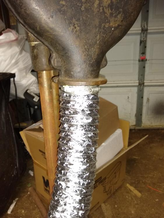

LaneSiders Posted September 26, 2020 Share Posted September 26, 2020 So, I posted some pictures of my forge in the "Show me your forge" thread. I am new to this little obsession and am looking for some tips here and there. In this particular case I have a question about attaching my blower. It's the image below, a Champion 400 that works great. I bought it, a couple cross peen hammers, and the former owner's excessively large fire pot for $100. The fire pot is far too large for me at the moment (it's a hub of some sort off of an old tractor trailer) so I made my own brake drum forge. At the moment I have a hair dryer attached as shown in the other picture below. However, I am trying to figure out how to attach the 400 because I have learned it will work wonderfully. My current tuyere is made from 2inch (internal diameter) formerly galvanized pipe and fittings with the hair dryer attached as shown. The 400 has a roughly 3 inch exit and my piping is slightly larger than 2 inches externally. Anyone have suggestions for the best way to get air from one end to the other? Thanks in advance. Quote Link to comment Share on other sites More sharing options...
Glenn Posted September 26, 2020 Share Posted September 26, 2020 Use some 3 inch diameter expandable aluminum dryer vent pipe. Crush the ends to make a connection and use a couple of radiator clamps joined together to make a larger diameter clamp to secure it in place. Quote Link to comment Share on other sites More sharing options...

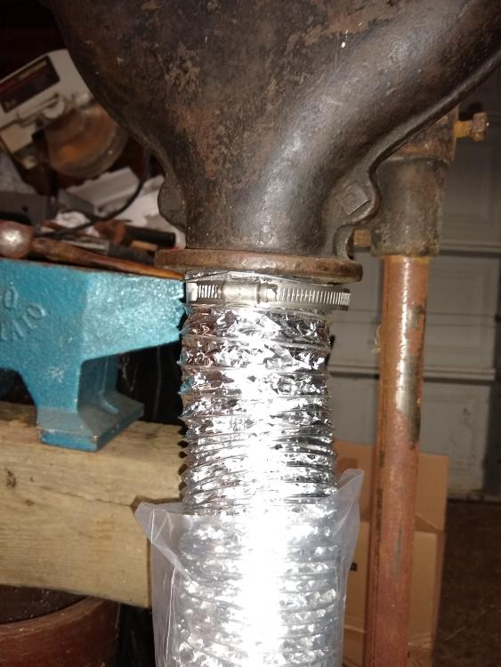

LaneSiders Posted October 3, 2020 Author Share Posted October 3, 2020 Well, I checked out the interior of the 400 and it was well maintained. The blades are all intact and the interior is free of varmints. The gear box looks like he have used a thicker grease to lubricate but the gears are in excellent condition and it turns smooth. I went to the hardware store and hunted all around for the aluminum dryer vent hoses. I found them and they were all 4 inch diameter. But off to the side there was a that looked like the smaller generic version of all the others. It was 3 inch but labeled specifically NOT for dryer vents. Since I am not using it for a dryer anyways I figured I was in luck! They also had 2-4 inch hose clamps there so I got a couple and now can use my blower once it's cleaned and oiled. Thanks again all. Quote Link to comment Share on other sites More sharing options...

pnut Posted October 3, 2020 Share Posted October 3, 2020 The collapsible hose shouldn't get that hot. I'd just keep an eye on it to make sure for a couple sessions though. How do you like that little accacio anvil? I have one and was pleasantly surprised by it. Unbeatable for the price. Pnut Quote Link to comment Share on other sites More sharing options...
LaneSiders Posted October 3, 2020 Author Share Posted October 3, 2020 Yeah, that's the thing I was going to be watching when I try it out. I figure as long as I keep it the same distance as I had the hair dryer it should be fine. Plastic is less forgiving than aluminum. And I really have no complaints about the anvil for the price. It's face is hard enough to function for its purpose and soft enough that when someone I let use it (me) hit a little off target (totally missed) because I was distracted (startled out of my skin) by a large and dangerous woodland creature (squirrel) it only left a minor dent and did not chip or crack. I made sure that the 66 pound one I got was steel faced, because the lighter ones are all cast iron. I am passively looking out for bigger and better but this one keeps me swinging hammer, so it works for now! Quote Link to comment Share on other sites More sharing options...
Frosty Posted October 3, 2020 Share Posted October 3, 2020 You don't need the RR spike counter weight, the length of round stock is plenty. If it does need more you can wire pieces to it until you find what works well before you weld them on. My bet is no extra weight is plenty but I'm wrong often enough to expect it. Your air connection is fine, the supply side of the tuyere rarely even gets coffee warm. Frosty The Lucky. Quote Link to comment Share on other sites More sharing options...
LaneSiders Posted October 25, 2020 Author Share Posted October 25, 2020 Just because I remembered that a couple different people mentioned it on this thread, I wanted to point out that I added the 4in. pipe nipple that was suggested for ash accumulation. I also welded the flap hinge that I fabricated directly to the nipple so that it is more secure. And I left the railroad spike at the end of my handle only because I think it looks neat. If I am ever hurting for scrap steel I can always hack it off in case of emergency! Also, the vent pipe works great. Quote Link to comment Share on other sites More sharing options...
