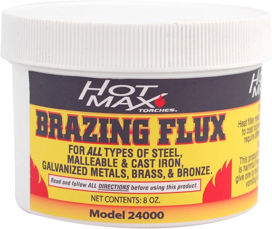

Thanks for the tips. I was looking for some flux before I did this job, but there was nothing available locally. Is powered flux the way to go? I've seen both powder and paste on Amazon. Below is an example of the powder flux. Would it be a good choice? I've got a broken Langdon Mitre Box from the 1800's that I'd like to try repairing next and will try and follow your suggestions for that one.

That one does not have any fluorine compounds, so I say it is a good choice for a general braze flux. Keep away from the ones containing fluorine compounds unless you know exactly why you need it, and have good enough ventilation (1st) and PPE (2nd, and necessary but no substitute for active ventilation) where you and others around won't be breathing it. Keep in mind where the vented stuff goes, too.
https://www.hotmaxtorches.com/download/msds/24000%20Brazing%20Flux%20Powder%20MSDS.pdf
