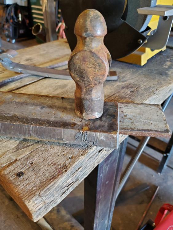

I was thinking of welding a piece of 3x3x1 steel on the face of this old ball pien. Think this would work as a flatter or is the 1" an overkill?
The issue this has is a ball pein is relatively high carbon steel and they do NOT like being hit with hammers, they can work harden, become brittle and chip. You'll make just as good a flatter and not have a safety issue if you use mild or medium C steel instead of the ball pein.  A flatter typically requires a harder blow than a top cut or punch to do it's job and work hardens much more quickly.

Why not just weld a handle onto the 3 inch side of that piece of steel?  Lay it onto the metal that needs flattened and whack it with a hammer.
A flatter is a tool that gets hit with another hammer so having the top of it something that is easy to hit with another hammer and does not damage it is a good thing.

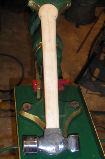

A better option would be to forge the ball peen into a cross peen or a straight peen to give you another working hammer (I made one into a diagonal peen, which I find I use much less than I anticipated). You can also forge that hammer head into any number of different top tools: chisel, punch, fuller, swage, butcher, texturing tool ... the list goes on and on. Also, some folks make them into tomahawks or carving adzes. Really, the only limit is your imagination.
Something like this John?.
Exactly. Just pick the direction you want the peen to run and flatten the ball down into a wedge shape that points that way. Keep the ends square, and you're good to go.

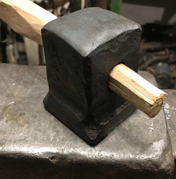

FYI, here’s my flatter, made from a big sledgehammer head, cut off on one side of the eye and with a new eye punched through. I love it. Works great with the treadle hammer.
"Keep the ends square", you mean the top and bottom of the ball turned peen?
No, I actually meant “edges”. Sorry.
