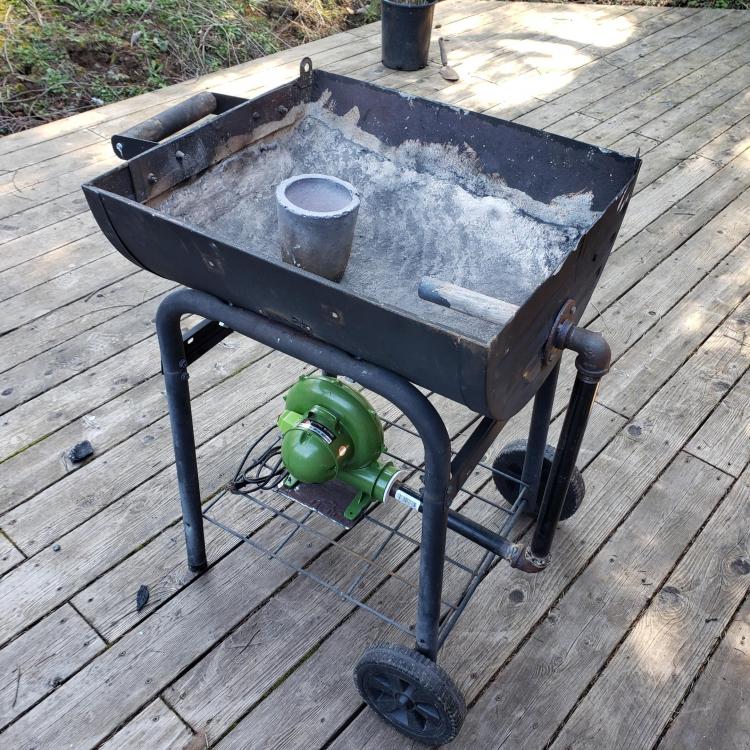

Here's my homemade forge/foundry:

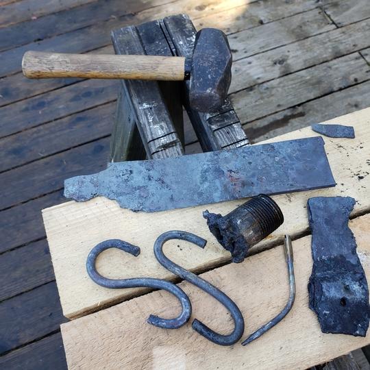

As a matter of possible interest, I am posting the results of my preceding inquiries and the valuable responses.  Impatient to start hammering, I abandoned making my own anvil and bought a 35 kg Peddinghaus and made a stand from bolted lumber and angle iron, a design copied from pics on this forum. It's a small but decent anvil that could probably be resold for a decent price to upgrade someday.  I tried to fold and forge-weld a piece of flat iron with limited success. I brazenly disregarded proper beginner humility and attempted to hammer a section of lawnmower blade into a knife which cracked and failed disastrously.  I wanted to take a shot at it just to get me thinking about the task. Starting with the right material could be important, huh.  And I made a couple S-hooks which are actually useful.  I also melted some copper pipe in the crucible.  It was all quite enjoyable.  I'll probably make some forging tools next like a crucible pouring tool.

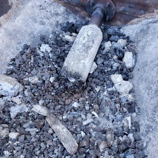

Also, I wanted to comment on the tuyere.  Next to the S-hooks is the pitiful remainder of the original black iron pipe tuyere after melting the copper.  I mean, I knew such tuyeres were considered consumable, but that one melted in one day!  So, I degalvanized (in vinegar) some steel pipe and poured Kast-o-lite into a can around the pipe to make an insulated tuyere.  Shown in the pic is that tuyere after one blacksmithing session which included coke so it could have been fairly hot.  It seems to be holding up but we'll see how it looks after using the crucible with it.  I figure it will probably still melt but am hoping for a lifespan of weeks or months rather than hours .
First of all, congratulations on abandoning your earlier idea. As a friend of mine said to me once (possibly quoting someone else), 99% of strategic thinking is learning what to say No to.
Second, good choice on the anvil. Reputable manufacturer, decent size, good design. You may find that you never replace it, even if you do end up adding another anvil or seven.
Third, your forge leaves a LOT to be desired, but it's an easy fix. Look up the threads on the JABOD (Just A Box Of Dirt) forges, and fill up the bulk of your BBQ with dirt. Trust me; you will be much happier with it, and you won't be wasting fuel.
Finally, how are you regulating the blast from your blower? I don't see any kind of valve or speed control.
You've made a decent start, and with a few simple tweaks, you should be tearing right along. Good luck!

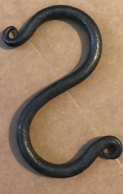

Molten, just a recommendation on you s-hooks:
Start with the length of stock you need for the size hook you making (keep in mind that the section the will be tapered will approximately grow in length by about 2x). Then taper one end square. Once the square taper is drawn out, round it up. (Alway draw out in a square cross section, the go to octagon by hammering the corners in, the bring to round.) Then, start a small roll on the point. Just light taps off the side of the anvil, flip an knock the start of the curl back toward yourself to finish it up. Quench this small scroll, it will burn easily being thin, so starting colder that the rest of the stock when going back in the fire will help a little. When up to temperature, bring it back out quench just the scroll (to avoid deforming it), and hold the scroll up just of the anvil and tap it down to start this end of the hook. Keep feeding the material off the anvil to continue the bend. You’ need to flip it over and bend it back toward you after a little over 90degrees. Repeat with the other side, but trace the curve of the first on the anvil to match the second side.
Doing hooks this way will really help develop several different skill sets: tapers, scrolls, bending, forging to specific dimension (match both sides in this case), fire control, hammer control, etc.). As you make a couple, compare the results as you  go and try to make each one better than the last. They also make a pleasing, graceful hook, that will sell if is an option for you.
I’m not trying to belittle what you have achieved (which is pretty cool), just trying to help you get to the next level...Picture below as an example.
Keep it fun,
David

Believe me, I’m not trying to be negative about you first hooks! I would love to say that you should look up local blacksmith group and spend sometime working with them. That’s usually on of my first recommendation, because it made such a big difference for me (and my sons). That’s not a option now, in the current situation, so I just wanted to give the same try of input I would give a new person visiting our groups hammer-in. Unfortunately, I can only really use the written word (not really my strength)  here. No where near as good as watch you a giving pointers first hand.

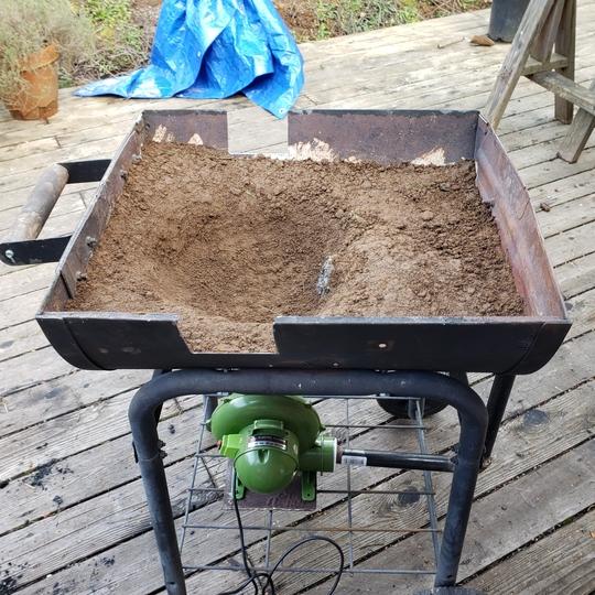

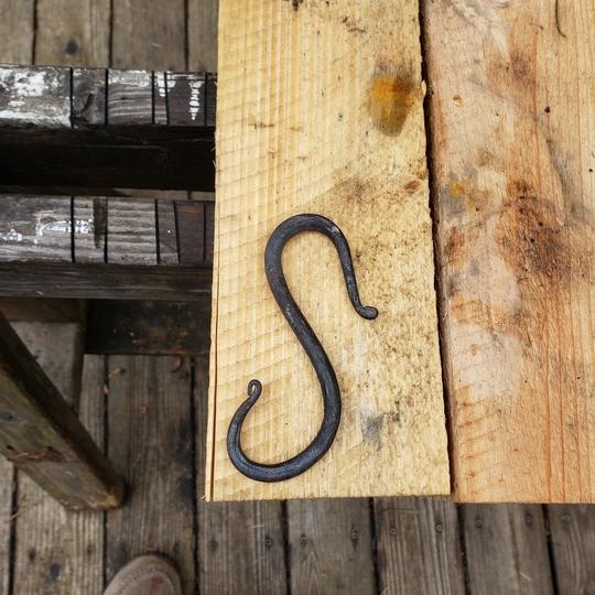

Regarding air flow control, the blower has a sliding window on one side but the control seems course and airflow seems high even with it closed.  I may have to get a  controller to vary the fan motor speed.  I took a more ambitious swipe at an s-hook with a little style.  Not symmetric but it does look like it was created to be an s-hook on purpose.
I dug up clay from my yard and reshaped my forge to have a fire bowl.  Much nicer.
Much better. You could make that hollow even smaller, about the size of a cereal bowl or half of a medium-size cantaloupe. Remember, you only need your fire to be big enough to heat your workpiece; everything else is just wasting fuel.
Can you rig up a lever or something to make it convenient to turn the air blast down between heats. You’ll save a lot of fuel that way, and if it not convenient, it won’t get used.
Your hook has a really smooth taper and nicely rounded out! I can’t even see hammer marks. Symmetry is hard and will come with time and patience, but I think you may have found your calling.
David
You're doing just fine, the folk chipping in are making good suggestions. Your last S hooks are looking better though you'd be surprised how many people will buy S hooks that are just bent without any forging.
