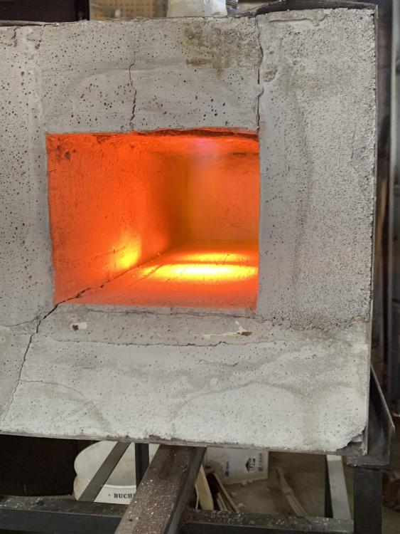

So I’m new to the smithing world been doing lots of research and what not way before I started to try forging. Now I have made a pretty good forge hits a grate gorging temp can bring it down to a good heat treat temp. But I just can’t seem to hit that welding temp I need to try and make damascus for some reason. Forge is 18” long and 5” x 5”  wide tall in the forge. Using a forced air system I have refined a few time it is all 1 1/2 pipe with 2 to 1 1/2 to 2” reducer fittings with a star pattern in them with 7/32 in the center 5/32 on the first loop and then 1/8 on the outside loop all holes are spaced 1/2 apart from center and I drilled them at a 10* angle on the first and second loops center is flat drilled. Using 2 20lds propane tanks for each burner with a 0-30 psi adjustable fuel pressure. Have to gate valves for the 2 tubes from the forge to the first 90 is 6” then 12” to the next 90 where I have my propane feeds at facing into the wind and then 12” to the blowers. Each blower is around 200-250 cfm.
 If anyone has something set up like this that can hit a welding temp would love to hear from you. Like I stated before I can make a great forging and heat treat temp just can’t seem to hit a welding temp to save my life for some reason
any help I can get would be much appreciated thank you

Sound like the burners are good, what is the forge made from?
I was going to ask the same thing. Is it solid hard refractory, or does it have a layer of ceramic wool around the outside? A large mass of hard refractory won't insulate well, and you'll be burning a lot of fuel to get it hot and keep it hot.
I have 1” kwool then 2” of refractory cement. I use kwool for the back till it’s nice n hot then I remove it and get everything tuned for forging. I left the kwool in on the back when I was trying to get it hot enough to weld tho
Personally I would have flipped those numbers and used 2" of kaowool with a thinner refractory cement layer.  I knew a smith with a heavy refractory forge that he could get to welding temps but only after and hour of running it to heat up the heavy refractory.

I'm thinking like Thomas that the hard refractory is soaking up a lot of heat. How long have you let it run trying to obtain welding heat?

You have a few issues working against you here. First as already mentioned WAY too much hard refractory and not enough ceramic blanket refractory, Kaowool IS a refractory, just not desirable in flame contact.
Where did you get the plans for the burner? That one really stinks on several counts. There is no good reason to point the gas jet into the air flow., ZERO. It's just some guy's idea of a better way to get propane and air to mix. If you're going to drill and weld for the gas jet put it well before the first 90, the longer it's in the air stream turning corners the more thoroughly it'll mix.
Blow driers are inadequate. One glaring reason you can't get welding heat is you can't put enough flammable fuel air mix in the chamber per second, blow driers just can't move enough air to burn enough fuel to do the job. Make sense?
Space your burners farther apart, about 1/3 spacing between for a 2 burner forge. As close as they are now the forge has a strong hot spot so it's not good for heat treating unless you're going to pass your blade back and forth through the heart in which case make your forge shorter.

When I suggested mattress inflators I forgot you'd made 1 1/2" burners and no, they aren't adequate. I heat a larger volume when my variable geometry forge is arranged for long stock. 4.5" x 8" x 18" with two 3/4" Naturally aspirated T burners, I haven't run the numbers but I'm running maybe 20% the burner you are and I can weld easily.
Naturally aspirated or gun (blown) doesn't really  matter. What matters is delivering enough fuel air mix per second to generate the heat. I don't have a dog in that fight, I don't care.
Your problem is NOT aiming the gas jet into the flow, you have them tuned nicely, nice flames. Unfortunately there just isn't enough mix available. If you use a shop vac, you should get plenty of air but you'll run into the problem of trying to force propane out of the jet fighting the air flow. A shop vac uses high velocity to generate high volume. Velocity is pressure and you've aimed the jet into it. It's no biggy, if it causes a problem turn the elbows you've mounted the jets in around so the jet is facing with the flow.  Yes?
Please don't think I'm harshing on you, I'm not I'm only trying to point out things to correct to get what you want. I've been messing with burners for more than 40 years though seldom gun burners. They're not really much different, fire is fire. Fuel, oxygen, ignition source = fire, a little more, a little less and you have the fire you want. It's a balancing act and I'll be honored if I can help you get up and running.
