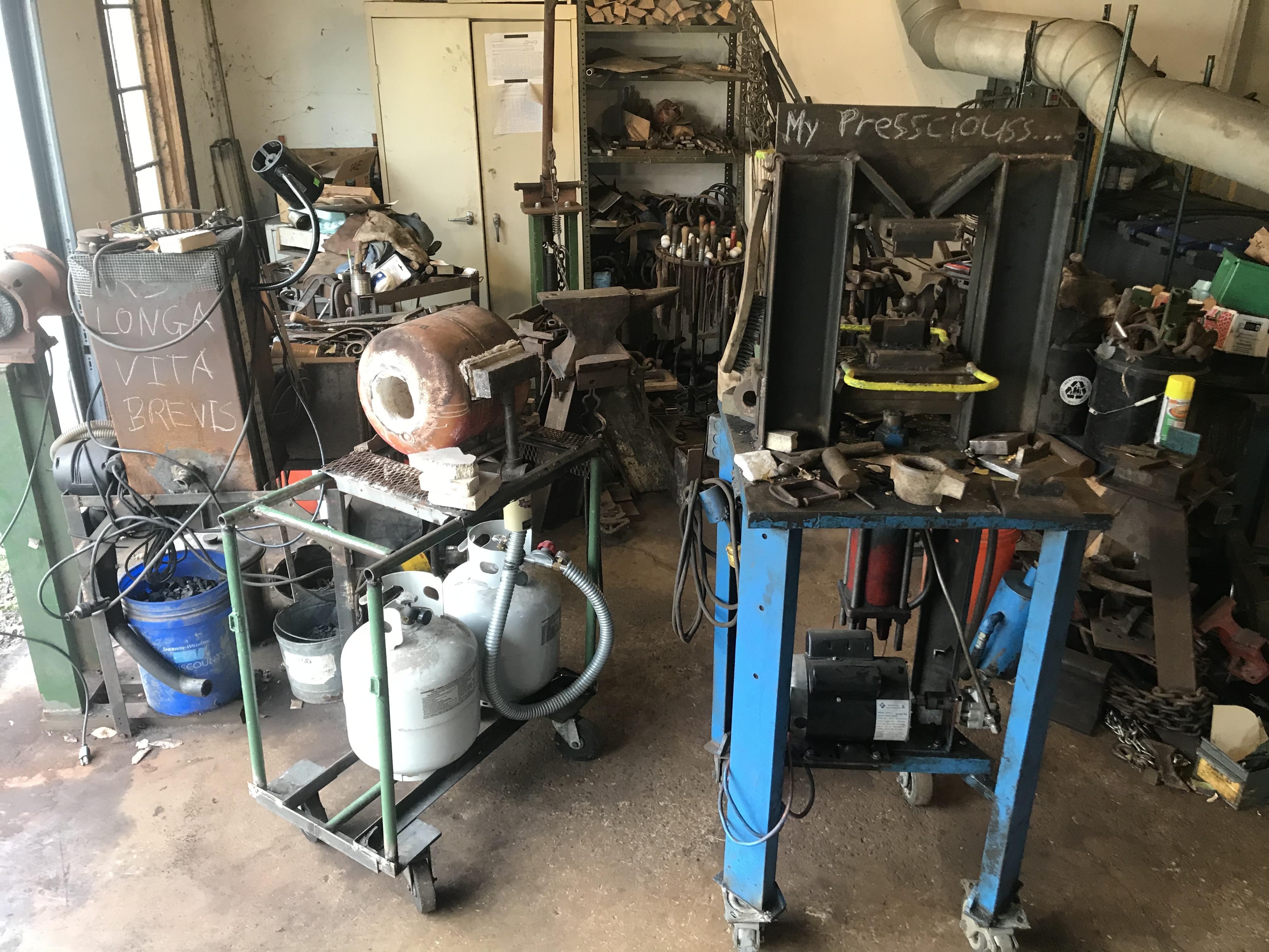

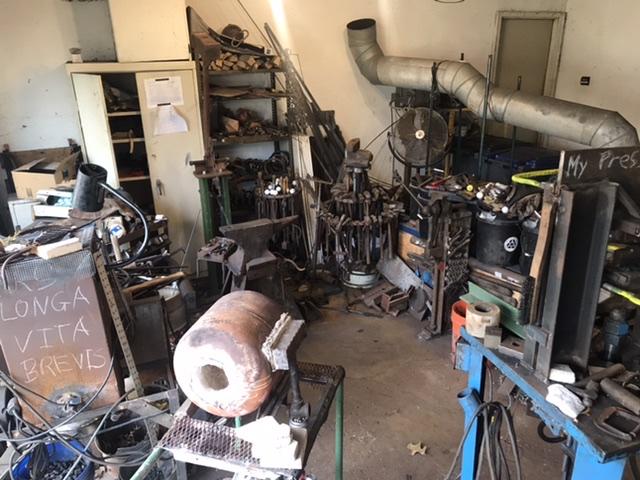

I'm a hobbyist working out of my garage, and my gear has rapidly outgrown the space I have available. In recent months, I've put my gas forge, my hydraulic press, my 2x90 pedestal grinder, my hydraulic press (aka The Pressciouss), my horizontal bandsaw, my chopsaw, and my quenching oil tank on casters, so that I can fit everything into a much smaller space when it's not in use. My coal forge, tool racks,  anvil (with its treadle hammer), and vise stand are not on casters (especially since the latter two need to be as immobile as possible), but I'm thinking of putting the coal forge on casters as well.
Here it is all packed away:

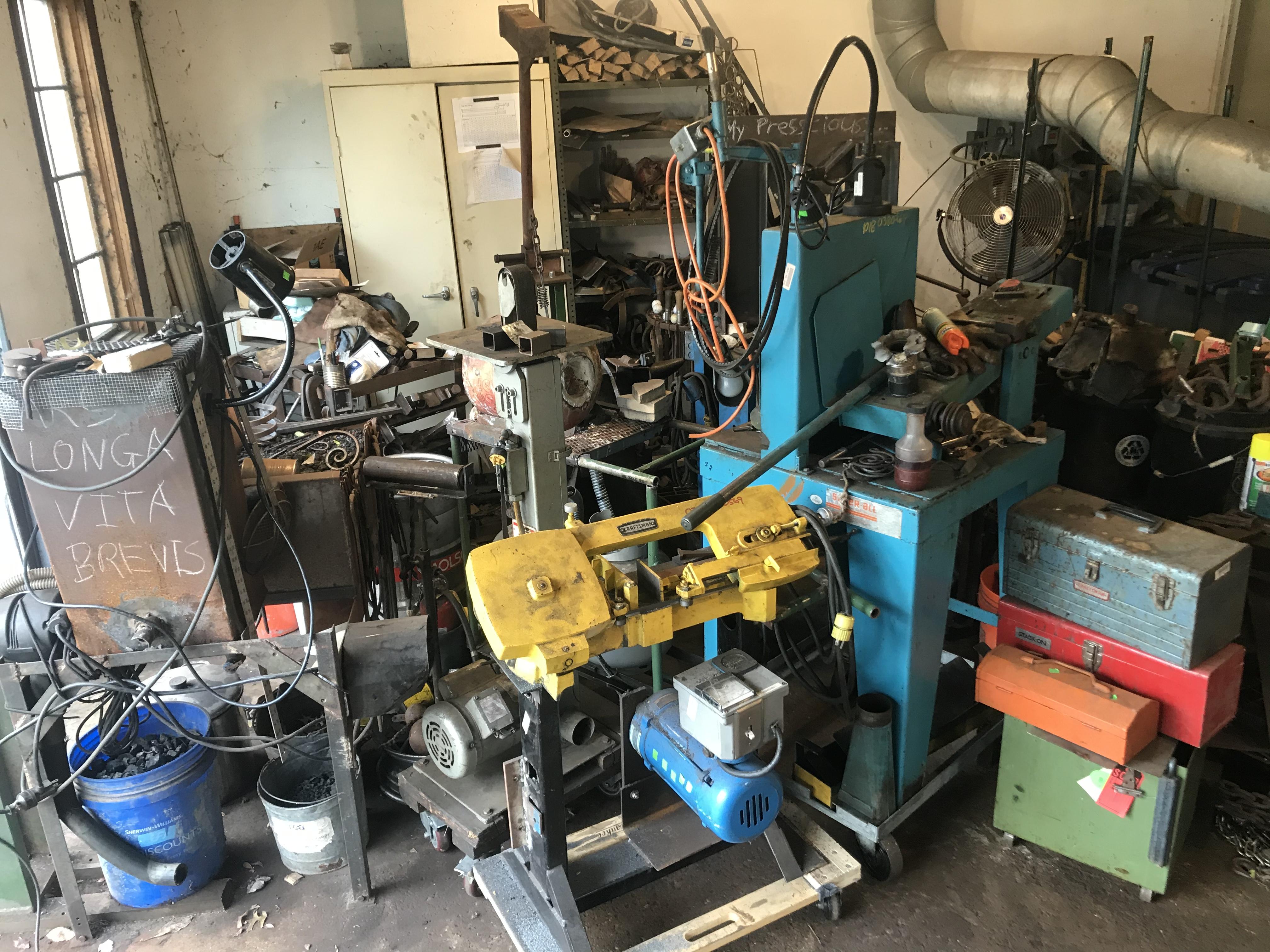

And here it is set up for forging (with the two saws and the grinder behind me and the quench tank moved to the driveway):
(I'll try to get a few more photos from different angles to give a better idea of how this works.)
It's amazing what a difference it makes being able to expand your workspace quickly and easily. At one point today, I needed to be able to get quickly from the forge to the oil tank out in the driveway for a quench, so I pushed The Pressciouss out of the way and moved the gasser closer to the door. Cut the number of steps from the front of the forge to the quench in half.

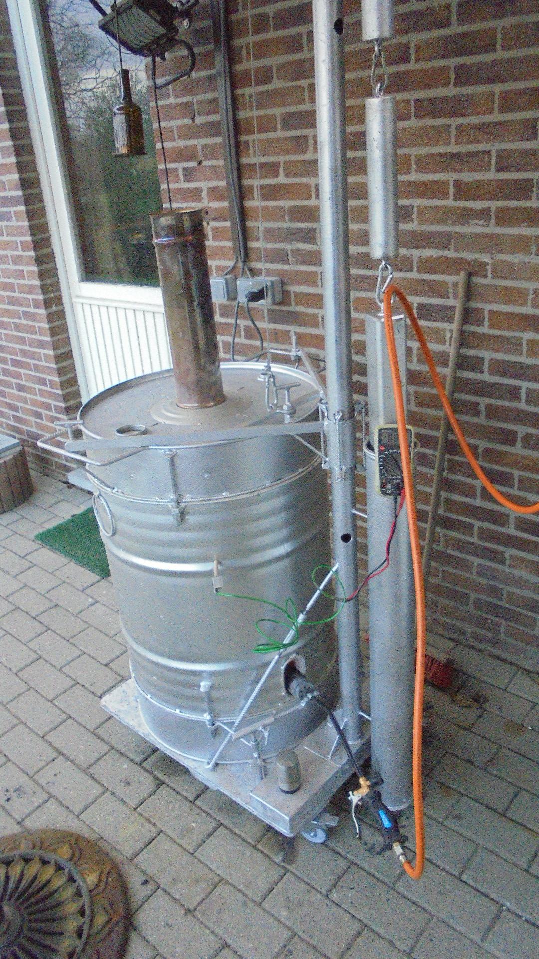

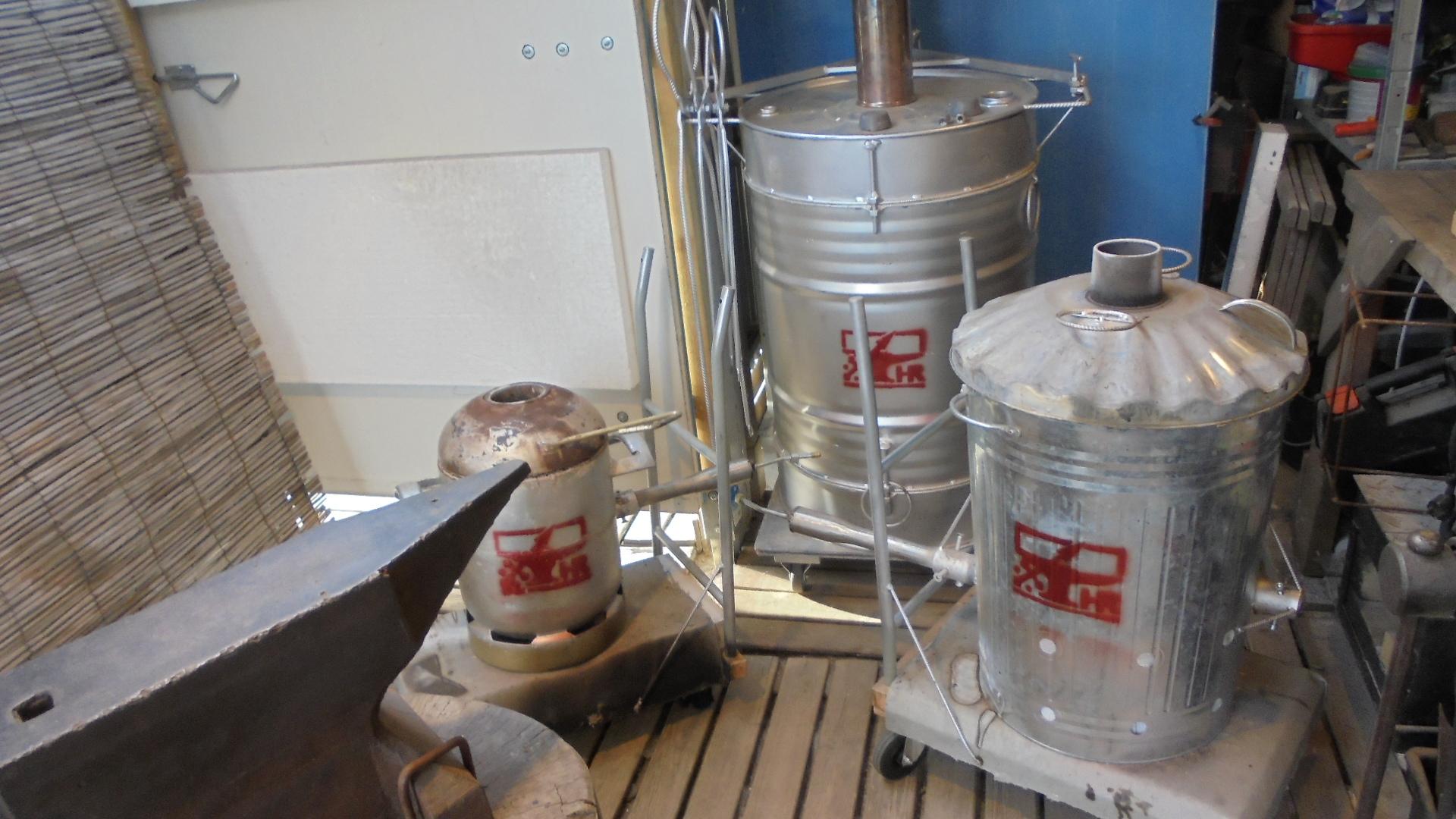

Very good 'movement', I have put the F&F Tumulus casting, welding and ceramic equipment on 'rolls' or transport carts from the very beginning. Partly due to a lack of space in our workshop.
However, two things that are very important for safety reasons. Point one, depending on the floor of your workplace, it is important that the wheels are large enough to roll over unevenness. Top-heavy equipment in particular tends to turn over when too small casters get stuck in slots or holes. Point two is a good brake or lock during use. It is very dangerous if your machinery starts to roll unintentionally if you are processing a glowing piece of material or in my case 'liquid soup' at 1200 ° Celsius.

Here's another view of the packed-up workspace:

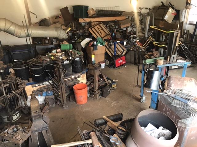

And these shows how much floor space there is when everything is unpacked:

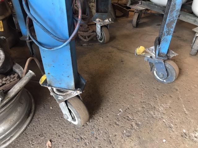

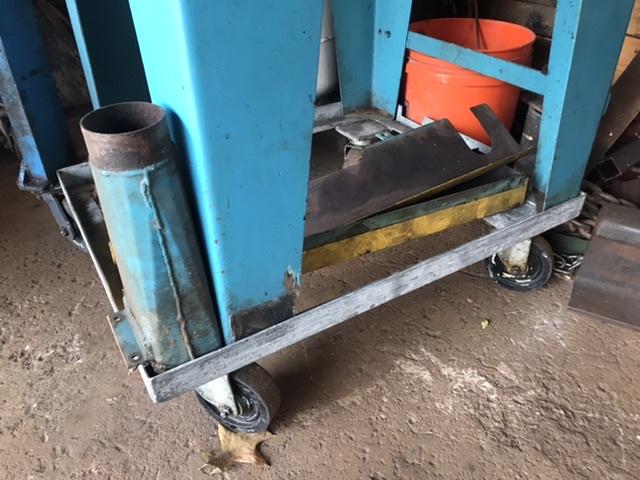

However, two things that are very important for safety reasons. Point one, depending on the floor of your workplace, it is important that the wheels are large enough to roll over unevenness. [...] Point two is a good brake or lock during use

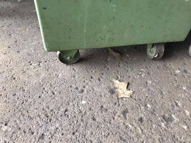

Most of the casters came off of carts and such from the industrial surplus warehouse and are pretty heavy duty. The exception is the oil quench tank, which came with a set of smallish casters; fortunately, it's pretty low to the ground:
The horizontal bandsaw sits on an old piano dolly with the carpet removed (so as not to trap the metal shavings):
The 2x90 grinder's wheels were on a material handling flow rack and lock. It can be a bit wobbly, but that was true before I put it on casters. A foot on the base solves that problem.

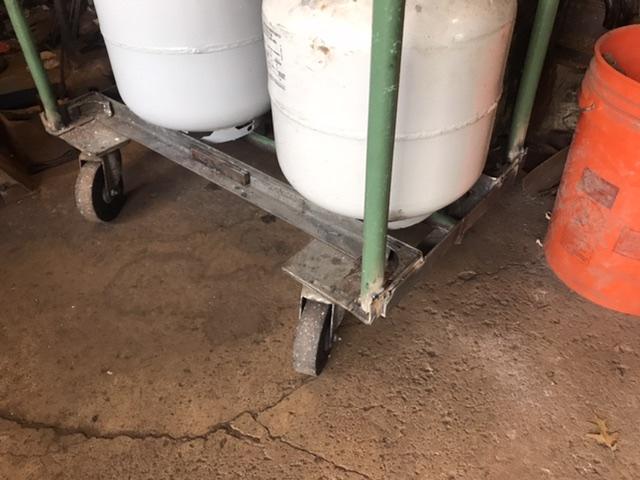

The chop saw and the gas forge are both welded to metal dollies; these don't lock, but I've got an idea for making some chocks that will keep the wheels in place when in use, but pull out easily when not:
The gasser's dolly got cut apart and reconfigured to make the base of the forge cart:
The casters on The Pressciouss are the largest and beefiest, and they also have a heavy-duty locking mechanism. These were also originally on a flow rack:

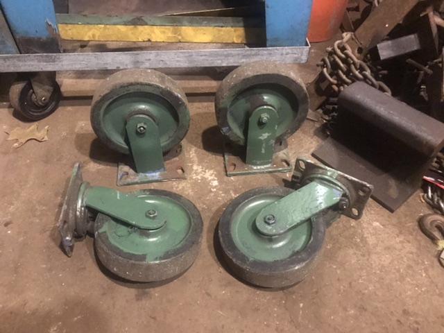

Then there are the REALLY big casters with the 8” wheels. Someday, I’ll figure out what to do with these.
i also have a set of those, pulled off my old boat cradle. May be one day I figure what to do with them :o
