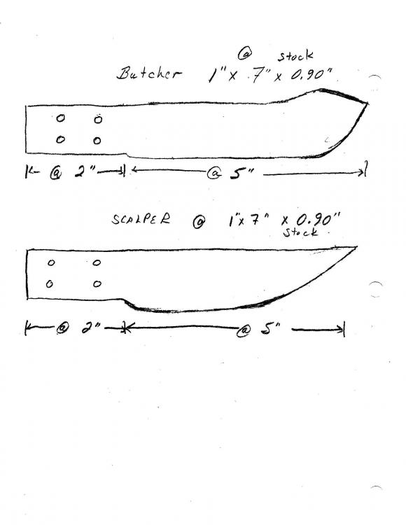

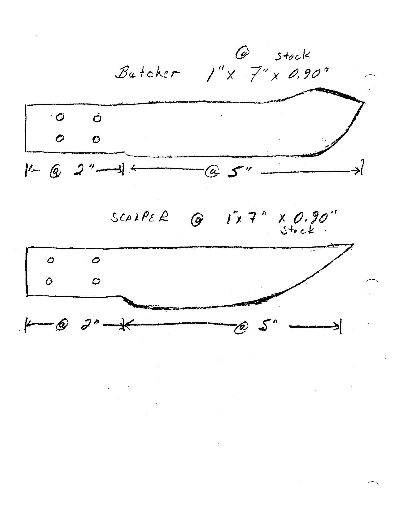

Bo T Posted December 21, 2019 Author Share Posted December 21, 2019 JHCC, Here are a couple of sketches. Link to comment Share on other sites More sharing options...

ThomasPowers Posted December 23, 2019 Share Posted December 23, 2019 Is that really 0.9"---almost an inch thick? Link to comment Share on other sites More sharing options...
Marc1 Posted December 23, 2019 Share Posted December 23, 2019 I was wandering about the same thing. Did they express fractions of inches using the metric system back then? Link to comment Share on other sites More sharing options...
Steve Sells Posted December 23, 2019 Share Posted December 23, 2019 I bet its 0.090 of an inch Also I have a 5 ft wooden folding rule that is marked in 1/10 of an inch Link to comment Share on other sites More sharing options...
ThomasPowers Posted December 23, 2019 Share Posted December 23, 2019 You mean using the decimal system not metric system. You might want to check on the history of the micrometer. Link to comment Share on other sites More sharing options...
Bo T Posted December 23, 2019 Author Share Posted December 23, 2019 4 hours ago, ThomasPowers said: Is that really 0.9"---almost an inch thick? Darn. My ruddy cheeks are some what redder. Steve is right-0.090". Link to comment Share on other sites More sharing options...
Frosty Posted December 24, 2019 Share Posted December 24, 2019 The dimensions on your sketches would result in pretty unusable knives Bo. Have you tried to apply leverage with a 2" handle? I don't have large hands and find a 4" handle a little small though not uncomfortably. I believe there are sketches and drawings of blades from the day and artifacts have been measured so it's not hard to interpolate dimensions for the original sketches and drawings. Where in general are you in Washington? I have kith and kin all over the PAC. Frosty The Lucky. Link to comment Share on other sites More sharing options...
