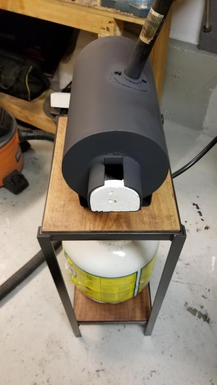

Hello all. I'm new to this just had the sudden desire to start metal working. Can't really explain that... so I bought a welder built a forge, anvil(cheap happybuy for now). I'd like to start by fabricating some blacksmith tools.  See were it goes.
Forge looks nice. I'm not an expert on them by a long shot. Who is the maker of your anvil?

I warn my students about not bending their head THROUGH the dragon's breath and once lost some facial hair helping a smith get their new to them propane forge working correctly. It wasn't tuned even close and wasn't putting out much heat. As their tank was down below the entrance I suddenly got a full blast of exhaust out of it when I hit the right fuel pressure/air mix.
Thanks Steve S. Good advise. I only use the forge outside and store the tank outdoors as well. I would hurt to get an extension and keep the tank away from the forge.

Thomas. This photo was take with a lower pressure regulator. I have since changed to a high pressure regulator and a smaller oriface. The result was a hoter forge and much less flame out side the forge. That said. I try to be vigilant of the flames and fumes coming out. Thanks for the good advise.
