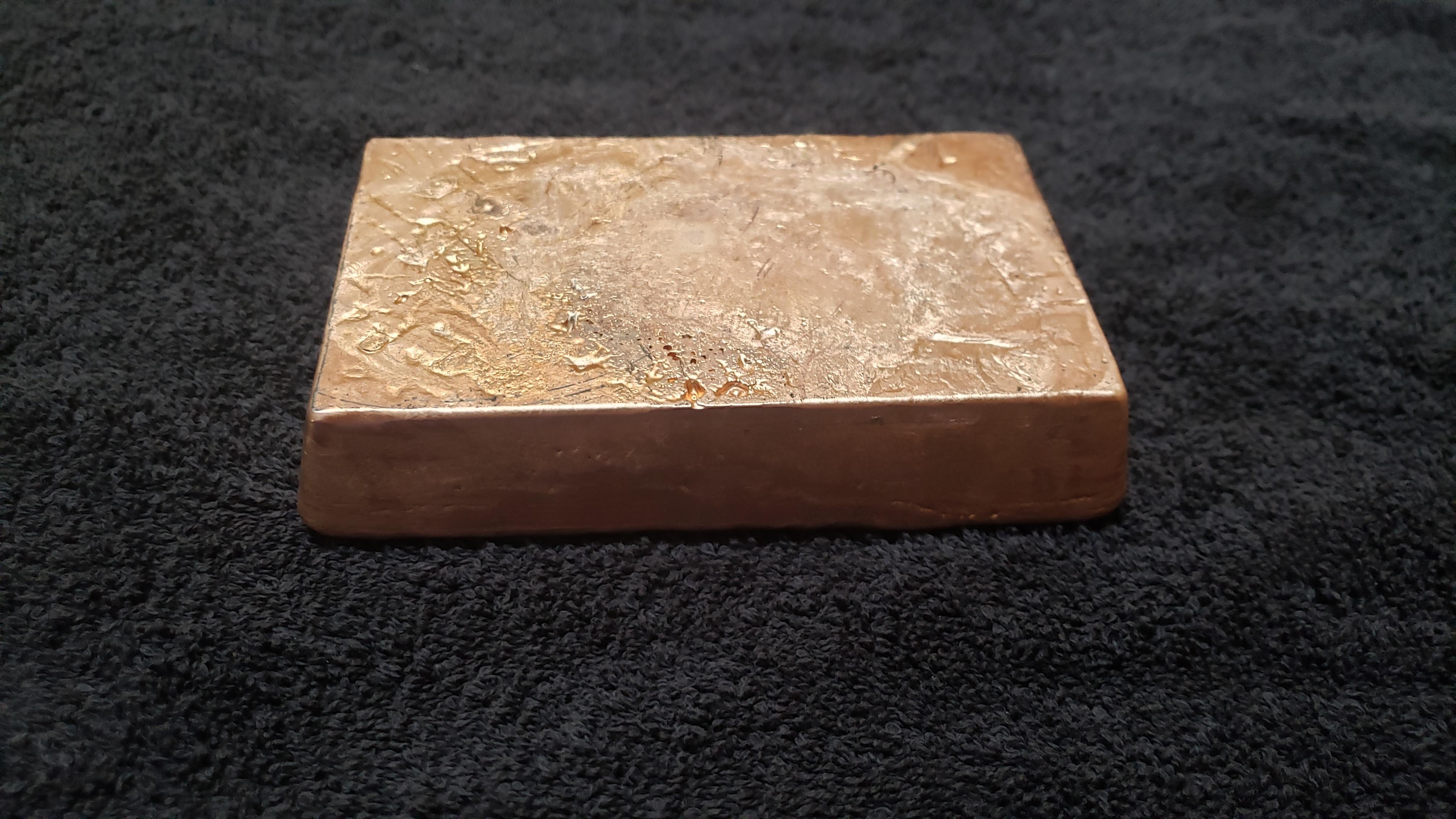

Hello all! My first post here so bare with me. I hope this is the correct area for this post. I am currently melting down copper scrap into solid 5 pound copper ingots. Everything is going well and really I am just fine tuning the forge and switching over to a forced all burner right now. What I am REALLY after is making a wire granulator, it basically just chops up wire into rice sized pieces. If I wanted to buy one it would be several thousands and would much rather make one of my own. Could anyone help with some plans? I have made several attempts at it but isn't that easy I have found out. Does anyone on this site have any experience or tips? I can make a lot of things but I seem to be wasting my time with this one. Thanks in advance for the help!

Forget granulating as that just increases the surface exposed to air and copper loves to suck up oxygen-not a good thing.  I would make a briquetter instead. Compress them down as small as you can. That way you have less exposure to the atmosphere. Many shops use briquette makers to handle the chips off of lathes and machining centers.
Yes I am making ingots for resell but refining them as well. I don't sell them to scrappers at all, currently averaging about $10 a pound right now. I was going to use the Granulator to keep space down but making I like the idea of smashing it down too. Only melt down select scrap wire and pipe.
I use a floating graphite powder during the melt and then phoscopper to Degas it. A lot of it comes down to proper air/ fuel mix. Copper should be melted under reducing conditions due to it absorbing hydrogen and other elements easily.
Here is one of my ingots:
