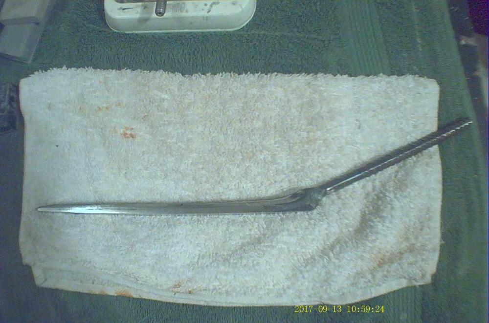

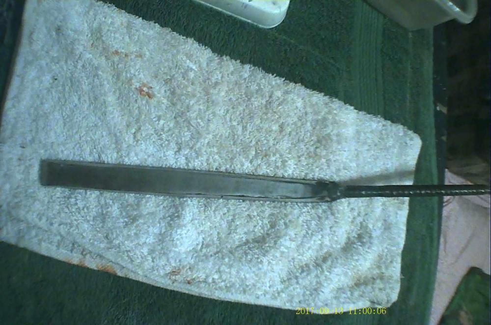

I forged out a bent handle chisel from O1 stock, but had cracks at the point where the handle met the chisel body, which I gas welded with ER70s rod. The cracking continued to be a problem, but I thought i had it whipped until I was trying to rivet the end of the tang on the handle, and the whole handle fell off. i want to save the work I did; any advice on welding on a tang? I have gas, stick, and TIG equipment available.
So maybe TIG weld on a mild steel handle after preheat, stick it in the forge, then into some vermiculite for a slow cool, then reharden the chisel tip?

If I start over, the same thing could happen; plus all the labor i already put into it will be lost. or, I can see if my recent repair of my gas solenoid worked on the TIG unit, weld on a handle, and use the chisel to finish the shirasaya for the sword I am polishing......option B works for me. Scrap pile is pretty big already :)
I guess it happened....first time in a good while i had the TIG attached to the welder. Tacked it up, then preheated with a MAPP torch, and finished welding it, then put it in the vermiculite bucket to slow cool. I didn't need to reheat treat the working portion, since it didn't get hot enough to change the temper. It even withstood the accidental drop test.
