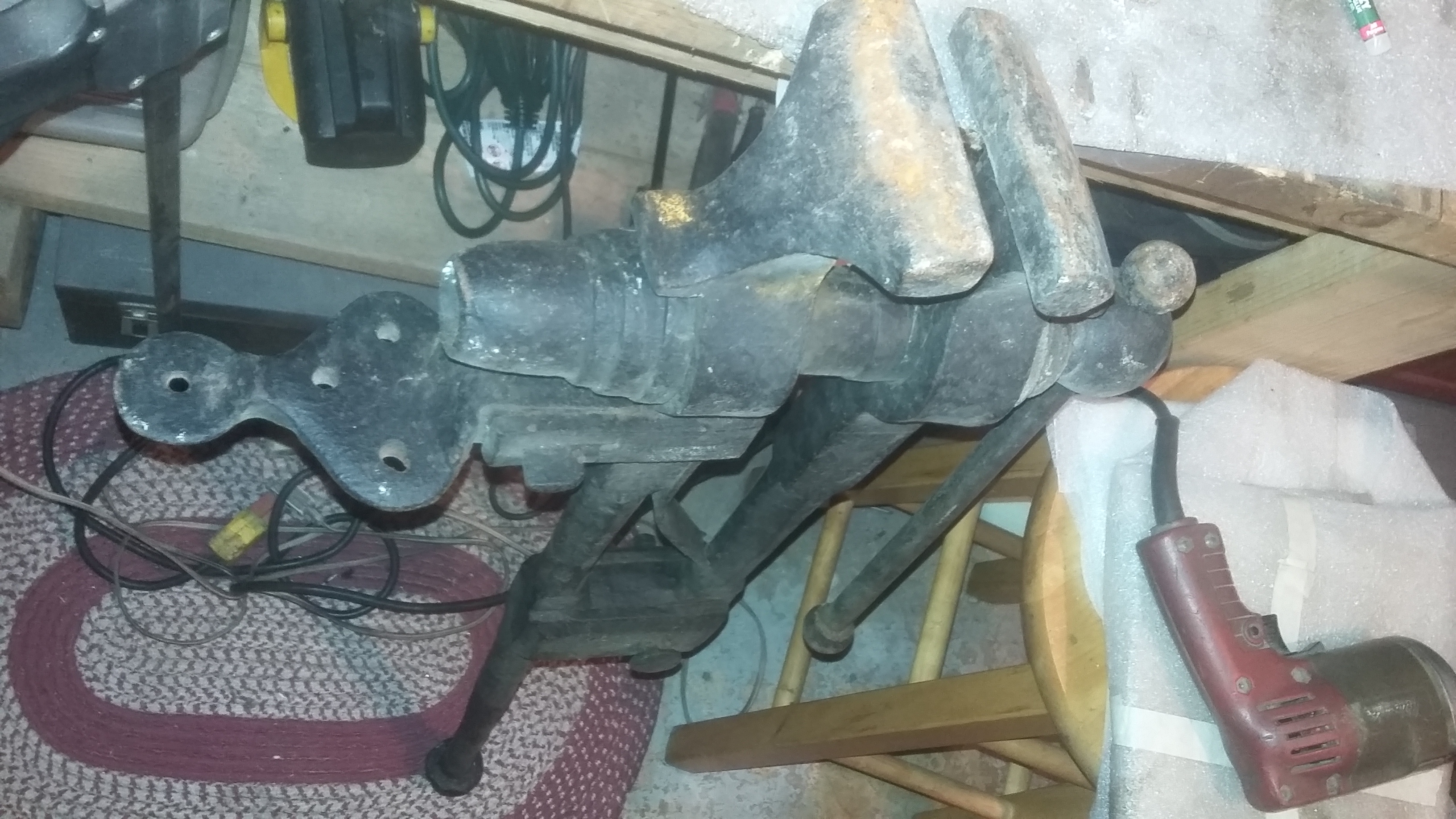

quitestorm000 Posted February 4, 2018 Share Posted February 4, 2018 On Sunday, July 06, 2008 at 12:30 PM, Jose Gomez said: If you can post a few pictures it might help us to figure out how to best repair the vice. Quote Link to comment Share on other sites More sharing options...
Daswulf Posted February 4, 2018 Share Posted February 4, 2018 Quietstorm, this is an old thread but are you saying " showing" that your post vise doesn't close properly? from what I think I see in the picture it could be that the screw and box are from a different vise and longer or thicker then your vise should have. If that is the issue I'm betting it can be fixed a couple ways. Quote Link to comment Share on other sites More sharing options...
