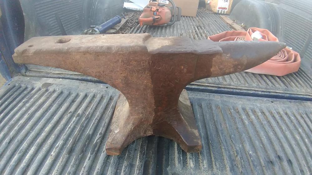

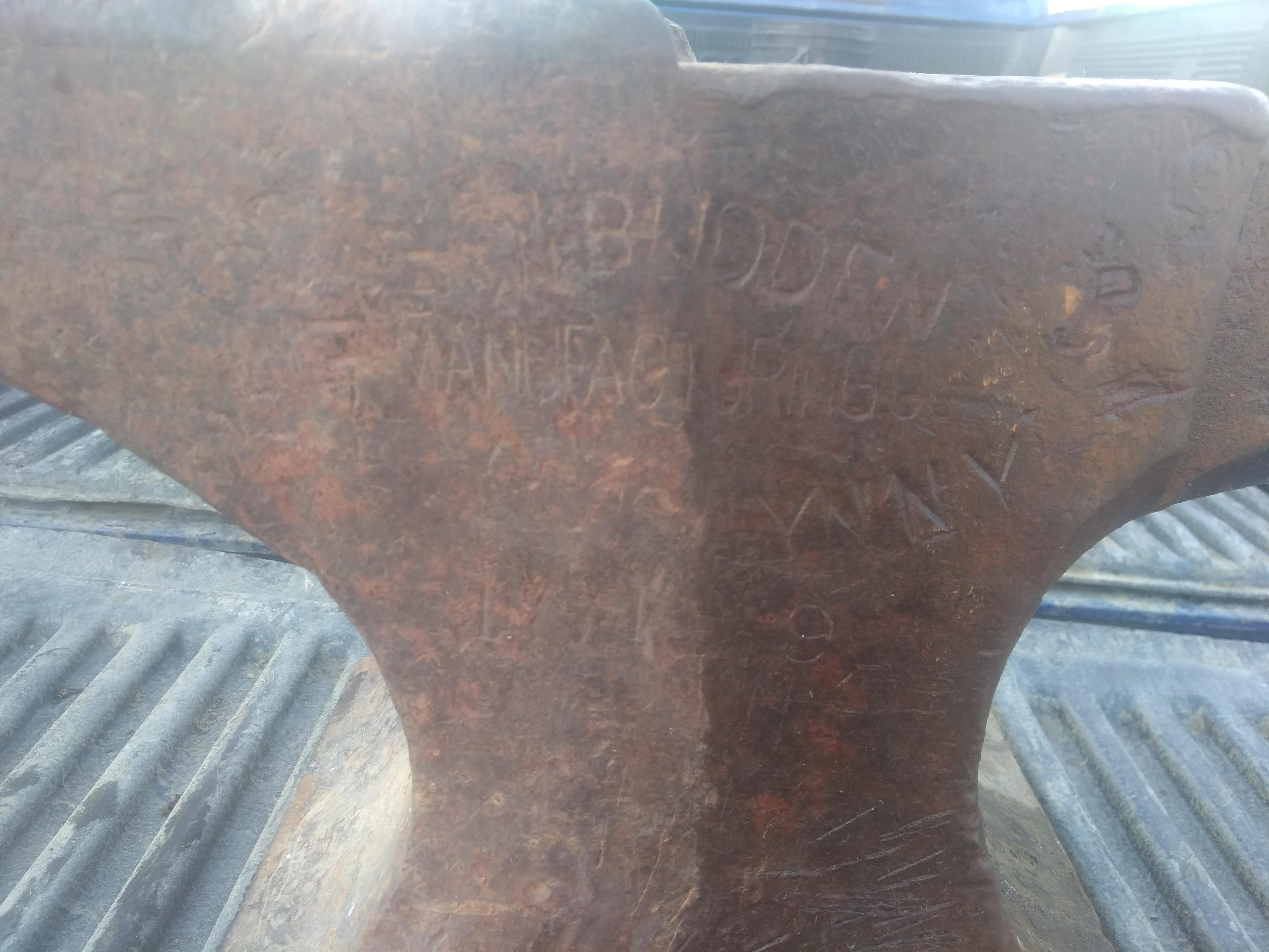

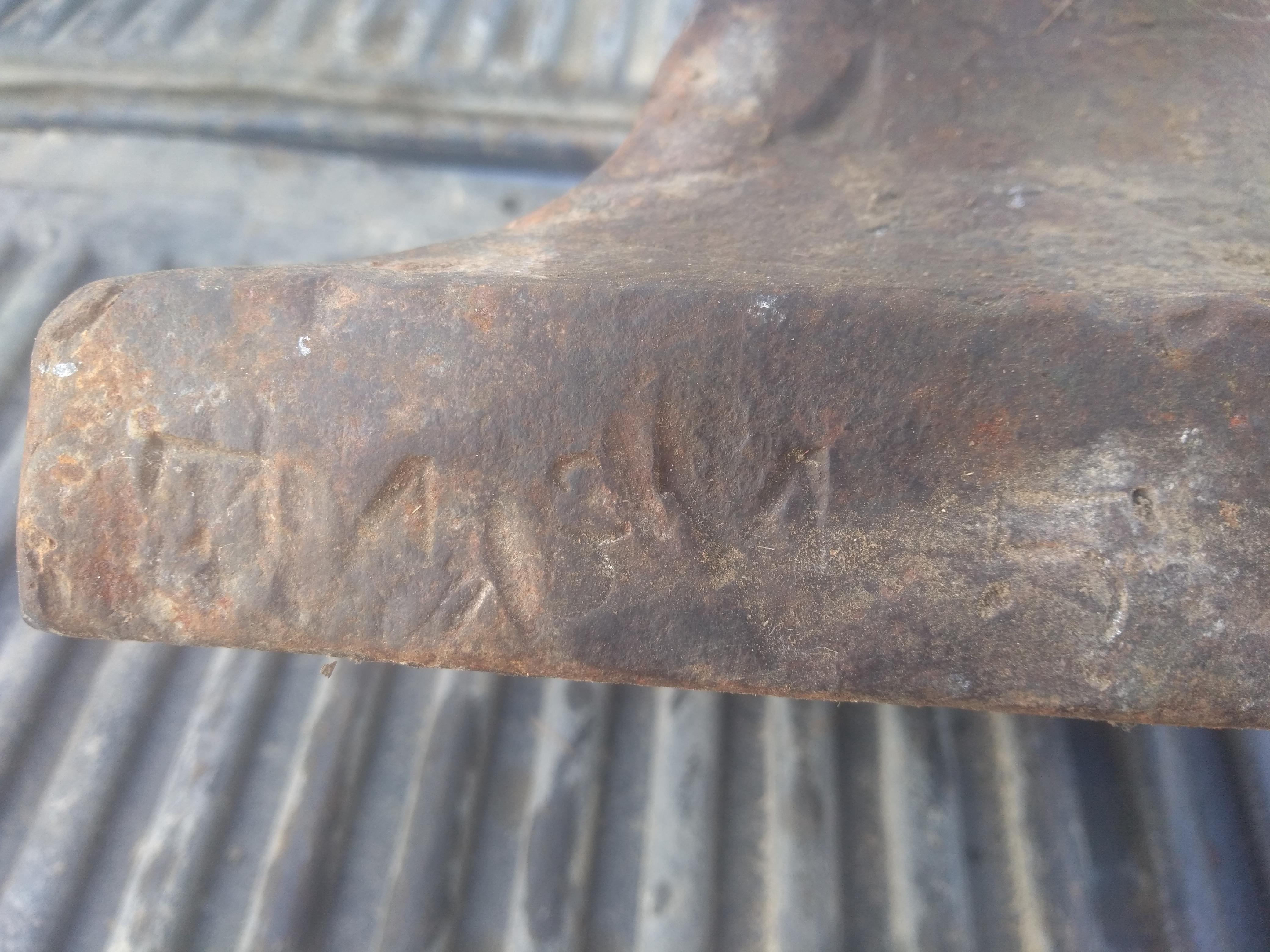

I recently found a Hay budden Anvil, weighed about 150 before the faceplate broke off. Out of interest, I wanted to know the age of it. The serial number is 74345, located on the front of the base, under the horn. I'll try and post a couple pictures here as well. Also, regarding the busted face plate, I plan on forge welding a new hardened steel plate on the top.
Do you have experience forge welding (or even heat-treating) items over 100 lbs? Even the most experienced smiths on here would struggle to accomplish such a task.
I see a very usable anvil that could easily be ruined by a failed attempt at re-faceplating!
I suggest you watch the video of when they did that at SOFA and they took 4 tries and had a team with over 100 years cumulative experience.
If you can find it also look up the videos on "cajun blackened anvil" where a group tried to forge weld on a new face and ended up burning up the body badly.
I have very little experience forge welding, I wanted to get a group of guys together and have a sort of "barn raising" type deal. There is a blacksmith nearby with many years experience. As I'm fairly young and being mostly self-taught/youtube/book/trial and error i wanted to find someone who had more experience.

I have watched every video I could find on the subject. I'm also very fortunate to have more than adequate tools for the job as far as the heavy lifting and fabricating goes. I also have made friends with several old farriers/blacksmiths in the area. I promise I wont ruin the anvil, if the forge welding is not going to work, I have asked my neighbor who is a professional welder if we could weld a hard surface plate on. Even then it would still need to be heat treated.
If I never try something that involves taking risk, how will I learn? The best teacher is failure in my experience. Though I strive for success, failure is always there, waiting for me.

Ayup, and that's good example of how an experienced professional welder ruins a usable anvil.
Clean the base metal and use a quality hard facing filler rod and cap the last 1/2" with a steel on stone hard facing rod. Run FAST low amp beads and you can lay more than two deep but not many.
If you just HAVE to remove the remaining face, mill the foot flat first so the face isn't ground kattywompus. Doing this to it will make pre-heat and post heat less critical but won't make it go away.
Well you were about halfway there: To Add a plate:  Place a piece of sq stock down the middle of the face lengthwise and clamp the preheated plate to it and the anvil leaving two equal slots. Then start welding up one of the slots from the middle out on one side.  When it is good and fixed in place, grind out the piece of sq stock and weld that slot as well till you come to the edges.   Heat treat.
