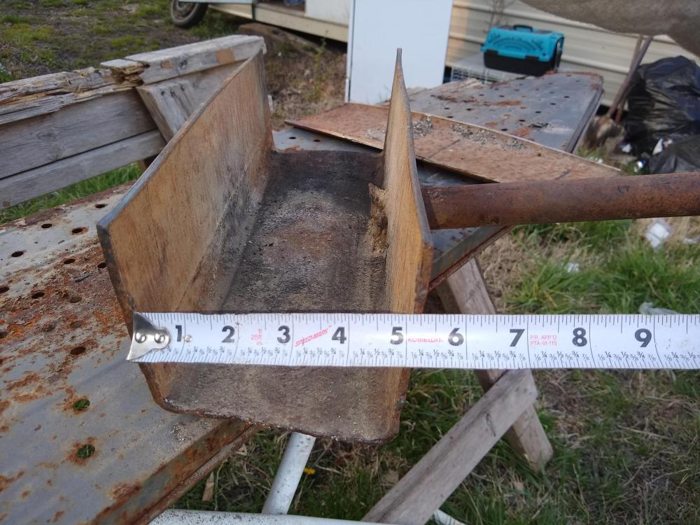

Hey guys I just wanted to show y'all my newest forge I just built and tested. It works pretty good but still needs a few things before it's finished. I built it from a piece of tube iron I cut one side off of and I'm gonna put 2 slits in that side so I can slide it down on one end to keep the fuel source in and will make it adjustable for smaller projects. I may add a spot on top of one of the sides to hold the charcoal before it goes into the fire. I still gotta add legs too and I am gonna add a bleeder valve to make the air flow adjustable with a hole in the side of the tuyere that I can put a slide pipe on to make it more adjustable for my hair dryer. But this really worked well when I tested it. Let me know what you guys think.
I’d worry about the width of the burn pot.  Charcoal fires spread with very little air and you will have a 14” long fire in no time.  That can be extremely useful in some situation but, in most, it is just a waste of fuel.  If you can manage to adjust the width of that trough you would have a very customizable fire pot.  Some steel walls dropped into small brackets at various intervals (at an angle like 45 degrees) would make it really flexible.
Now you have to set it into a table of some sort.
Jay.bro, you are on your way. It looks like you have some warping going on already. Some angle iron along the top will help with that and will work to support it when you get it set in a table. Like Lou said, and I think you are working to that end, control the length. If you are heat treating a Bowie knife or doing long scrolls you are set. Most of the time you won't need that much.

Well I have some clay bricks I plan on cutting at a 45 for the adjusting the fire pot size to accompany the drop down piece that will create a wall on one of the openings I did notice the way it was starting to warp I just used it to forge weld some band saw blades for a project I have so I do plan on addressing that I really fought with this one since I didn't have the right drill bit to cut the tuyere hole so I ended up cold chiseling a lot of it and then forcing the pipe through at the end but it's really solid without even welding it. I really liked my jabod forge and recently built a jabod foundry that is still being modified but I find the designs I used to limit my projects a lot. Oh and I did notice it was very fuel hungry I even considered trying to get some coal for this forge to see if it worked better. Progress on it has slowed due to a dislocated thumb and rain though but I will keep this updated I just never found a thread with a forge like this on here so I figured it might give new members another good direction they could go.
I melt bricks, even fire bricks with my side blast. As you have a welder, why not duplicate my steel side blast fire pot? Esentualy it’s a 7” square cut in the diagonal to form two triangles, connected boy two 7x6” plates to form the sloped sides. I then welded a flange on it and cut a hole in one vertical side for the tuyere. It is 3 1/2” to the top of the ID and at a down work angle.  As I said it melts bricks so I will be cutting some angle to replace the bricks.

You mis my point. Use the box of dirt to experiment with different shapes. I used the JABOD project to see if I understood what I had scrounged up about side blast forges, and then experimented with them. 3 iderations and several modifications later...
mid you take the cut off side and bend it 90 and have a friend weld it in to your trench you will have a much better working set up. The slope helps in clean out and moving fuel down, wile limiting the amount of fuel they is on fire (charcoal is relitivly expensive and unlike coal all of your fuel will be on fire not just the stuff closest to the heat. To deal with portability the JABOD mk III uses dry cat litter as a fill. Sherman’s troops during his march to the see packed their anvils, tools and bellows and left their forge, using cribs (stacks of sticks like Lincoln logs) and packing crates filled with local soil as forges, wile 20’th century military portable forges were metal boxes that held blower, anvil and tools. They were opened up, assembled and filled with local soil. Lots of ways to skin this cat.
Oh okay I think I see what you are saying now out of curiosity would it work if I just welded it at an angle from just in front of the tuyere to the side opposite the tuyere instead of bending it since the pipe is pretty solid already and I suspect it would need to be moved for this modification. I do like that idea and I planned on something similar with the other half but instead of the cutting 1 side off I just am gonna cut down one corner of it and open it up to where the top is straight up and down and the bottom maintains the 90° but that was another project for another time

I use brick on the table (tho I may need to switch to angle iron) to creat a trench or wall as needed. The thing is we still need the debth of fuel underneath the stock, so the trench or fire pot above the table is only 1/2 the picture. I look forward to seeing what you learn.
