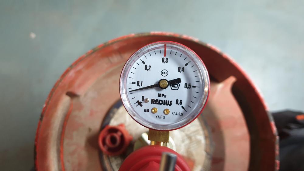

Anyway, at the time of recording I was using 0.1 mpa, which I already thought it was low, as I've seen people being successful being around 0.15mpa

So, I had to look up what an mpa is, not gonna lie. If my conversion-fu is working that works out to about 14 psi.
I am just as new as you are to all this, but, for what it's worth my forge runs happiest at 4 or 5 psi (.027-.033 mpa, again assuming correct conversion) and that's on 2 1/2" burners.
Long story short I suspect your psi may be a touch high, but if I were you I'd wait on one of the old salts here to confirm or deny, please dont change anything just based on my word alone.

Yeah, it's the measurement used o their gauge.
But I can see how that makes some sense as my forge is on the smaller size. I guess I got a bit scared of going lower pressure as there were huge orange flames shooting out, guess I panicked a bit and didn't adjust my choke. Again, more testing needed, just wanted to see if there would be a merciful God who would enlighten me.

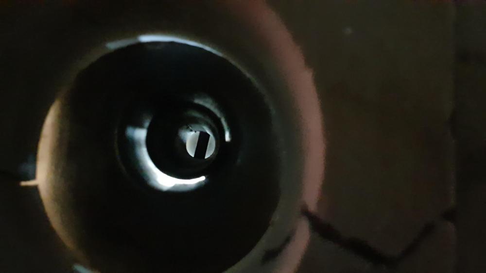

Made the changes, this is what I have, what do you think? Tip still seems to get red hot

The flame appears to be closer to neutral and is shorter. A picture of the choke and a walk to an upside down gauge wasn't helpful. The problem with videos is not being able to take a long look or zoom in to see details.
How far did you back the burner out of the forge? How tight does it fit the hole in the brick? It needs a little space between the flare and forge liner so it can induce a LITTLE additional air. This cools the flare and burns the small amount of unburnt propane in the outer flame sheath. However, it's not uncommon for the outlet end of propane burners to get red hot.
Please take still pics, they provide better information than videos. I can see from the shape and color of the flame you opened the choke and turned down the pressure. A still pic of where the burner enters the forge might be helpful.

That gauge, if it's accurate and my chart is correct (I'm using the same one), converts to 5.8 psi.  Here's a little chart I hope you find useful.  It converts the MPa to psi.  Where the numbers are correspond with the numbers on the dial.  Where there are just dashes, corresponds with the lines between the numbers.  Basically, the last image in the video, of the gauge, shows that you're at about 5.8 psi:

Pulled out the burner to about 7mm in the forge now, and as promised, here's more detailed pictures
That's much better thank you. With the size hole you've drilled in the brick it's more like part of the forge chamber than a burner port. Everything in there is likely to get really hot. The brick is beginning to break up now so you'll need to replace it before long. When you do try drilling it a couple/few mm larger than the burner flare. This will help prevent the burner getting as hot and help refine the flame.

What I'm seeing in this picture is a SLIGHTLY rich flame, maybe open the choke a little more. Start playing with the choke while it's running. When you hit the sweet spot you'll know it, the forge will get HOT. Note the color of the flame it will tell you if it's oxidizing. (running lean) However until you know what that flame looks like you'll need to watch for the other indicator, what happens to steel in the fire. If steel scales IN THE FORGE, the flame is lean, close the choke SLIGHTLY and test a clean piece of steel.

That's what I was thinking after I looked at the picture, the hole is definitely huge and in messing with th whole forge. I'll get to drilling tomorrow, as that needs to be resolved asap
I noticed the flame was rich as well after the picture and did some fiddling with the tuning again. Once the forge was hot i wasn't seeing any orange flames. What's happening now is that the stainless plate is gating red hot, again, due to the huge hole, must fix that.
