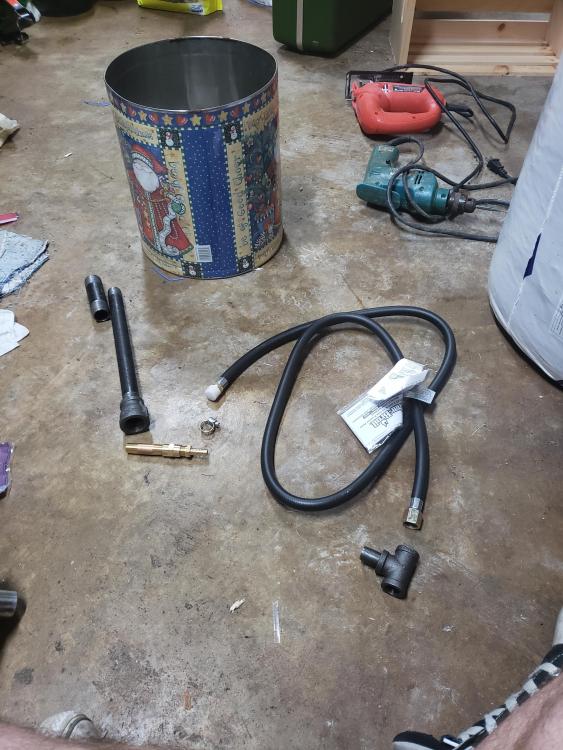

  14. Got one end assembled and about to start drilling holes. This will be my forge body, it's now lined with 2" of ceramic wool I found a local supplier for (atlantech, for those of you who live in MD. They're in Elkridge.) Its rated for 2600 continuous use. My remaining area is an 8" circle 9.5" deep- little smaller than what I wanted but it'll do. Time to go make my mold and pour.

  19. Hey all, I've been referencing this site a lot in recent weeks so I decided to go ahead and post. To get to the point, I'm beginning my forge build this weekend. I put a twist on common designs I saw around and went with two smaller venturi style burners, with the idea of more even heat distribution. I'll put some pics up this weekend if theres any interest. I've got my ceramic wool and my forge body, but I'd really like a cylindrical fire brick to help this heat distribution along more. Does anyone know where to get one, or have any input on making my own? I've seen about as many recipes for fire brick as there are members on this site. Aside from that, any input or anything you guys learned the hard way, I'd love the advice. Learning all this on my own. For the record I'm looking for my final size of heated area to be a 6" diameter cylinder, probably 18-24" long. I know that's a wide range but I can adjust as needed.
