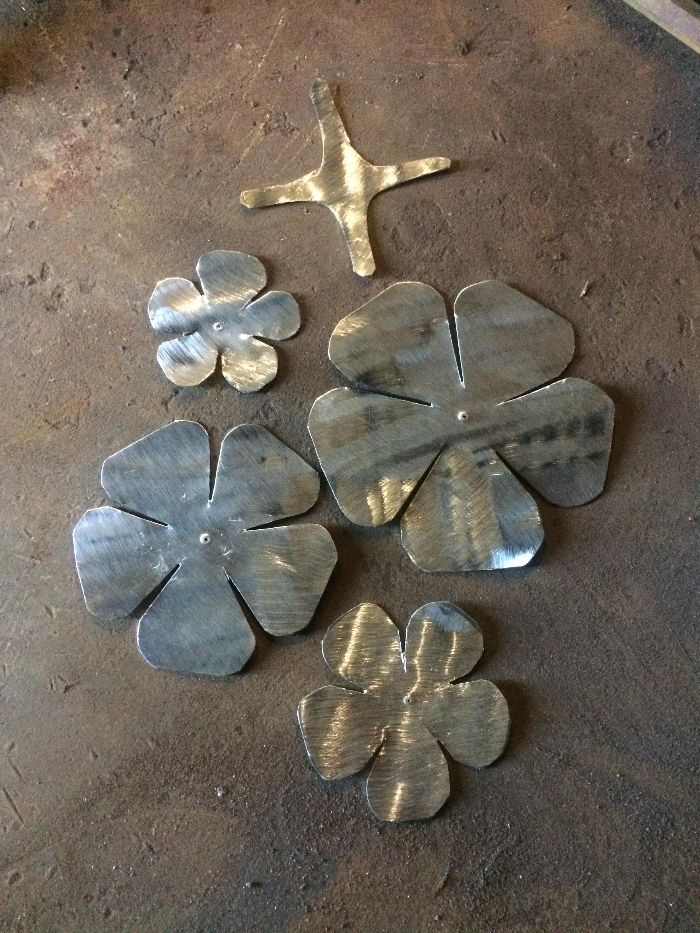

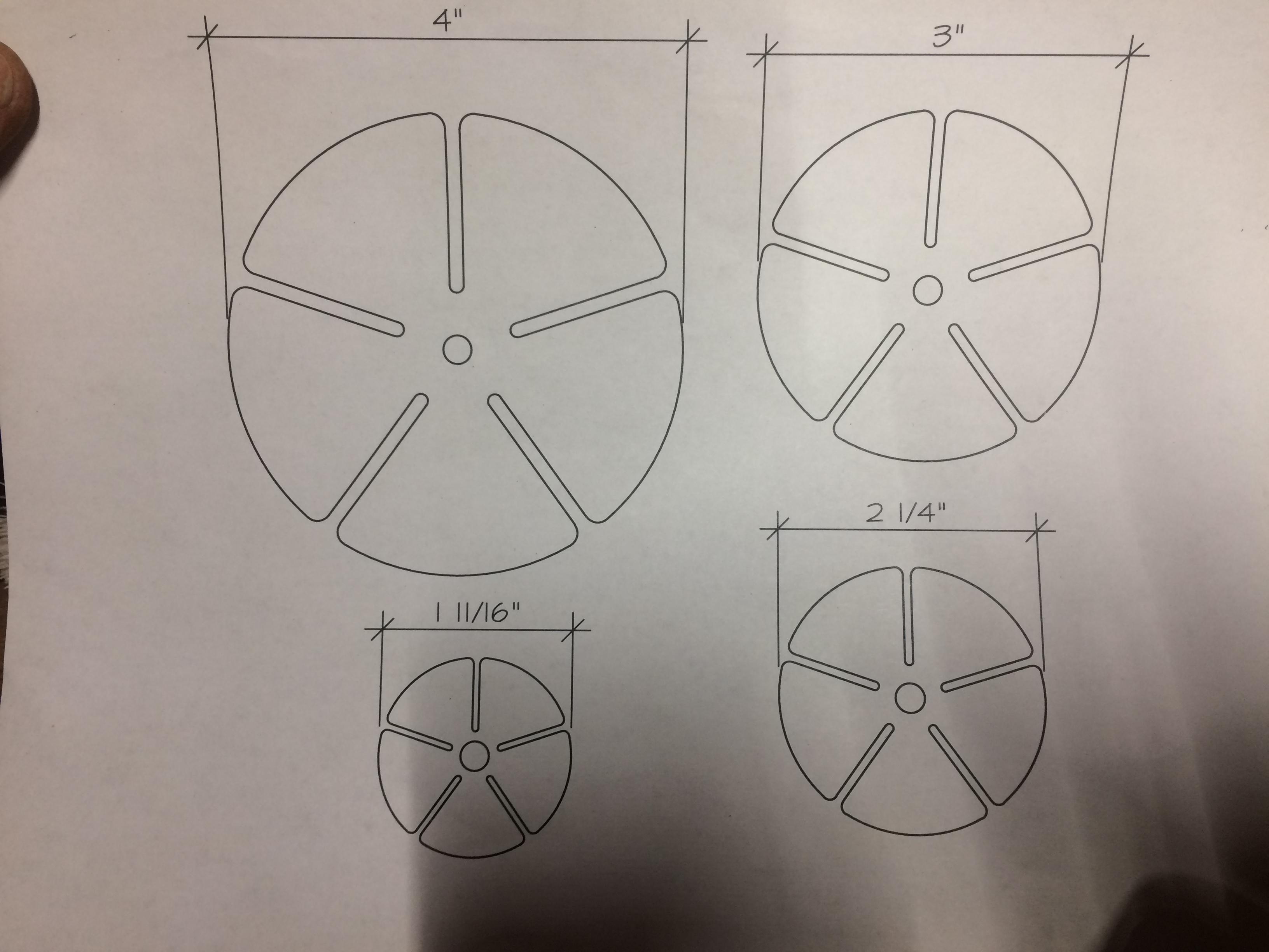

January 29, 20197 yr Like Das said, 4 discs (or 3 will do for a start) cut from mild steel. (Suggest you avoid stainless until you've had some practice). Make the discs progressively smaller - eg 100mm, 80mm, 60mm 40mm etc, but the sizes are arbitrary. Drill a 6mm hole in the centre and cut towards that centre hole to make 5 petals. (72 degrees if you want to be precise, but it's OK if they are not perfectly equal). It's handy to make a plastic template for this if you intend doing a few. Round off the corners of the petals a bit to make them easier to overlap. I usually put the blanks into the forge to a dull red and texture the petals. Be careful - it's thin metal and easily burnt. For the stem I use 6mm round bar, textured, or at least with the smoothness taken off. I weld a stop about 15mm down from the top of the stem. Put the sepal star-shaped disc on and then slip the petals discs on that, large one first of course. I then get the whole thing to an orange heat in the forge and peen down the top of the stem to grab the petals tightly. Then bend each hot petal upwards and overlap them. Needle nose pliers are useful to bend the lips of the petals over. Sometimes you have to repunch the centre if things become loose. Forge a few leaves with serrated edges and you're done. Thorns (pointing downward) look good, but I have never done any of those. A brush with brass can look good, or finish as you desire. Heat colours are nice too. I guess there are lots of ways of forging roses , but that's my take on it.

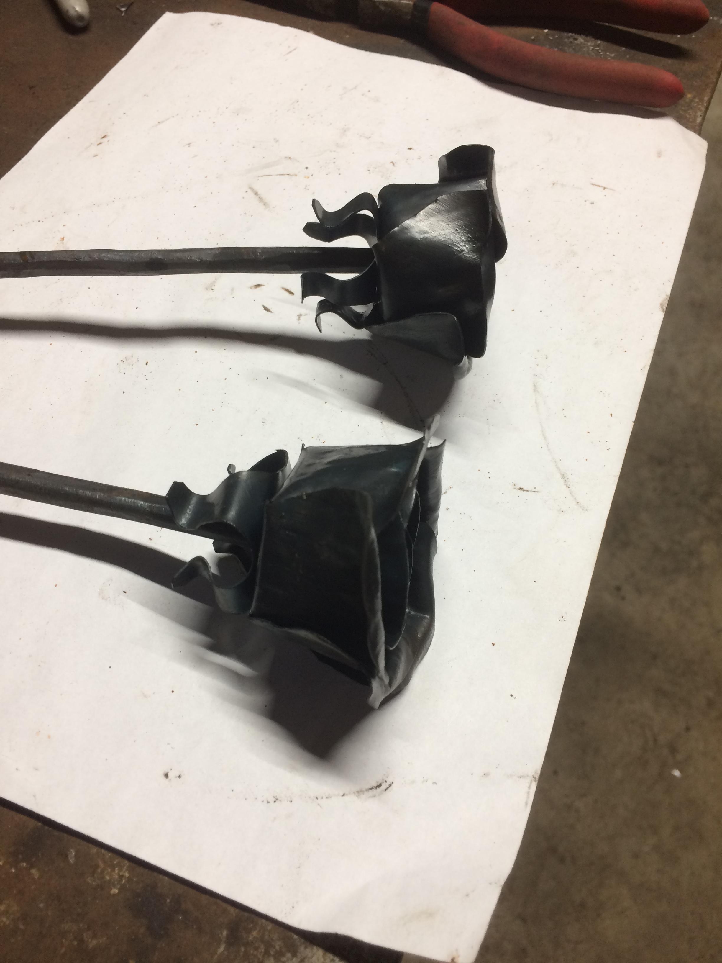

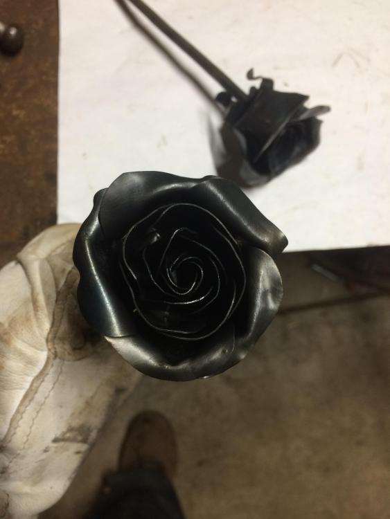

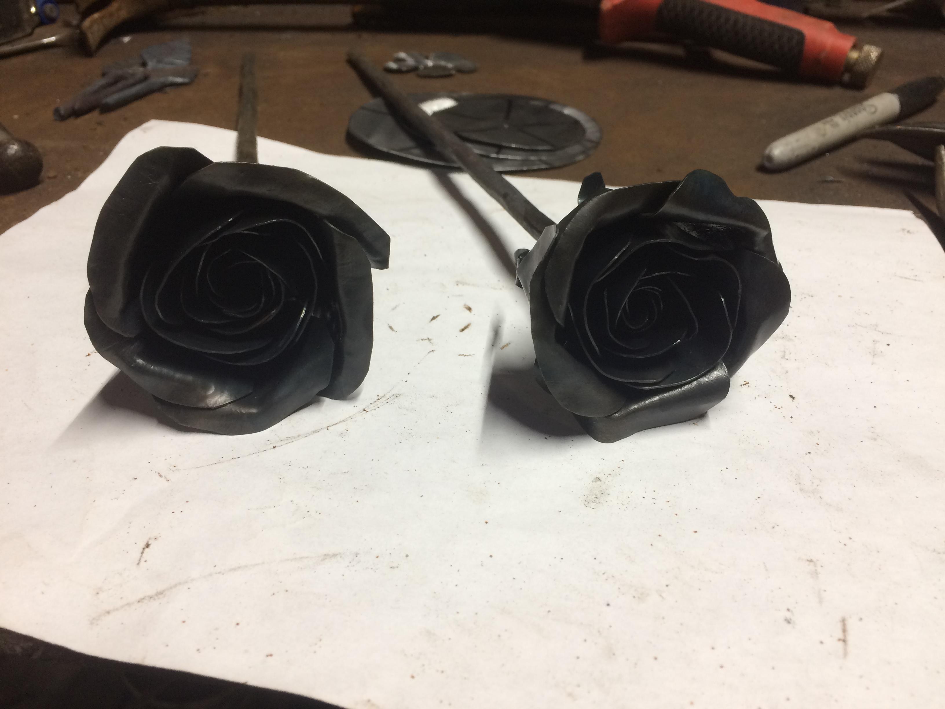

February 11, 20197 yr Author So I figured I would update this with what I ended up with for my first rose, well actually my first 2. It turned out to be quite a bit easier then I was anticipating. So this is what I made I’m fairly happy with them. I still need to add some thorns and the leaves. I have the pieces cut out and am going to make a couple more with more of an open layout. Justbtobhelp amyone else our that may be looking, I essentially used ausfire’s dimensions which are below.

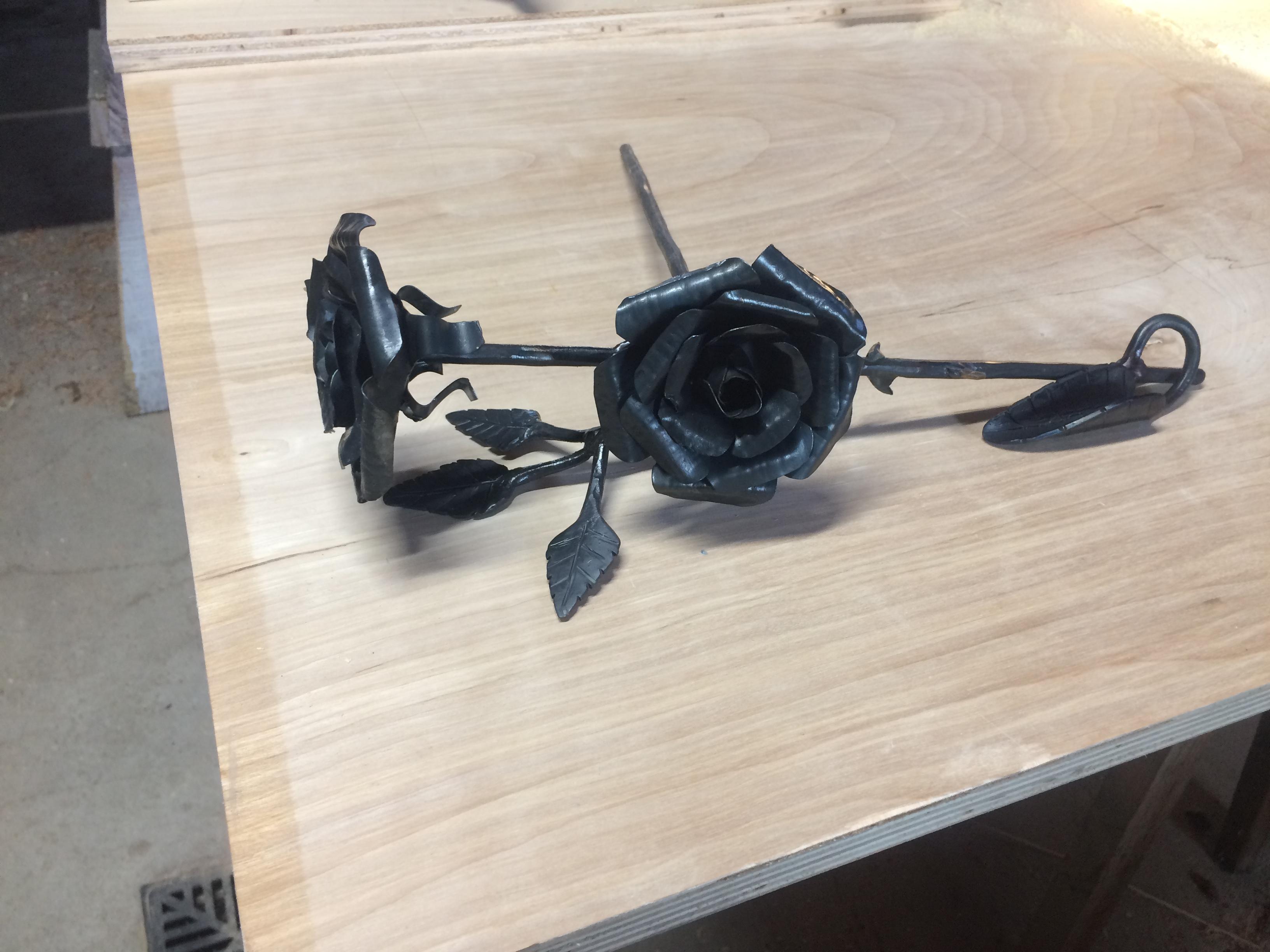

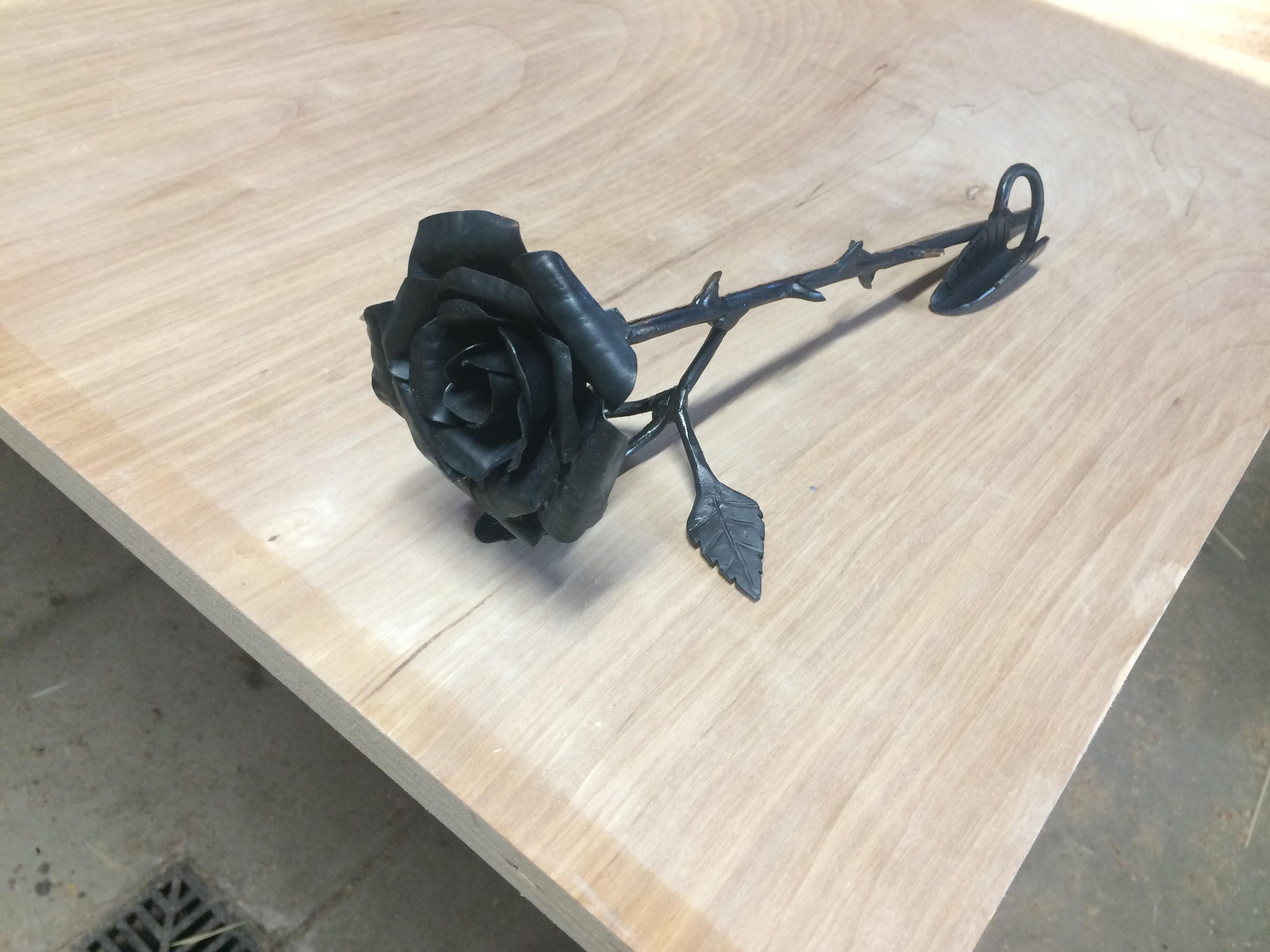

February 21, 20197 yr Nice tdriack. I've been using a flat engine or exhause clearcoat that can be found at autoparts stores. It leaves the metal look but also protects it. You could use a wax as well. My early ones I made, I used the beeswax/BLO,/turpentine mix on. But for sculptures and especially with harder to get to areas I've been using the flat clearcoat with success. The exhaust and engine clear is more pricy but its worth it to me being more durable. On 2/10/2019 at 8:52 PM, Fowllife said: I still need to add some thorns and the leaves. Fowllife, Ever get pictures with the leaves and thorns on? They look nice. Way better than my firsts.

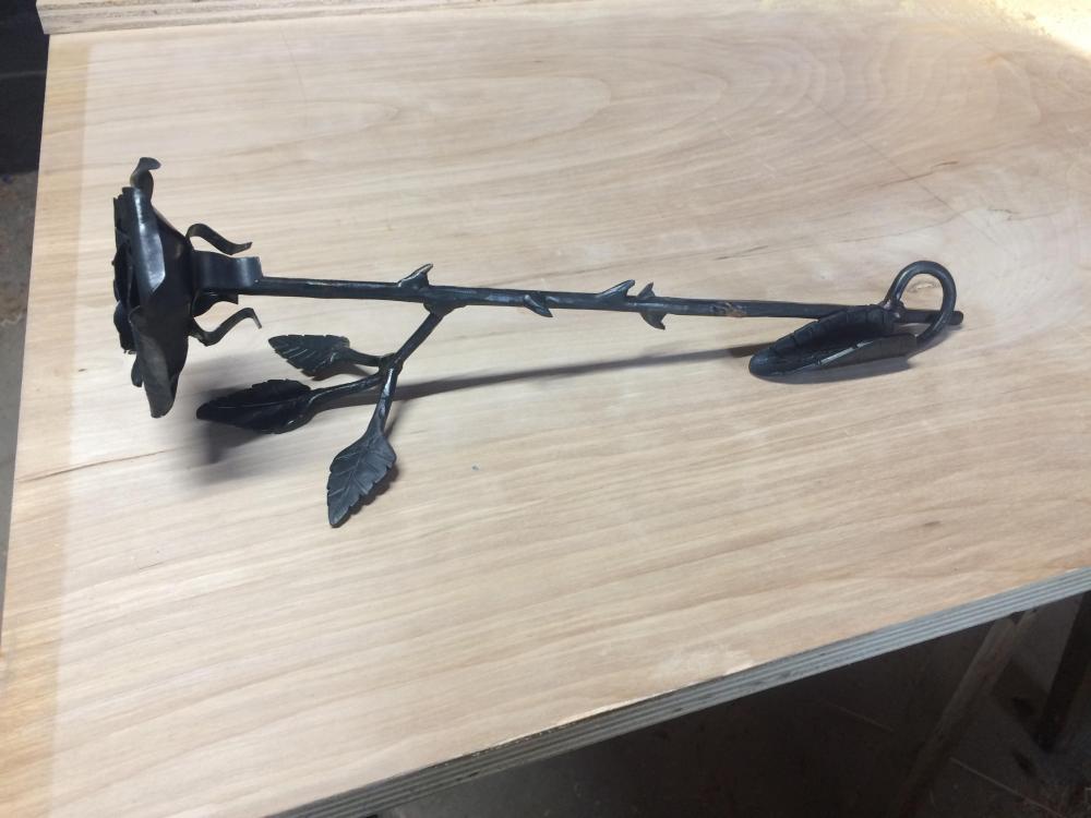

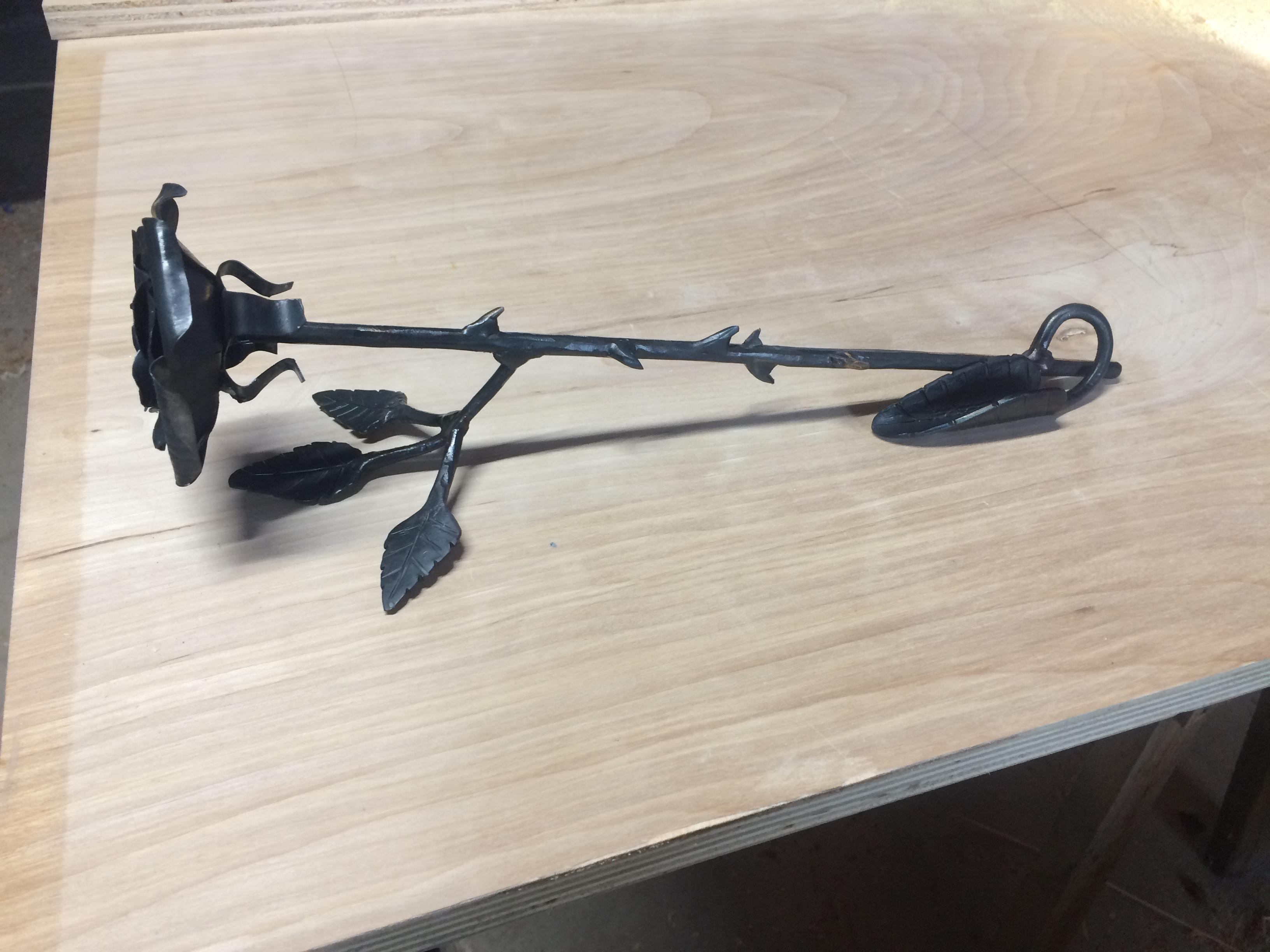

February 21, 20197 yr Author Nice sculpture tdriack Sorry Daswulf, your right I should have posted finished photos. I liked the more open face better so that is the one I ran with. I ended up giving one of the “practice” ones to my buddy to that was over helping cut some fire wood so he could give to his wife. I got them hot and finished them all with beeswax. I only ended up detailing the stems on the “good” one that I gave to the wife. It ended up being turned into a business card holder for her desk at work. I’m not a huge fan of the transition on the end for the leaf card holder, but it’s what I came up with with limited time. I still need to refine my leaf making, I’ve probably made less then a dozen so far. The stems are out of 1/4” square stock, small leaves out of 1/2” round, and the larger leaf card holder out of 1/4” plate. I use what I have.
February 21, 20197 yr Turned out great Fowllife! Good job on the business card holder idea too. It'll be good advertizing for you as well since I'm sure people will comment and ask about it. You'll be making more leaves in no time.
