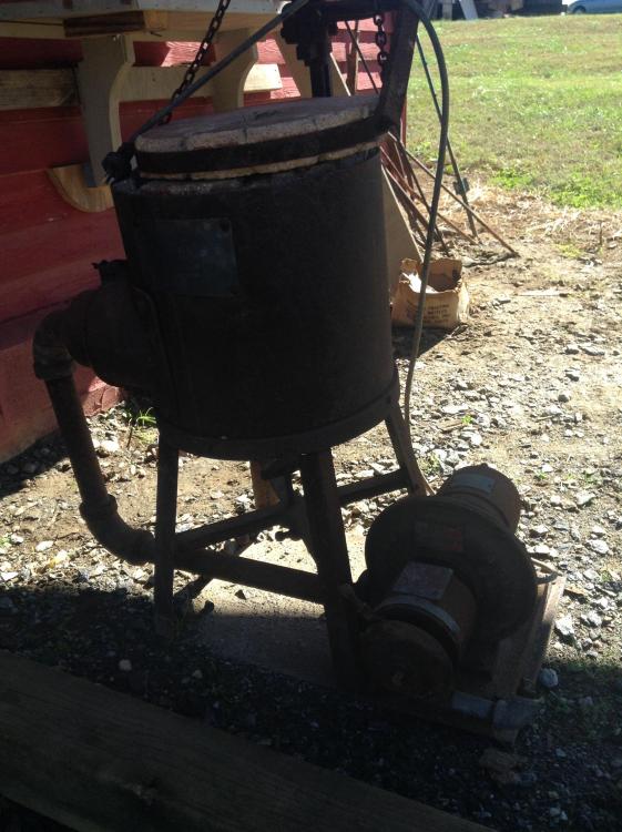

Does anyone know anything about Maxon Premix Burners? Someone gave me this and they said it's a gas forge. I have no use for it so I'm planning to sell. Any idea how much it's worth? It does get power it's just too rusty to work.

Less a forge and more some sort of crucible furnace would be my guess. I'm not a casting guy, though, so that's as far as I'm willing to speculate.

Crucible Furnace for foundry work; not blacksmithing.

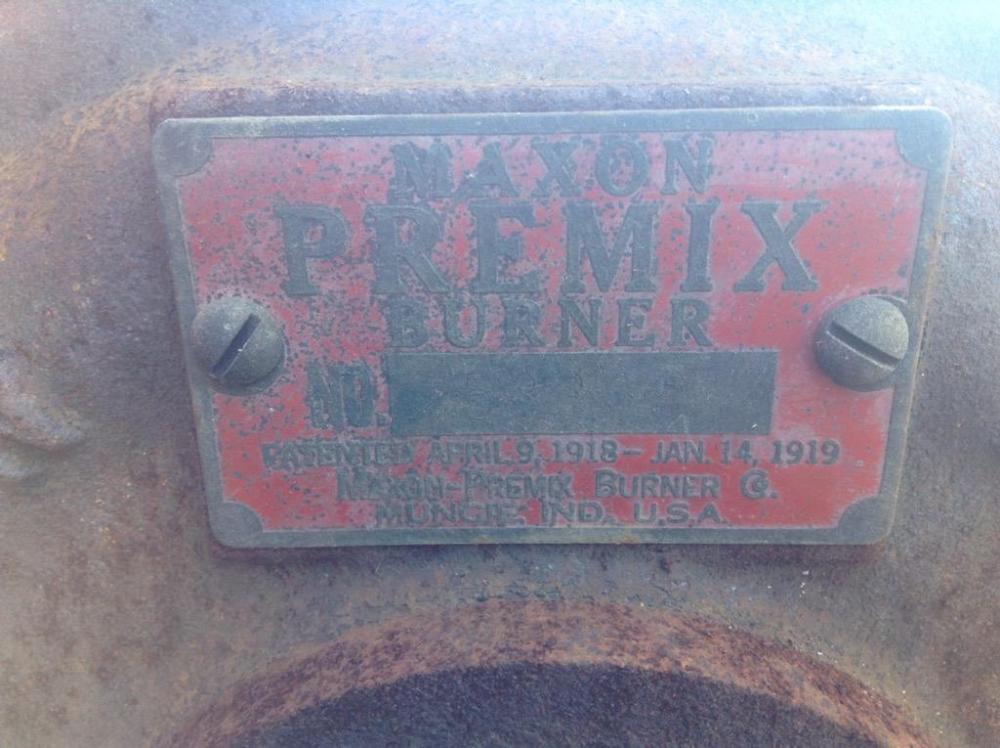

I'm in North Carolina. One of the plates is hard to read but it says: 2073
MFD. by Maxon Premix Burner Co. Muncie, Indiana USA
here's some pics

Looks like a tangential-entry burner, which I think could create a swirled flame around a crucible lowered into the furnace. Hard to say about value and condition. Shipping would make it cost prohibitive for me, but someone might be interested in it as a rebuild project. Good luck with the sale.

The motorized blower with built-in rheostat is pretty cool. If that still works, you might find a buyer for that by itself, especially one who might like it for use in a solid-fuel forge.
