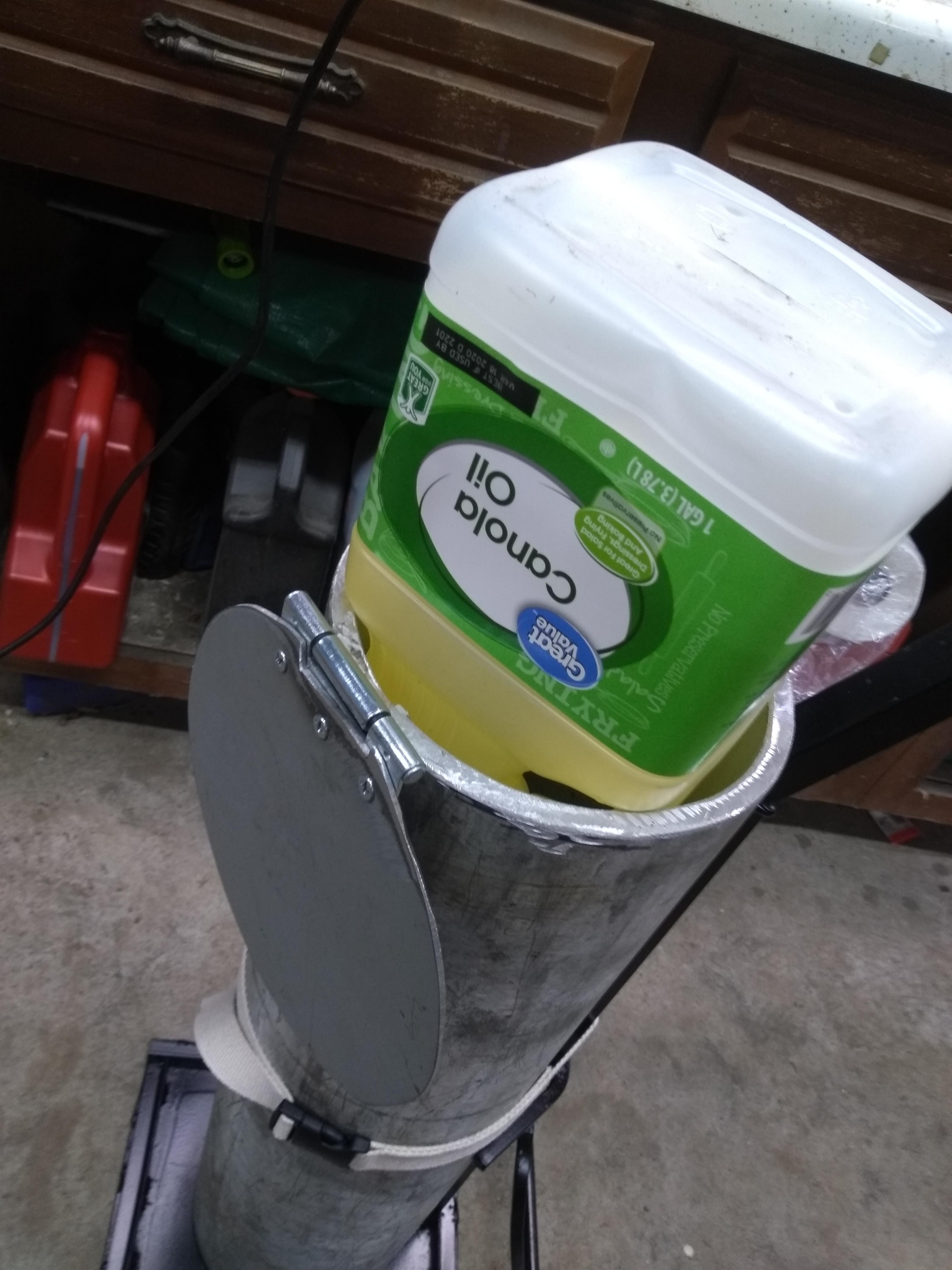

It is a retired oxy tank.  29 inches tall.  I needed a base for it to make it stable.  Job done.  Also decided to make it somewhat mobile.  the flame lid is easily flipped closed with tongs.  with 3 gallons of oil in it.   I hope there is enough room to contain any splashage that might occur.  All scrap or items in my collection waiting for a use.

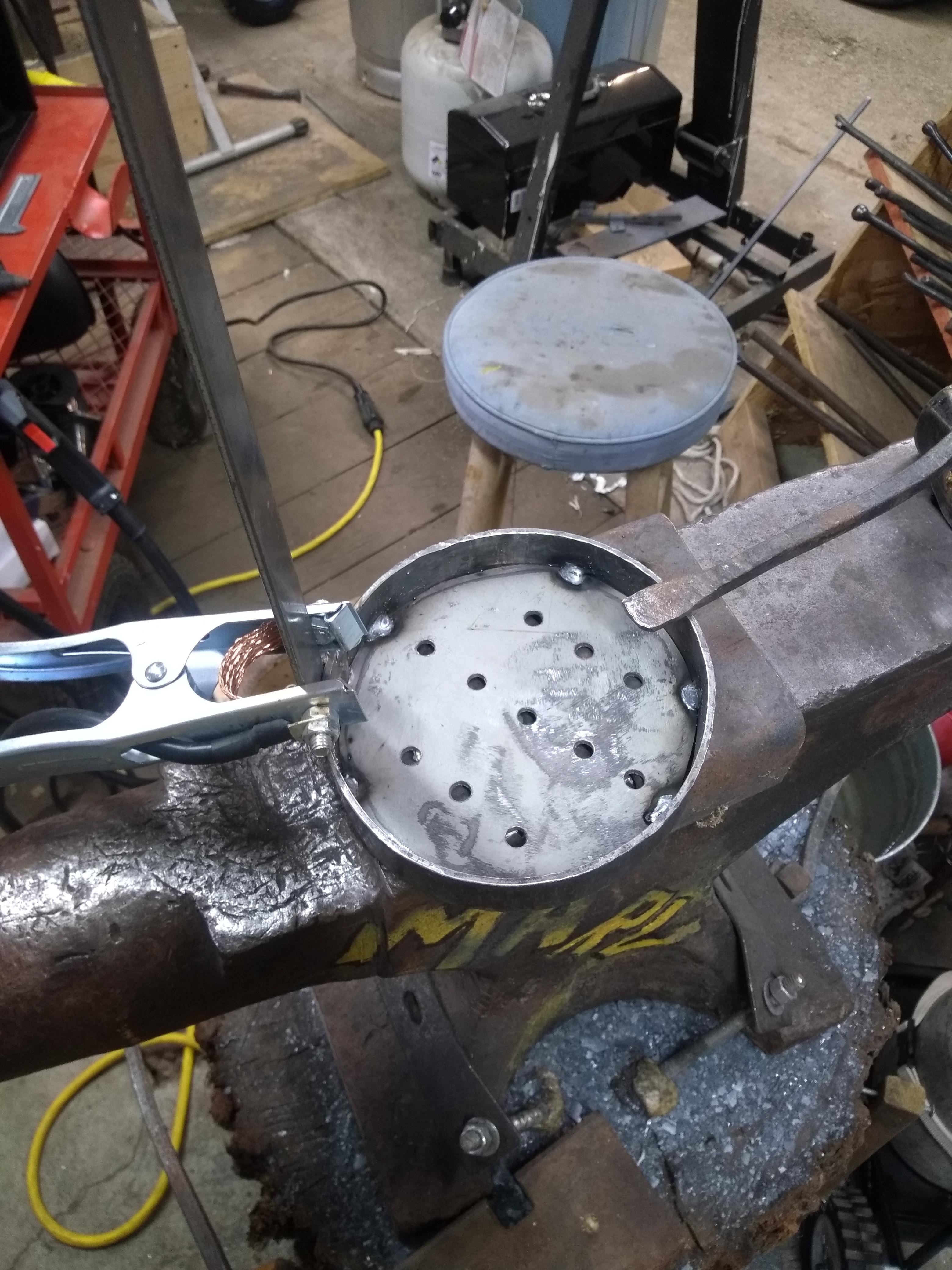

That container could weigh as much as 40 pounds full, with the center of gravity 15 inches or more from the floor. To keep it from tipping over, or being bumped over, make a wide stable base with wheels.  This will allow it to be easily moved out of the way when not in use. Chain it to a wall like you would a oxygen tank for added protection. 3 gallons of oil can make a real mess if spilled on the shop floor. (grin).
A trivet type screen at the bottom of the tank with a handle to raise it up when needed will come in handy.

Glenn.  Appreciate the advice.  I've just come in from the shop.  I tilted the tank over until I could feel it was about to go on it's own.  It took abut 35 degrees to get it to start to go.  It seems pretty stable to me.  believe me, I don't want 3 gallons of oil on the floor.  I've had half a quart and that looked like a gallon while cleaning it up.   I like the idea of a foot strainer or basket  in the bottom of the tank with a handle.   I have decided to put another strap on it and some two stops on the base up tight against the tank to lock it into one spot.

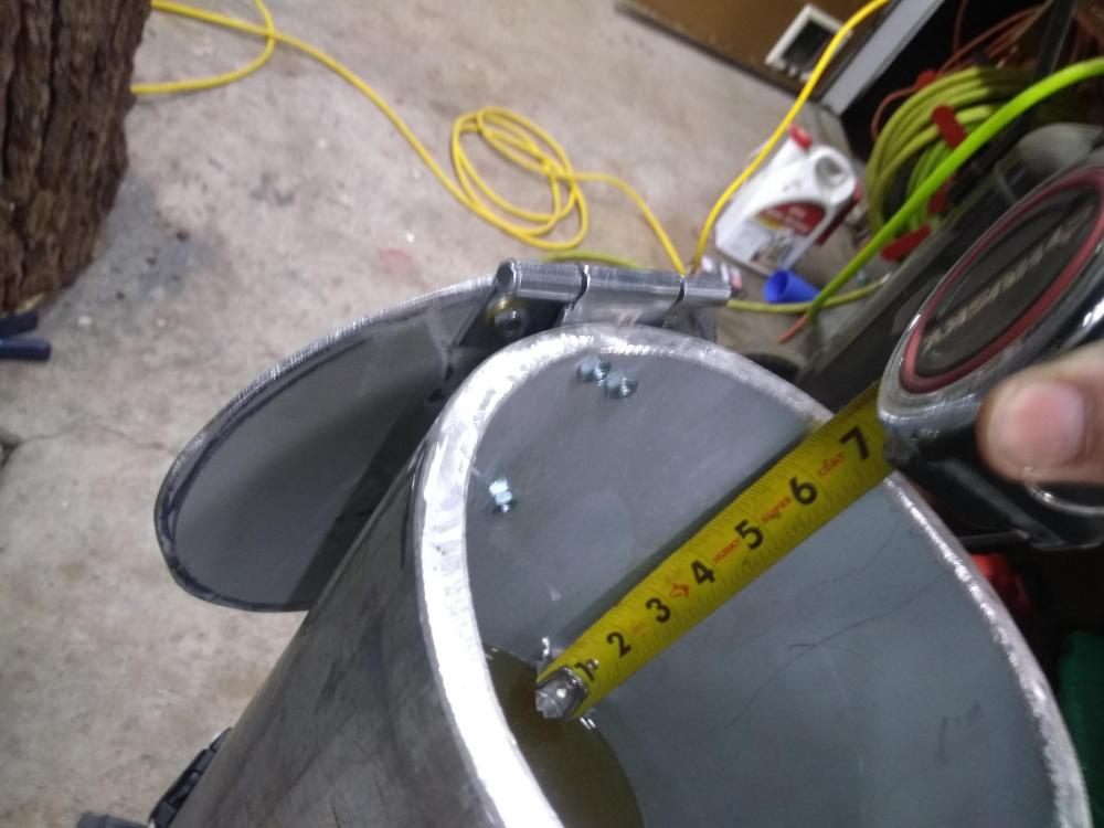

Thomas.  I hadn't worked out the details for heating the oil,  but something along those lines was what I was thinking.    For my tank,  I had initially planned on using a 3 inch pipe with a rail plate for a foot.  but when I did the math and the urging of a few smiths, I realized It really was only going to hold a little over a half gallon and I knew that would not be enough.
I realize that by keeping the level 7 inches below the top, I will have to be close to directly above the flame area if not right above it, so a big glove will be critical for the quench.

thought I was finished but I guess I'm not.  Glenn,  took your advice on the foot strainer.
