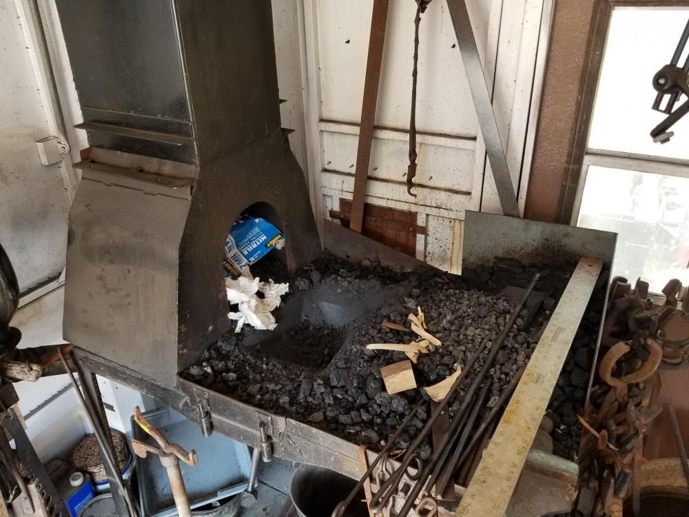

Ok, so I was able to take pics without forgetting.
I have used all sorts of forges, different sizes, different shapes, different blower, hand, electric, charcoal, coke, coal..   This style is for me the most useful..
With that said.. I like a larger forge bed/body and this was the size I came up with for use in the demo trailer as the smallest size that I could use without getting frustrated each time I use it..
the length includes the hood.. Take off 13" for the stack base if you will be using a free standing unit..  This stack sits on the forge deck..
