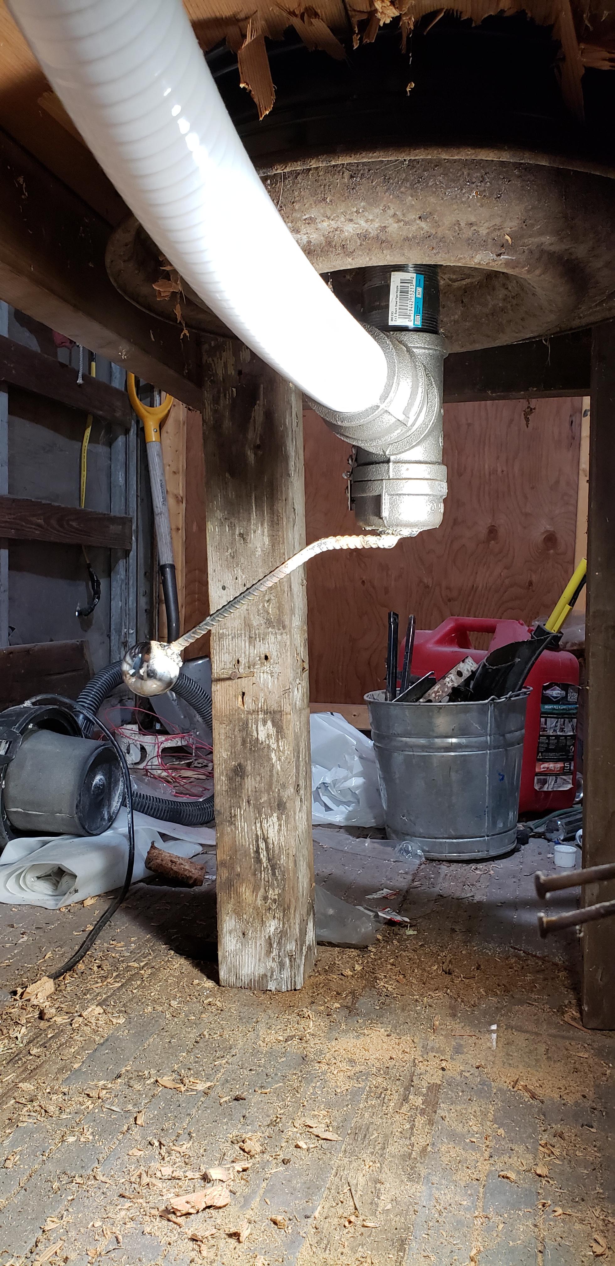

  8. I didn't have bar oil so I shot for att fluid. Now it just hums beautifully. Still sideways tho. Lol, I'm not sure where to put it vertically.

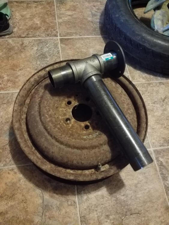

  10. I did not think about a brake drum!! Although, I had the rim available. I dont have a larger brake drum available. Thank you guys soo much this helps alot. Glad I came here! I did post an issue I was having with the blower so far this is where I am with the forge... I'm looking into making it into a side blast now lol

  13. I'm looking at jlpservices pics like, ooo look at those tongs wonder what they are for, ooo! Look at that one what's that!? oh hey!! Lol Haha sorry I'm new!
  14. This will probably be a wood forge.
