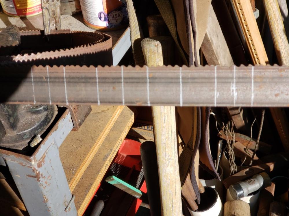

Anachronist58 Posted August 19, 2019 Author Share Posted August 19, 2019 Thanks, Jennifer, the possibilities are endless, really. I am one of those who has not yet divined a hypothesis for your wrought iron comment. but I hope to come up with something before you share that nugget. That 15º angle is the result of me running past the 40 grit belt over the course of two hours, grind and set aside to cool, repeat. Had I stayed on it, with quenching, I would have been closer to my goal. Way steeper than I had intended. Ideally, I would want to be around 7º ±2º. I think that I have use of 50% -75% of the machine's capacity right now, as it is strapped to a 75# industrial wagon, who wants to rotate. I am eager to get the thing mounted onto the ~600# Walker-Turner drill press table. Till then, I must confess that I might as well be just goofing off (sort of). Link to comment Share on other sites More sharing options...

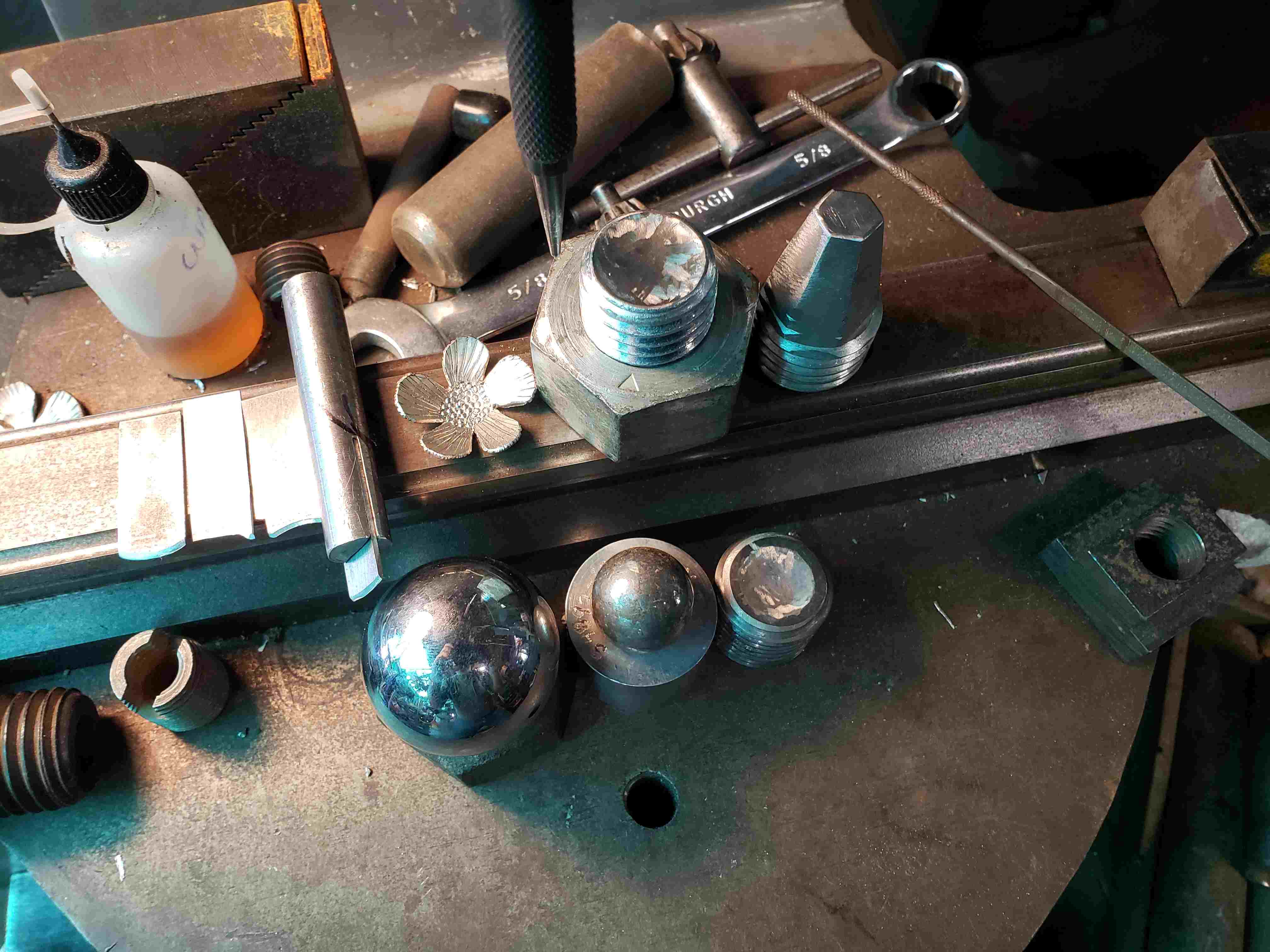

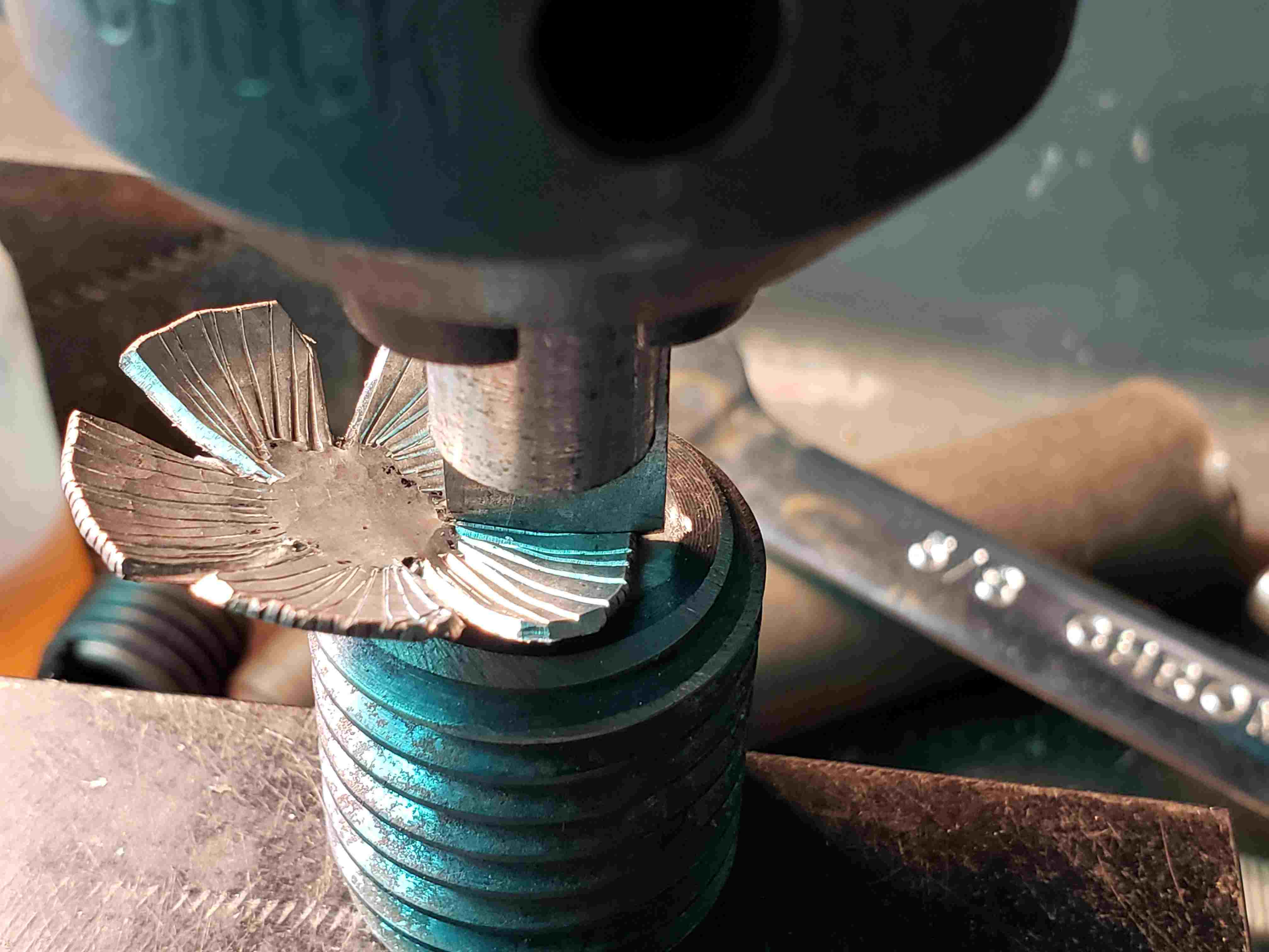

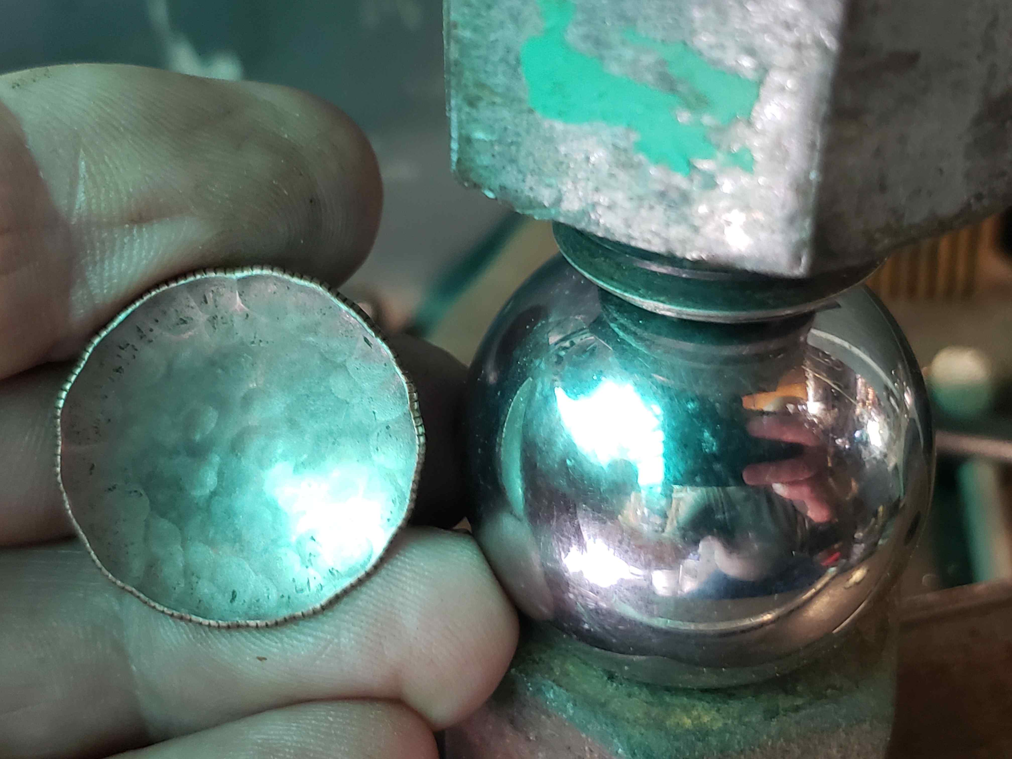

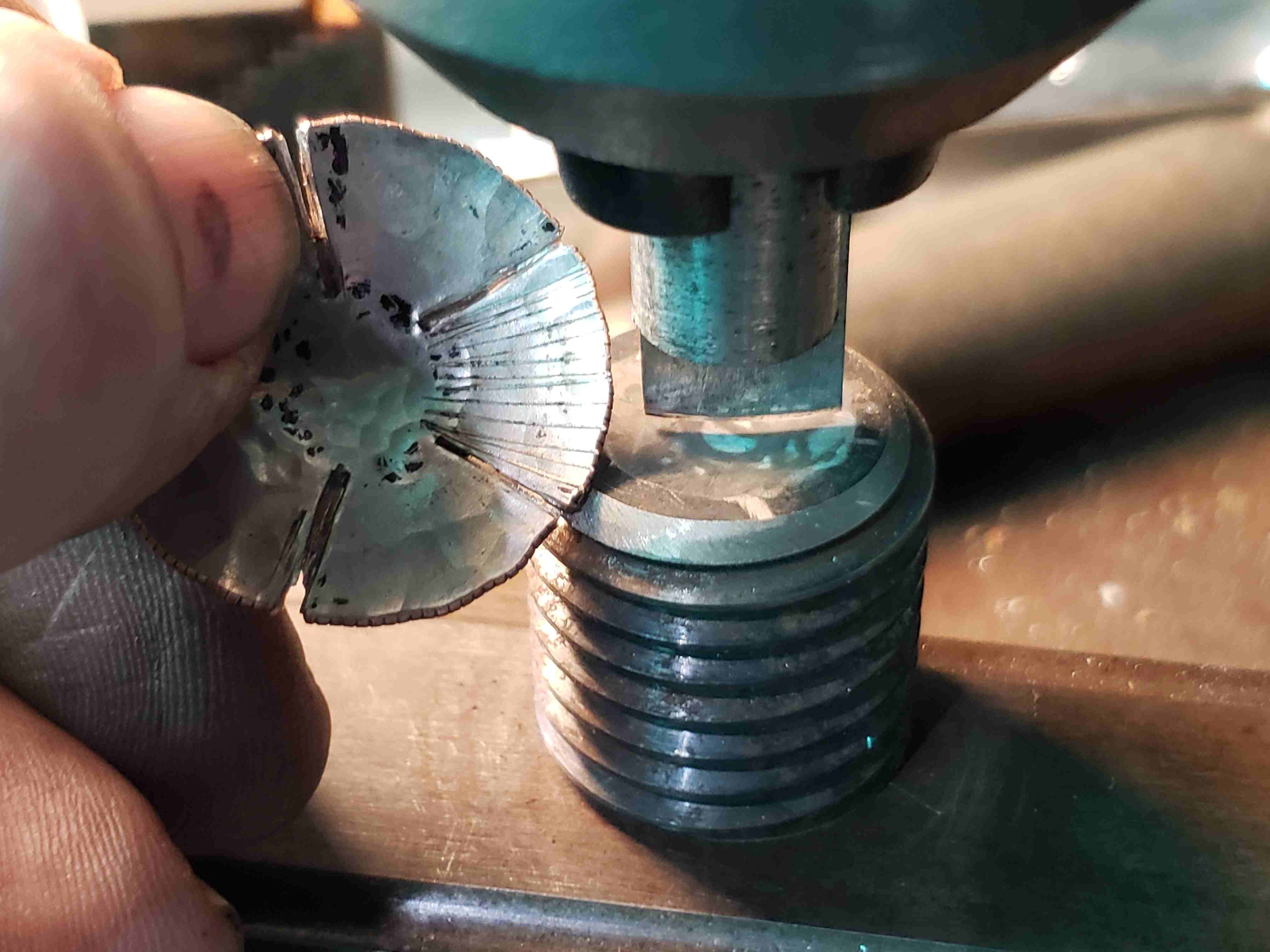

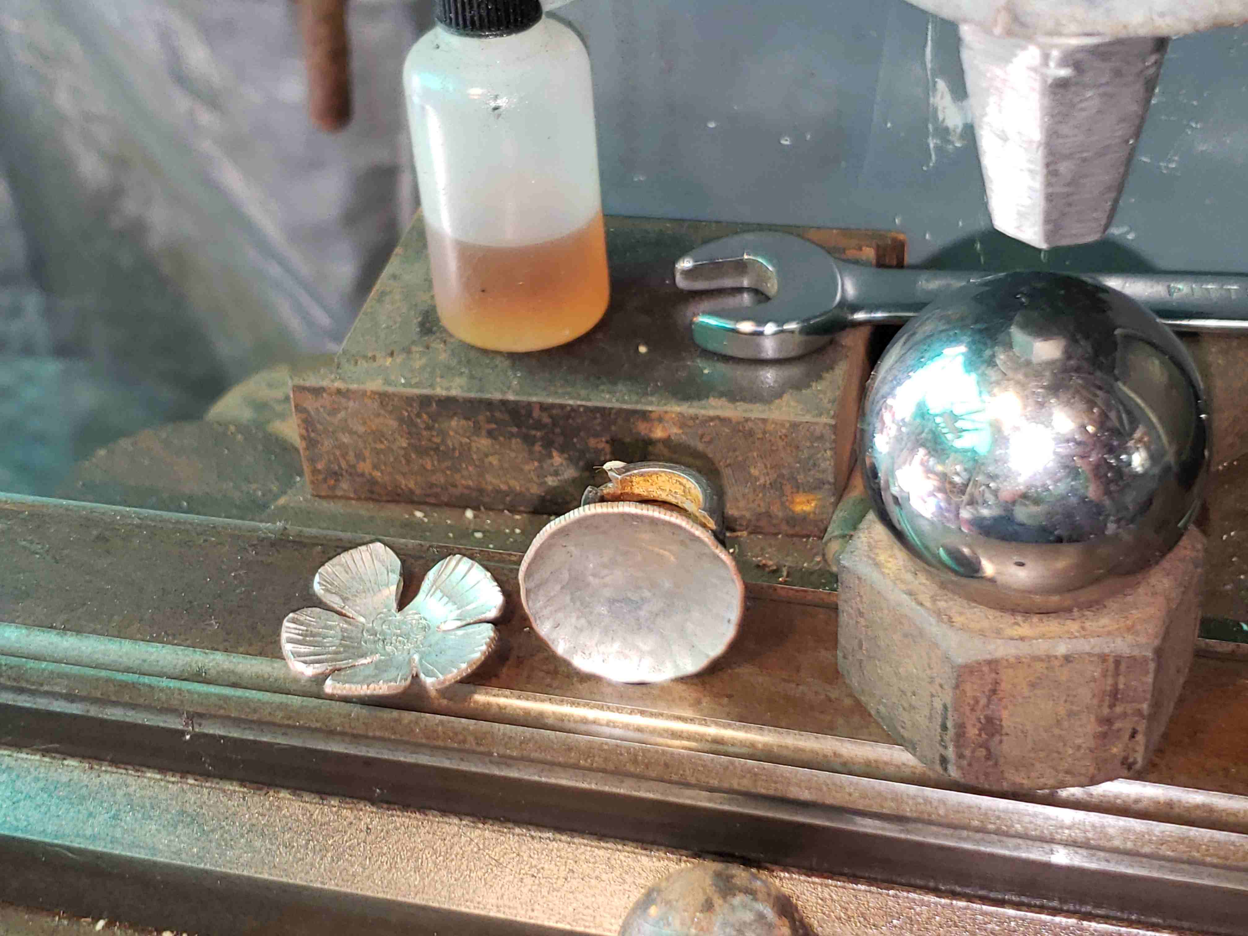

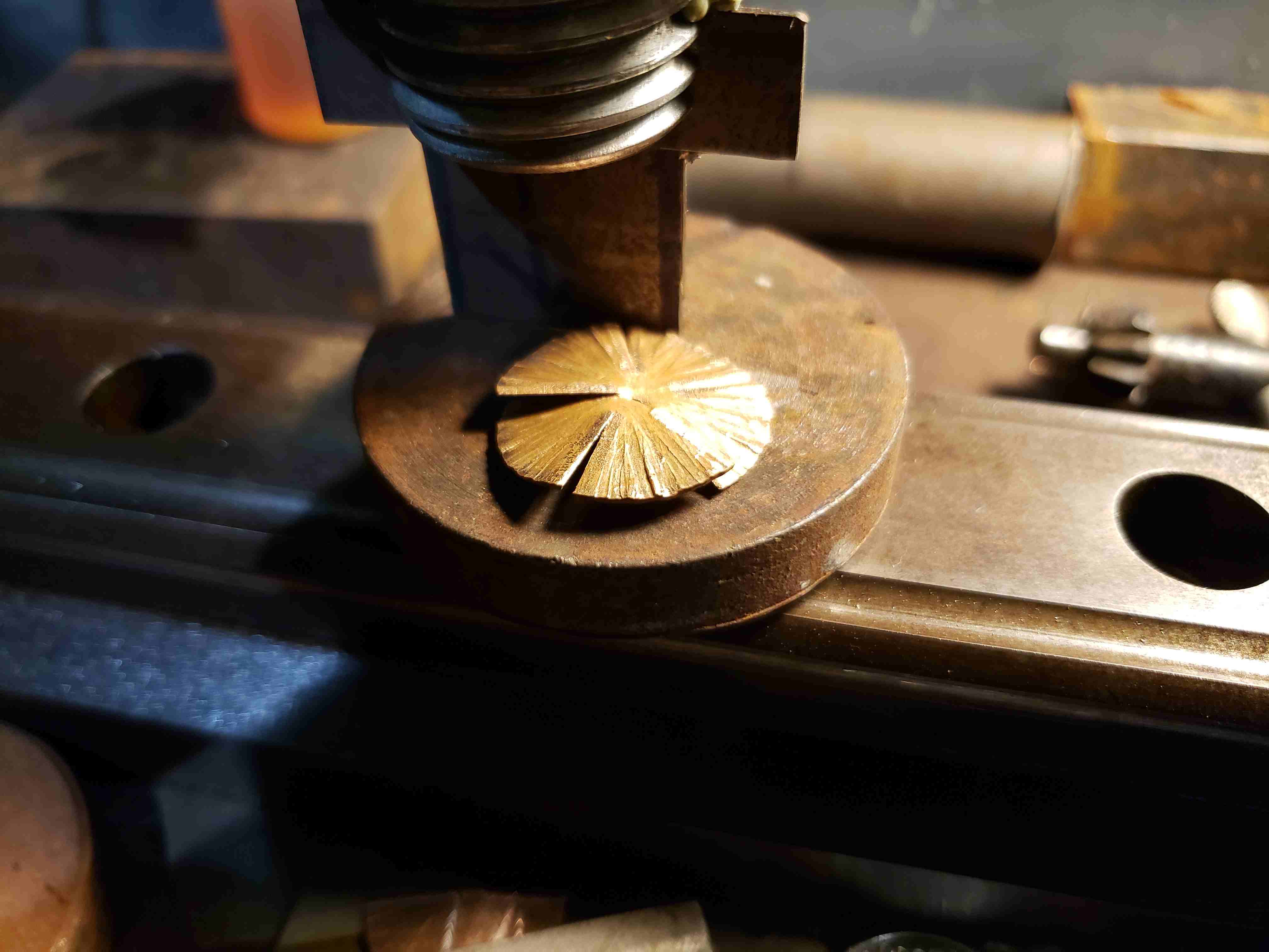

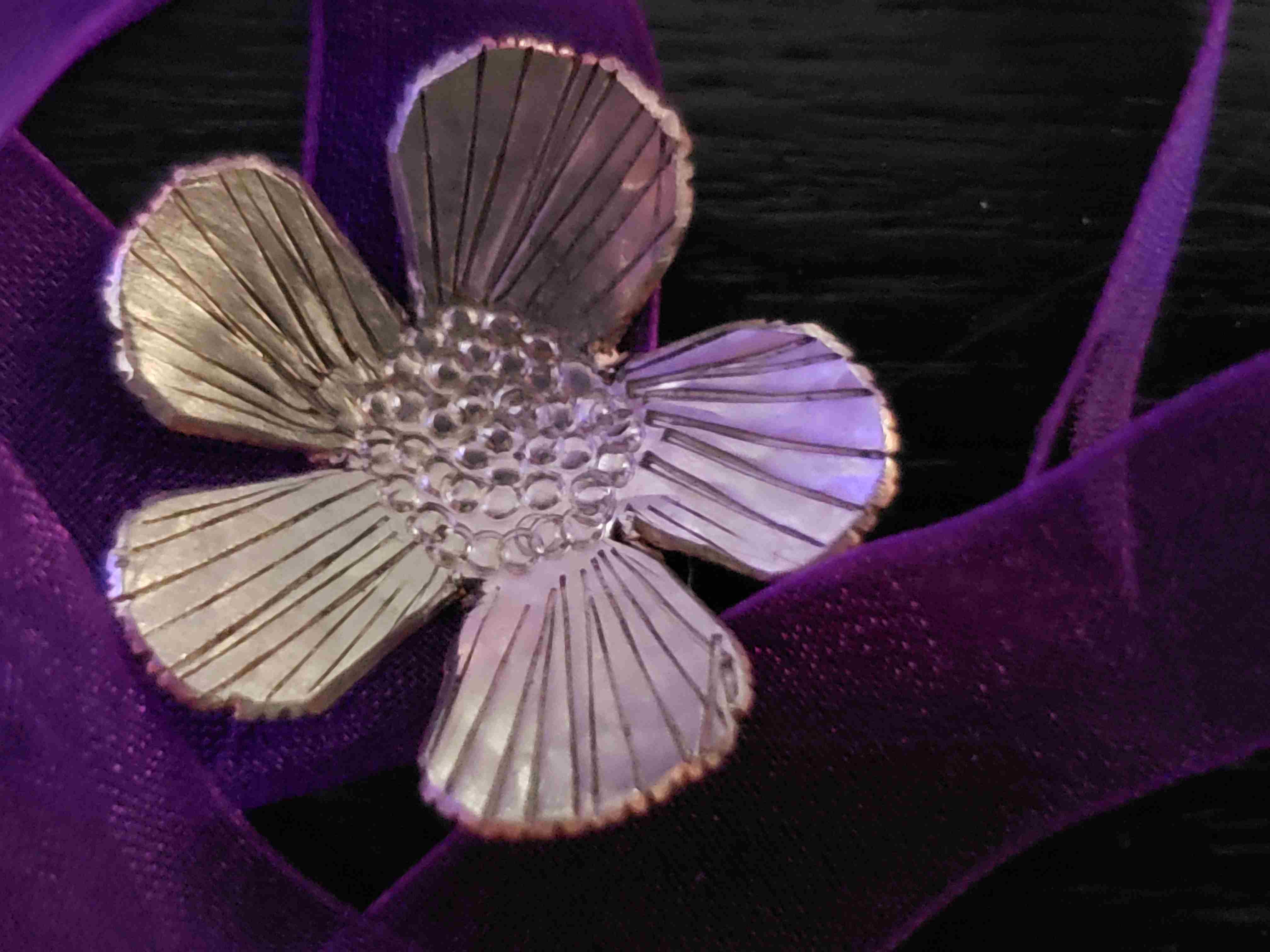

Anachronist58 Posted April 11, 2021 Author Share Posted April 11, 2021 (edited) Quite a bit has happened to the flypress since my last post. Here is a two-bit flower that I roughed out with one of my newest dies: The picture with the copper disk was a test cut. Next die will be a single bevel, to make for cleaner lines. This test has inspired the design of the next iteration of dies for this product. Robert Taylor Edited April 11, 2021 by Anachronist58 Post Assembly Link to comment Share on other sites More sharing options...
Scott NC Posted April 12, 2021 Share Posted April 12, 2021 Very nice. More please. My grandpa was a tool and die man. I find it facinating, but never had the time or brain power to pursue it! I am of the artistic bent.... Link to comment Share on other sites More sharing options...
ThomasPowers Posted April 13, 2021 Share Posted April 13, 2021 I liked the step where it looked like gingko leaves. I enjoy finding/using improvised tooling for my screw press; it's just a #2---stands 7' tall and the toroid is over 200 pounds (Every company had their own numbering system...) I've found the dome headed RR bolts and spherical trailer hitch balls that both fit in my tool holder work well as well as the replaceable ends of rock drills that make a good sized " + ". I also use it with my dishing forms and my latest a charcoal strainer that fits on top a 5 gallon steel bucket, made from expanded metal, was done using a large bearing race outer ring and a section of 8" steel round. My hot cuts, punches and drifts get a work out too. Link to comment Share on other sites More sharing options...

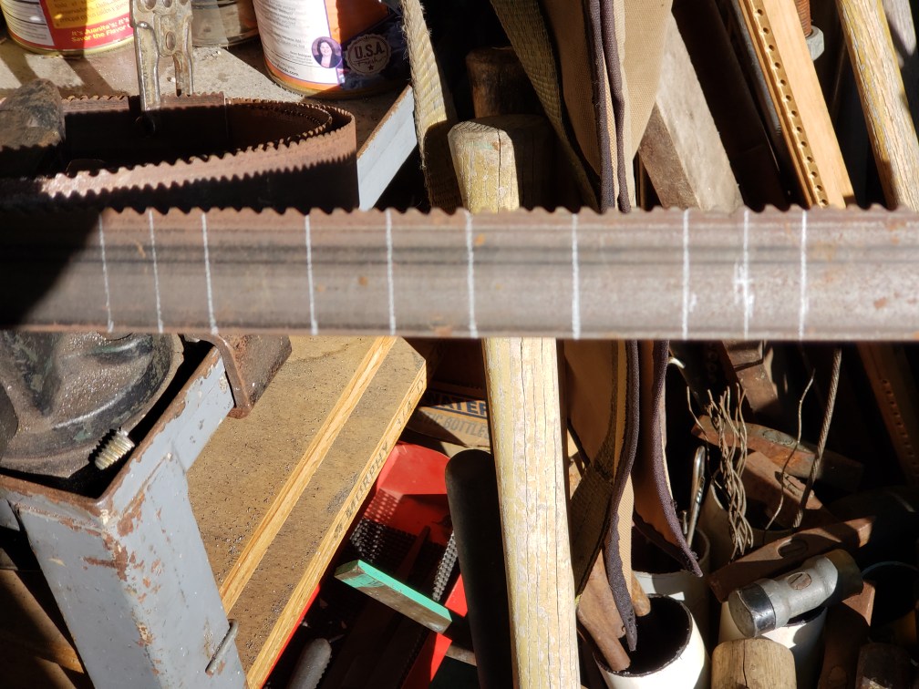

Anachronist58 Posted April 13, 2021 Author Share Posted April 13, 2021 Thanks, Nodebt, I was very excited to produce something besides tooling with my tooling... that blade is like a five ton vegematic, Made from bi-metal commercial band saw blade. The upcoming challenge will be when I try to fabricate cookie cutters from this material. I am practiced in most of the steps: Forming, grinding, brazing; will have a learning curve on heat treatment. ThomasPowers said: "I've found the dome headed RR bolts and spherical trailer hitch balls"... Yes, I have both of those in my kit. A bit inconvenient to have to blend out that pesky flat that resides on the top of most trailer balls... Good tip on the rock drills. I am basing my quick change tooling on 1"-8 threads, which is working out very well. Would love to see that 8" die set! Had to look up ginkgo leaves - those striations were fun to make with a blunt edged die. Robert Taylor Link to comment Share on other sites More sharing options...

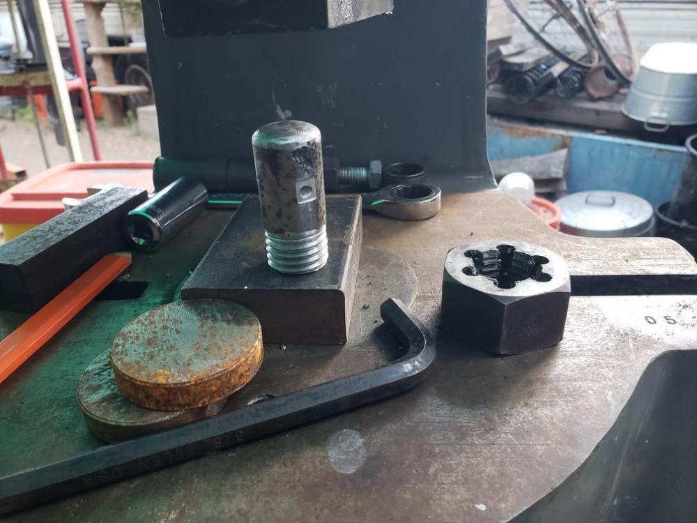

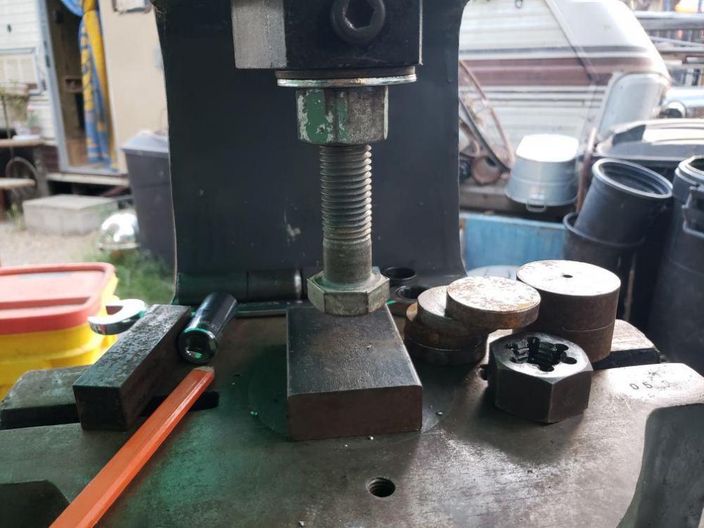

Anachronist58 Posted April 13, 2021 Author Share Posted April 13, 2021 Here is the 1"-8 top adapter for the quick change die: And the nut to receive tooling, with thrust washers to distribute the load to the ram face: Robert Taylor Link to comment Share on other sites More sharing options...
ThomasPowers Posted April 13, 2021 Share Posted April 13, 2021 The flats are a pain to deal with; that's why I specified spherical trailer hitch balls---the one with no flats. Not very common; so I pick them up whenever I find them at the scrapyard or fleamarket. An old armourer's trick was to buy a hitch with a flat, cut the ball off leaving a bit of the stem on it. Flip it over and weld the flat to the remaining stem and grind the little bit of the stem left on the ball to match the curve of the ball. Too much trouble for me; I just go with ones with no flat... Link to comment Share on other sites More sharing options...

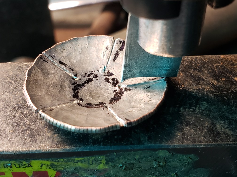

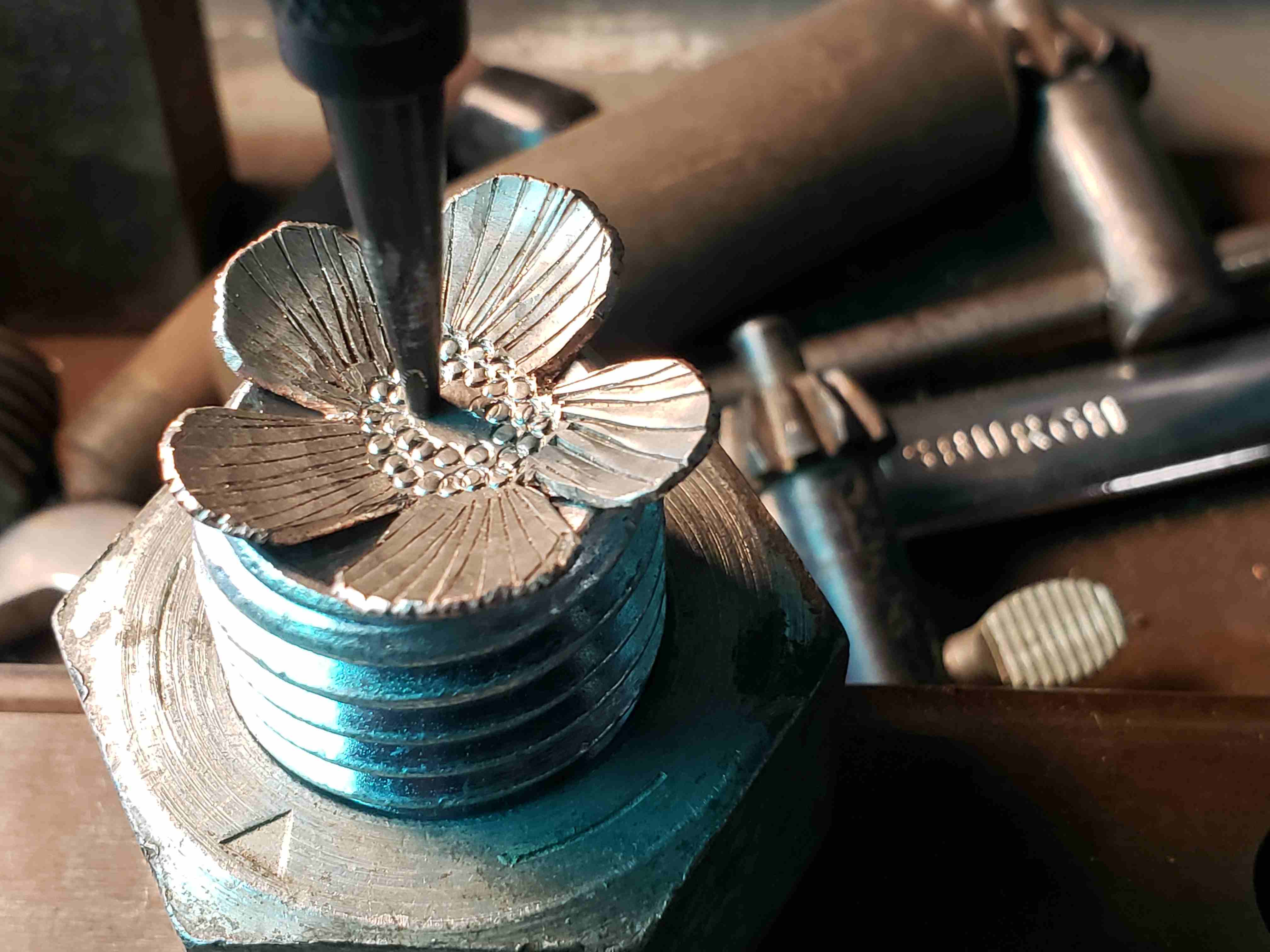

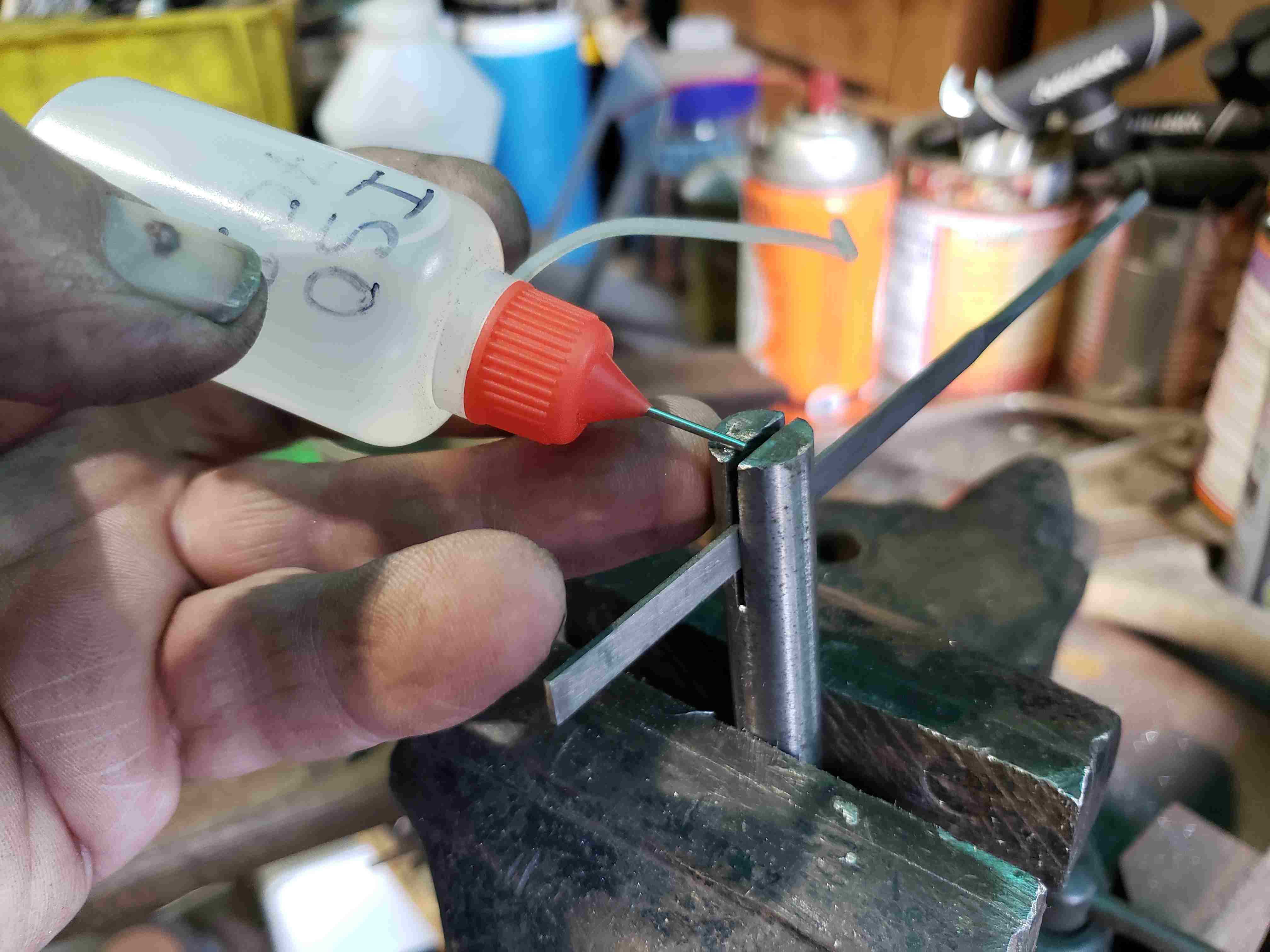

Anachronist58 Posted June 9, 2021 Author Share Posted June 9, 2021 Second iteration of two bit flower. Now I develop a set of feature-driven dies: Knife blanks from bimetal commercial bandsaw blade: Had to thin this file to .041" thick to finish the blade holder: Time to slice and dice: And here is the kaboodle: Note to self - do not vein the petals when fatigued and up against a deadline... these are a good bit more inconsistent than what I was going for: Driving up to Ventura, California, today to deliver the goods. Thanks for looking, Robert Taylor Link to comment Share on other sites More sharing options...

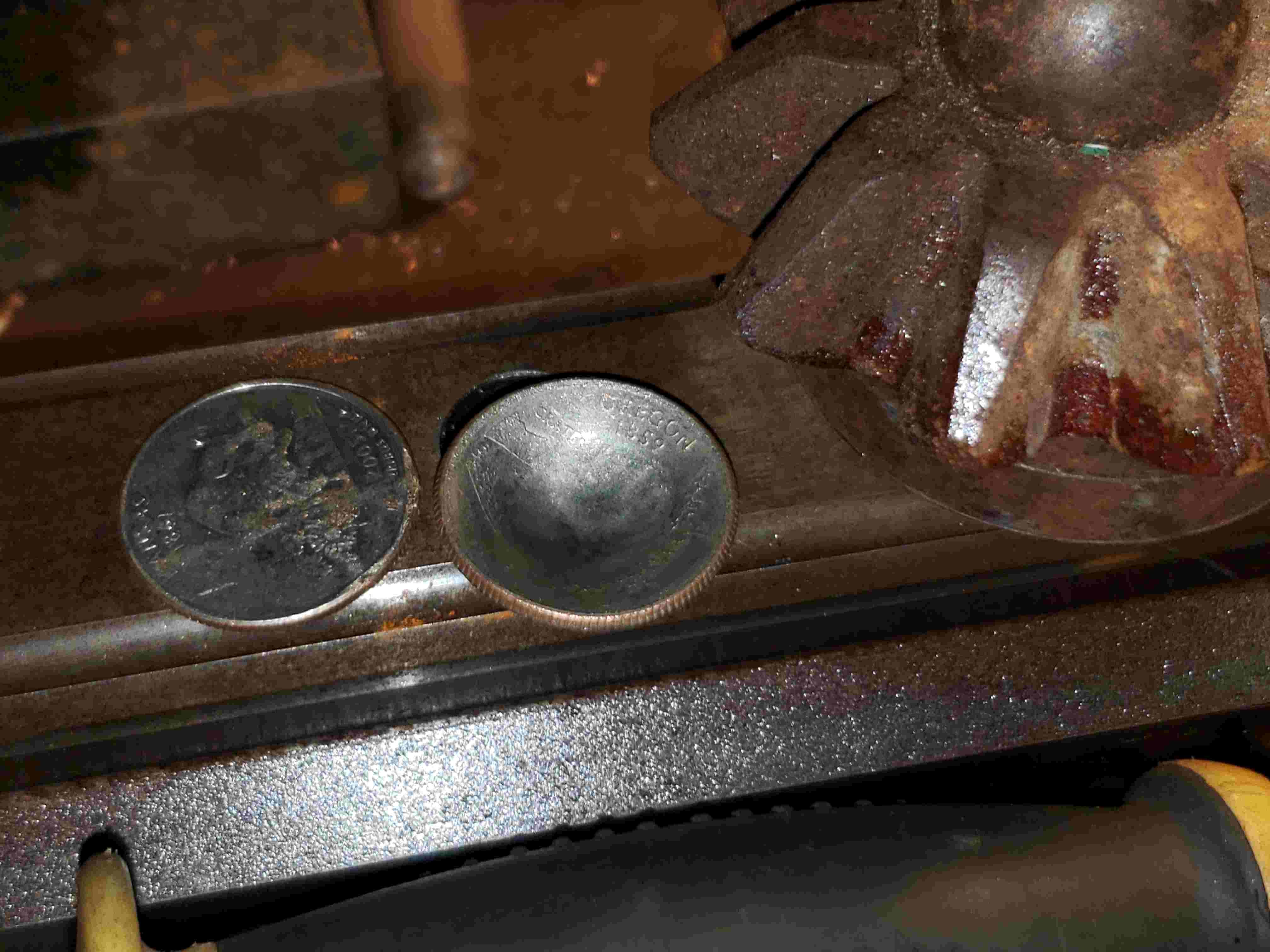

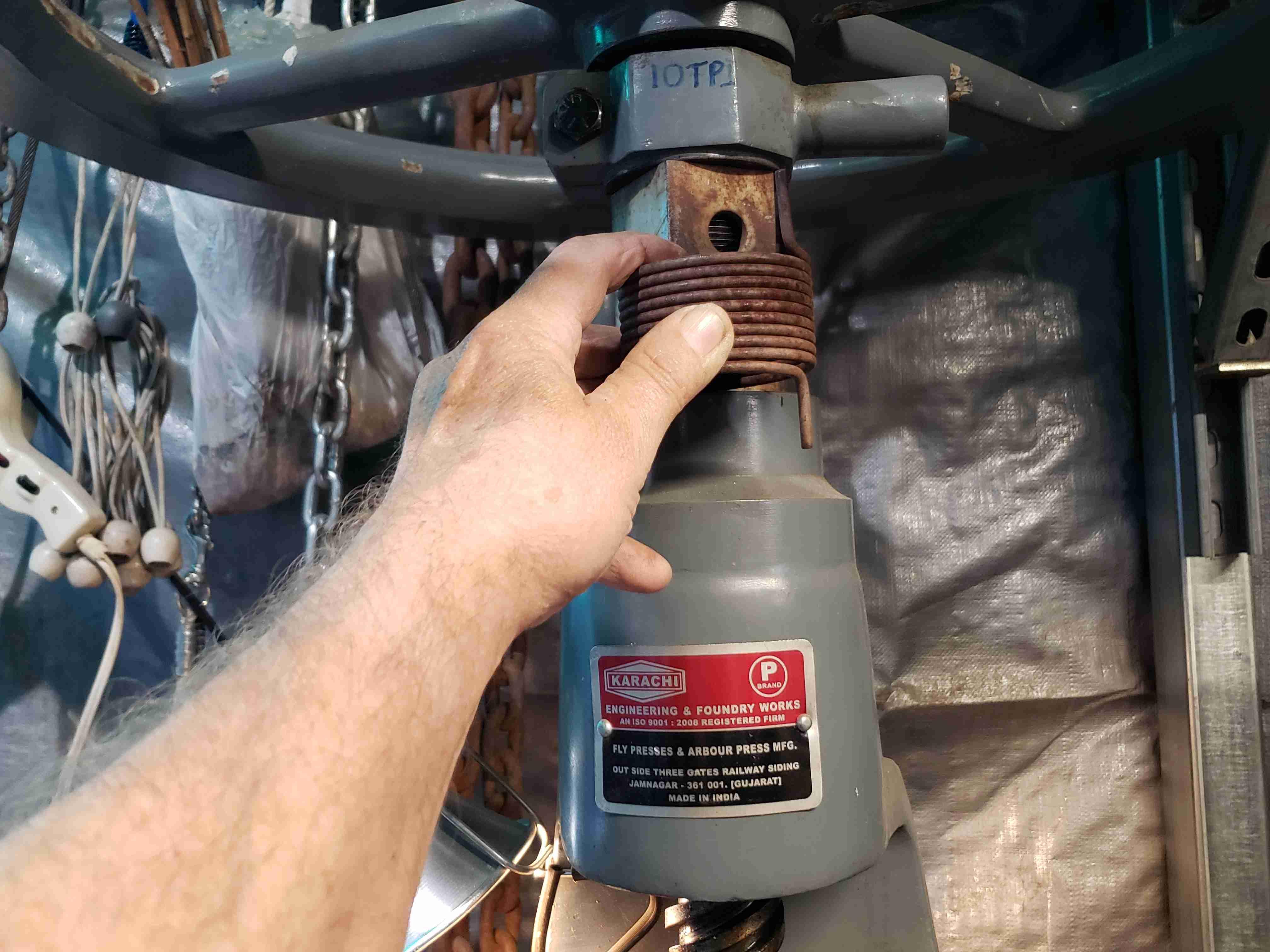

Anachronist58 Posted January 28, 2022 Author Share Posted January 28, 2022 Tantalizing.... As I struggle to stay above the water of various Maladies, this press has been a way forward through my rubbishiest moments. Pictured is a return spring a bit like the one I will deploy for some of my favorite thump-a-thump operations, such as earlier pictured two bit flower, which I can still do if I can make it downstairs. The point of this post is not the disability, but rather, the Possibility! Keep swinging at 'em, Brothers and Sisters! Robert Taylor Link to comment Share on other sites More sharing options...

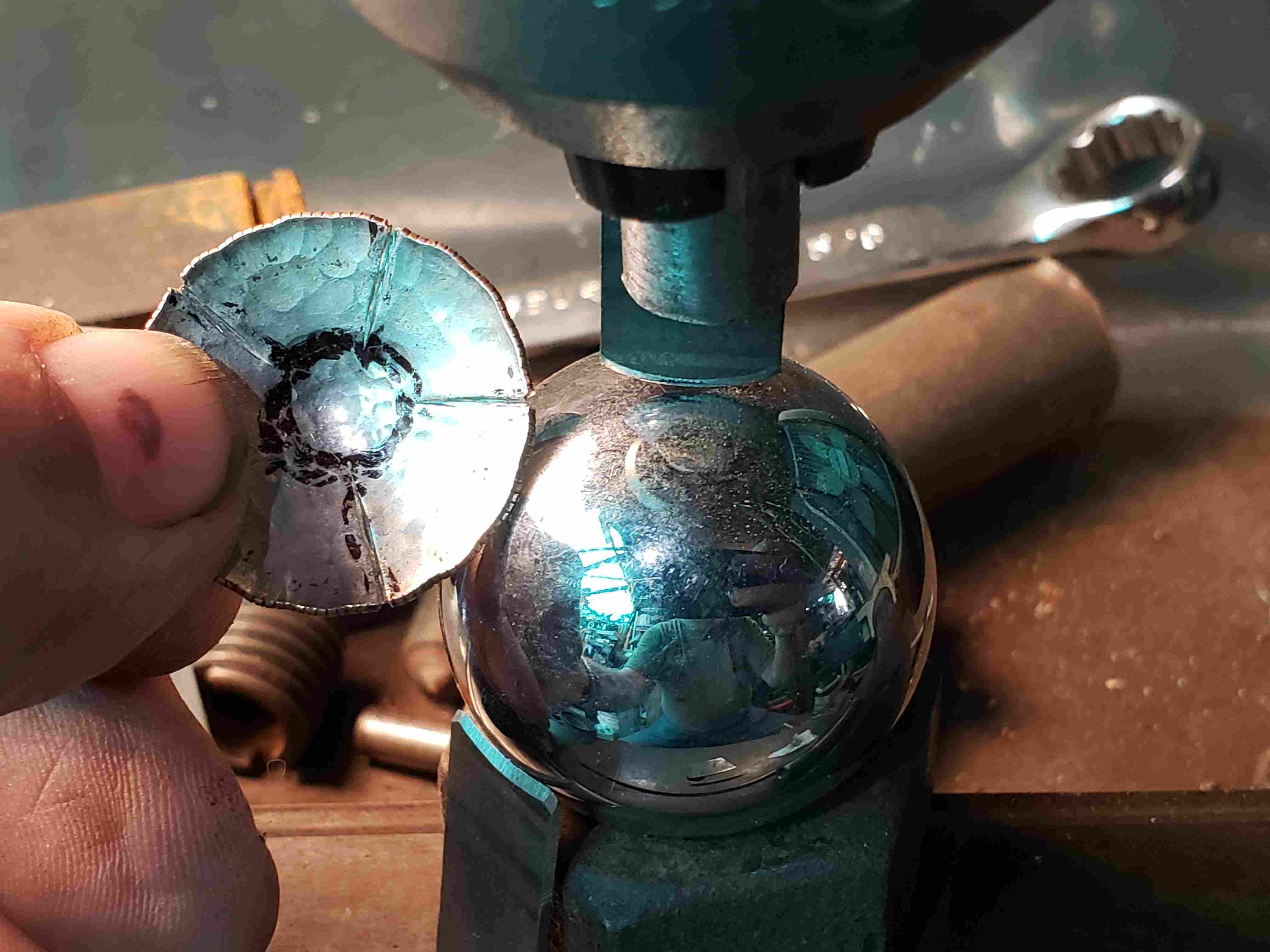

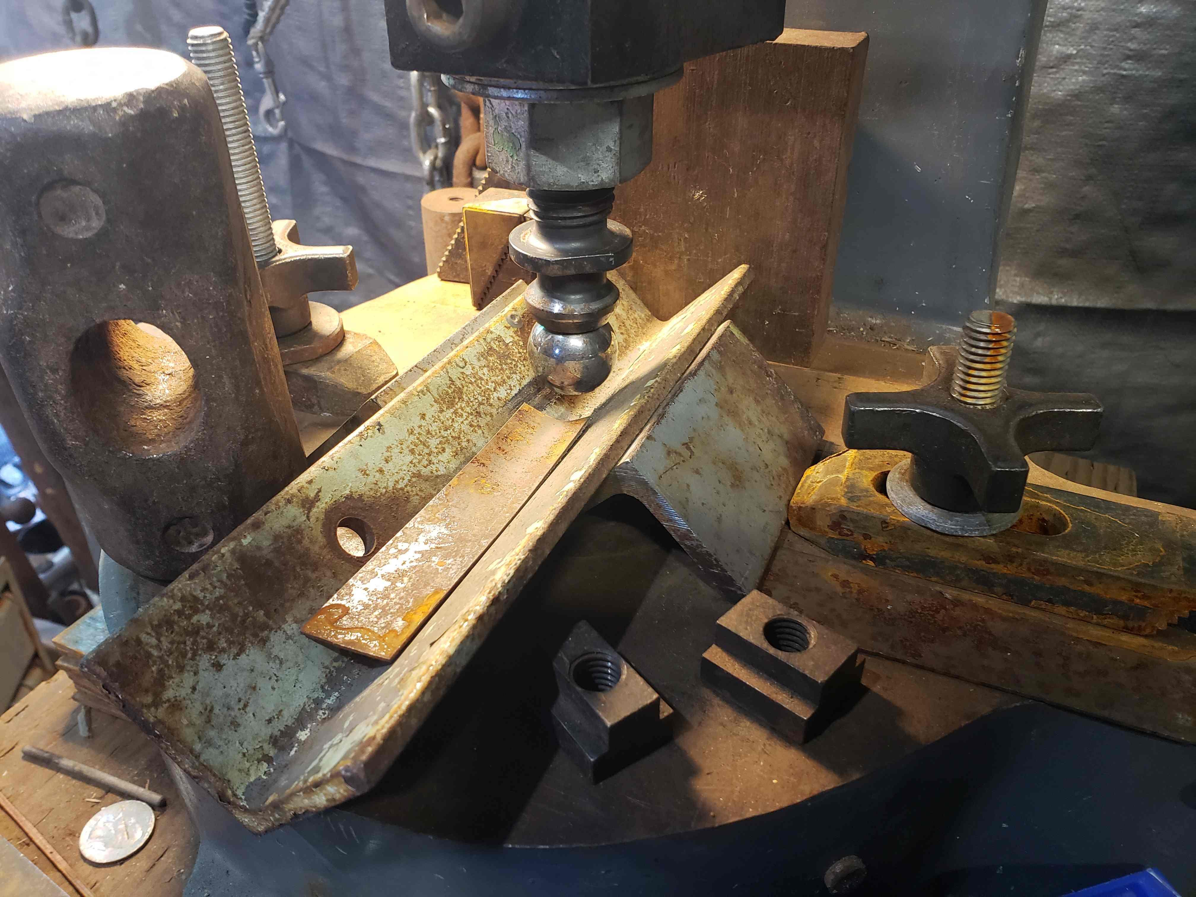

Anachronist58 Posted March 25, 2022 Author Share Posted March 25, 2022 Cold forming commercial bandsaw blade as a hammer eye cleanup chisel. This eye had a lot of big chunks in it. Works well. Magnetic ball chuck holds different sized balls. I am sure someone will steal my idea, or, am I unwittingly stealing it from someone else? Oh, the Mystery!! Robert Taylor Link to comment Share on other sites More sharing options...
Scott NC Posted March 25, 2022 Share Posted March 25, 2022 Apply for a patent and see what happens, that will clear it up. I have seen some of my sculpture ideas hyjacked on the internet. I don't care. I consider it "free ware" as far as my stuff goes if I put it on the www. If I want to adopt someone elses things, I always ask. I don't think you can patent scrap metal artwork anyway. Nice work, keep it up. Link to comment Share on other sites More sharing options...
ThomasPowers Posted March 25, 2022 Share Posted March 25, 2022 Nope that would be a copyright type of thing. I'm more likely to steal the method of mounting the angle iron for use. I still pick up all the dome headed solid tow hitches I find. Flat topped are easy to find; but I find the true domed ones more useful. (I've met SCA armourers that have actualy cut a flat topped ball off and flipped it over to weld the flat onto a stem and then grind the cut to match the curve of the ball---much easier to find a dome headed one to start! Link to comment Share on other sites More sharing options...
Scott NC Posted March 25, 2022 Share Posted March 25, 2022 Is that magnetic ball chuck sort of like a "quick change"? I could see TW's "cannonball agitators" of different sizes working well for such an application... Just add threads! Link to comment Share on other sites More sharing options...
Anachronist58 Posted March 26, 2022 Author Share Posted March 26, 2022 Scott, I am too tired to try to protect my presumptive intellectual property. I have a younger brother who stole most of the good DNA, and he he has many patents, and shares our 'open source' philosophy... all good. The 'quick change' on the pictured chuck, is in that one can simply pull one ball off, and throw another size on. This one has an accidentally pleasing range of about ø.5" - ø1.0". I have a worked out a hyperbolic curve for a wider range for a single chuck. That is, a curvature that grips various ø balls with adequate force. I have a very competent grinding machine to achieve the desired profile. It is all savantry at this point, and requires further proof of concept. 11 hours ago, ThomasPowers said: I'm more likely to steal the method of mounting the angle iron for use. Very handy, Thomas. We always wish to weld up a proper fixture once we have proven our concept, but one reliable Blacksmith's addage, is that prototype and mockup often become the finished product. Nonetheless, this is one item well worth fabbing up, as a floating flypress V-block is a thing delightful, indeed. And SO simple to fabricate... I suppose I ought to produce that batch of pudding... Robert Taylor On 1/28/2022 at 7:31 AM, ThomasPowers said: that he rigged up a rotary table to hold dies for it and change them out *fast*. IIRC he was using a differential for the bearing and a thick plate cut in a circle with the dies mounted towards the edge of it. I would love to see that... Link to comment Share on other sites More sharing options...
