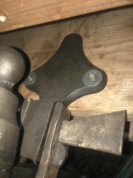

SBOhio Posted January 26, 2018 Share Posted January 26, 2018 Purchased this a while back and couldn't see anything on it. Getting it set up now and I found some numbers that I hope help with figuring out it's history. The front, moveable jaw has "1909" stamped on near the top and "70" underneath. The mounting bracket is stamped with a large "4" on the bottom side. Both Jaws each have an "8" stamped on the inside. They measure 5 3/8" across. Thanks ahead of time for any help. Quote Link to comment Share on other sites More sharing options...
Judson Yaggy Posted January 26, 2018 Share Posted January 26, 2018 An overall pic would be most helpfull in IDing your vise. Individual parts were often replaced or shop made, but overall styles are sometimes indicitive of origin. The mounting plate shown in the above pic could be Columbian or one of the other 19th/early 20th century American makers. Quote Link to comment Share on other sites More sharing options...
Irondragon Forge ClayWorks Posted January 26, 2018 Share Posted January 26, 2018 From what I understand 1909 is the year it was made and the 70 is the weight. Quote Link to comment Share on other sites More sharing options...
SBOhio Posted January 26, 2018 Author Share Posted January 26, 2018 I will get an overall picture posted. Took is down to do a little cleaning up. I think It's missing the thrust washer on the moveable jaw. I was thinking this was the date and year built also. Quote Link to comment Share on other sites More sharing options...

Teddybo Posted January 22, 2019 Share Posted January 22, 2019 You have a trenton post vise they’re the only ones that I know of that stamped the year of manufacture on the jaws and your mounting plate looks like a trenton And so does the rest of it mine you can kinda make out above the date stamp where it says original Trenton Quote Link to comment Share on other sites More sharing options...
