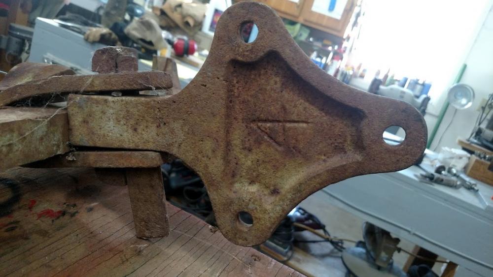

  2. SBOhio posted a topic in Vises
    Purchased this a while back and couldn't see anything on it. Getting it set up now and I found some numbers that I hope help with figuring out it's history. The front, moveable jaw has "1909" stamped on near the top and "70" underneath. The mounting bracket is stamped with a large "4" on the bottom side. Both Jaws each have an "8" stamped on the inside. They measure 5 3/8" across. Thanks ahead of time for any help.
