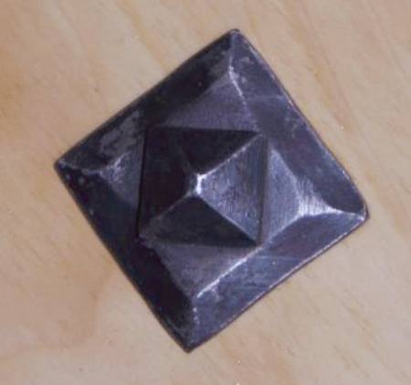

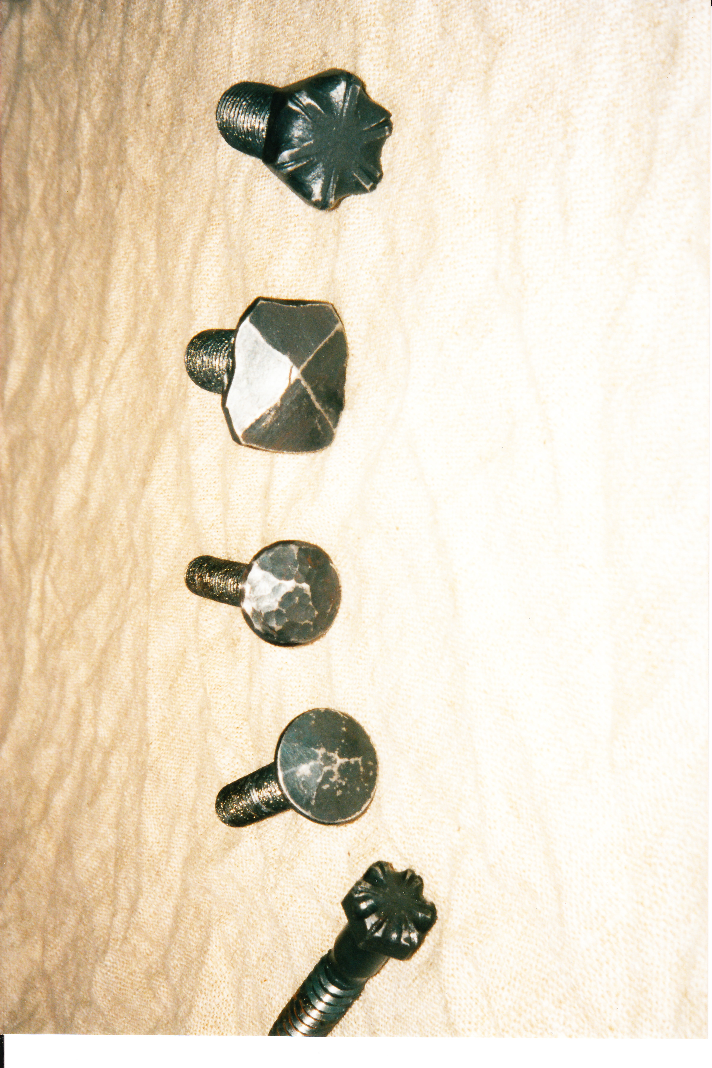

Judson Yaggy Posted January 26, 2018 Share Posted January 26, 2018 Some ideas. Quote Link to comment Share on other sites More sharing options...
Donniev Posted January 26, 2018 Author Share Posted January 26, 2018 Judson is that first picture something that you just glue to the top of the screw to hide it? Quote Link to comment Share on other sites More sharing options...
Judson Yaggy Posted January 27, 2018 Share Posted January 27, 2018 It's a bolt head and washer. Quote Link to comment Share on other sites More sharing options...
