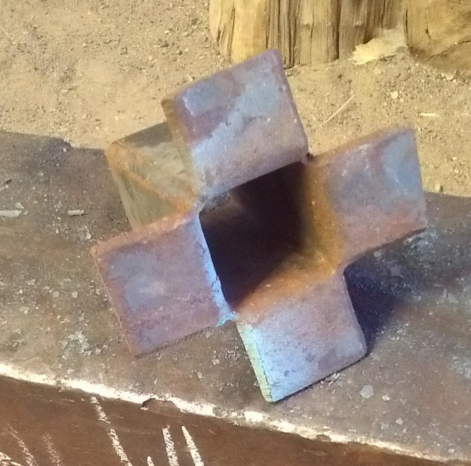

ThomasPowers Posted June 1, 2022 Share Posted June 1, 2022 I have several anvils with hardy holes over 1" in size; 3 are 1.5"; as many "found" hardy tools are 1" or less I need a way to mount them securely in the larger holes. Here is my method for doing inserts and pictures of a single liner and double liner as examples. Now if someone had a good way to nondestructively mount the 1.5" hardy stem tooling in 1" hardy holes... (My method of making 1.5" stem hardy tooling is to take top tools and forge the eye down till they fit...damaged striking area top tools are fairly easy to find and cheap and my screw press makes for nice parallel sides once you forge close to size.) Quote Link to comment Share on other sites More sharing options...

Mothman_c3w Posted December 2, 2022 Share Posted December 2, 2022 Thomas, I know it's been a while since your post, but I had an idea (see the below sketch). You may have already considered and/or tried it, but I thought I'd share. The biggest issue I see with this is that your hardy tools would sit a few inches above the surface of your anvil. Also, I too made an adapter for found hardy tools with smaller shanks than the hole in my anvil. I picked up this hot cut from an estate sale a few years ago that has a 5/8" shank. I made a sleeve from some square tube, much like yours, but I welded on a shoulder and some liner pieces to keep the tool from wiggling in the sleeve. Quote Link to comment Share on other sites More sharing options...
