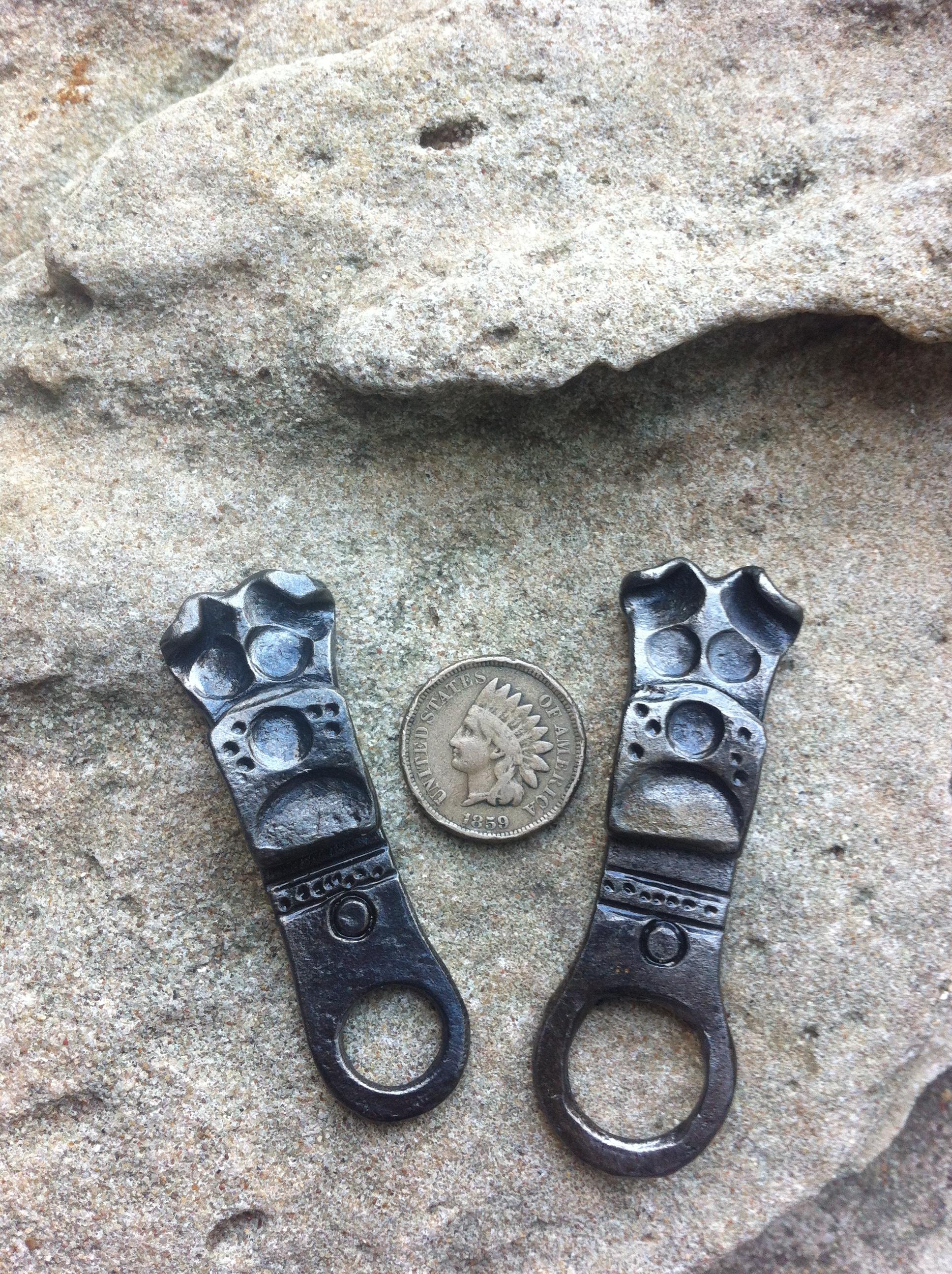

Mark Ling Posted November 17, 2017 Share Posted November 17, 2017 I recently made these ones recently. Forged from 1/8x1/2". And some more key chain ideas. https://www.iforgeiron.com/applications/core/interface/file/attachment.php?id=115646 Oh and that link is a how to slide show. Littleblacksmith Quote Link to comment Share on other sites More sharing options...

Dillion Brian Grant Posted November 22, 2017 Share Posted November 22, 2017 2 minutes ago, ThomasPowers said: If you don't put the needed information into the question the answers will probably not apply to your exact situation. (And if you assume they do apply you may not be happy with the results...) ok I understand and I realize I really didn't word everything very well but let me fix that now, what I would like to do is obtain ideas for key fob ideas I would prefer the stuff to be made from 1/2" square stock thanks in advance Quote Link to comment Share on other sites More sharing options...
ThomasPowers Posted November 22, 2017 Share Posted November 22, 2017 take a short length; Butcher a cube on the end and stamp it with dice pips (opposite sides add up to 7 is a common version) except for the top with the rest of the stock attached----forge that down to a small round taper and bend the end over to hold the splitring for the keys. Tumbling is suggested to help smooth the edges needs to be small enough and smooth enough to do well in a pocket! Note I once made 30 pairs of cowboy hat earrings out of pennies using the instructions for making cowboy hats out of steel only doing them smaller---you do have to use pennies that predate the switch to copper plated zinc ones---I always sort those out of my change to have a supply on hand for other tasks. (Our church was having a cowboy dance, I don't dance but wanted to do something so door prizes...) Quote Link to comment Share on other sites More sharing options...
Dillion Brian Grant Posted November 22, 2017 Share Posted November 22, 2017 51 minutes ago, ThomasPowers said: take a short length; Butcher a cube on the end and stamp it with dice pips (opposite sides add up to 7 is a common version) except for the top with the rest of the stock attached----forge that down to a small round taper and bend the end over to hold the splitring for the keys. Tumbling is suggested to help smooth the edges needs to be small enough and smooth enough to do well in a pocket! Note I once made 30 pairs of cowboy hat earrings out of pennies using the instructions for making cowboy hats out of steel only doing them smaller---you do have to use pennies that predate the switch to copper plated zinc ones---I always sort those out of my change to have a supply on hand for other tasks. (Our church was having a cowboy dance, I don't dance but wanted to do something so door prizes...) So, are u saying making a dice fob? That sounds really neat any other ideas? Quote Link to comment Share on other sites More sharing options...
ThomasPowers Posted November 22, 2017 Share Posted November 22, 2017 Take a small section and incise it to make a basket Make a small bottle opener---not the loopversion Quote Link to comment Share on other sites More sharing options...
Dillion Brian Grant Posted November 22, 2017 Share Posted November 22, 2017 22 minutes ago, ThomasPowers said: Take a small section and incise it to make a basket Make a small bottle opener---not the loopversion What do u mean incise? And also is mild steel usable for a bottle opener? Quote Link to comment Share on other sites More sharing options...
ThomasPowers Posted November 22, 2017 Share Posted November 22, 2017 I'd say that most bottle openers are made from mild steel and for incise; I'm using it pretty much in the dictionary definition sense. Hmmm I may have to try out a ring opener with no handle design. Quote Link to comment Share on other sites More sharing options...
Dillion Brian Grant Posted November 22, 2017 Share Posted November 22, 2017 1 hour ago, ThomasPowers said: I'd say that most bottle openers are made from mild steel and for incise; I'm using it pretty much in the dictionary definition sense. Hmmm I may have to try out a ring opener with no handle design. ohh so following the definition you are meaning to incise the stock so that it looks like a basket? let me see how it turns out Quote Link to comment Share on other sites More sharing options...
