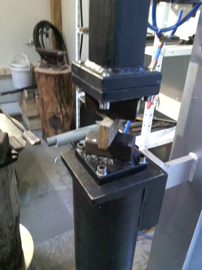

Stitch Posted September 18, 2017 Share Posted September 18, 2017 Well, it's finally finished. I tore it down Saturday and the wife cleaned and painted it for me. Great gal that one! I ran out of grease zerks and will have to make a run to TSC. I believe the lead shrank a bit after I welded in a "V" shaped stop inside the hammer right after pouring the lead in. I have to figure that one out yet. It doesn't seem to affect the awesome striking power any. Here's the video I made right after re-assembly. I love the control ability. Now to make some specialized tooling for it. Stitch Quote Link to comment Share on other sites More sharing options...

will52100 Posted September 19, 2017 Share Posted September 19, 2017 Nice! I had the lead come loose on mine, it was bought second hand and had run for a couple of years before I got it, and run hard for several years after I got it. It eventually got to the point the block of lead was sliding up the hammer tube and smacking into the toggle arm pins while running. I plugged the lower die bolt holes with bolts and put the head over my turkey frier/scrap lead melter and remelted it. Afterward stuck a 1/8" plate down inside the tube and welded the corners so it couldn't move again. Quote Link to comment Share on other sites More sharing options...
Stitch Posted September 19, 2017 Author Share Posted September 19, 2017 That is a brilliant idea! Will! I welded an "L" shaped piece of steel inside the hammer tube for now and yep, it stopped the movement. It was only moving about 3/8" until it hit the "V" shaped stop I had previously welded in so hopefully that will hold for a while.If I ever have to re-melt the lead, I am going to use your method. Thank you! I hammered out a fleshing fork last night from some 1/4 x 3/4 mild steel and it was fun and quick drawing it out on the standard tooling blocks! It went so quick, I forgot to make a video. I will make one today I hope. Quote Link to comment Share on other sites More sharing options...
will52100 Posted September 19, 2017 Share Posted September 19, 2017 Just make sure you put bolts in the holes for the die blocks. I didn't and didn't know they went all the way through. Lead started trickling out the holes as I was heating and had to stop and cool down and drill out and plug with bolts. Quote Link to comment Share on other sites More sharing options...
Stitch Posted September 19, 2017 Author Share Posted September 19, 2017 Will do! Thank you! Quote Link to comment Share on other sites More sharing options...

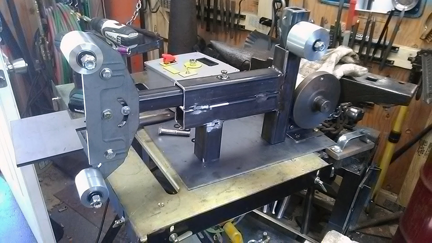

Stitch Posted September 23, 2017 Author Share Posted September 23, 2017 On to my next project. I needed a new 2 x 72 belt grinder. I found a really cheap treadmill and it's now a motor for my project... Stitch Quote Link to comment Share on other sites More sharing options...
JHCC Posted September 23, 2017 Share Posted September 23, 2017 Start a new thread! Quote Link to comment Share on other sites More sharing options...
Stitch Posted September 23, 2017 Author Share Posted September 23, 2017 Typing it as we speak! Lol... Quote Link to comment Share on other sites More sharing options...
Charles R. Stevens Posted September 24, 2017 Share Posted September 24, 2017 Might I suggest building your dies on the diagonal, so long stock doesn't hit the hammer frame. Quote Link to comment Share on other sites More sharing options...
will52100 Posted September 25, 2017 Share Posted September 25, 2017 Good suggestion, I didn't even notice that. Quote Link to comment Share on other sites More sharing options...
Stitch Posted September 25, 2017 Author Share Posted September 25, 2017 Hi Charles, Yes. I have 3 diagonal die sets I use and more to come. This set is for my fuller attachments. I didn't make a video with them on yet. More video to come. I appreciate your input, Thank you Charles! Quote Link to comment Share on other sites More sharing options...

Charles R. Stevens Posted November 26, 2017 Share Posted November 26, 2017 Yep, that's why, also with a diagonal die welded to a square plate one can use the two ears as places to bolt down the die. Walla two problems solved. Quote Link to comment Share on other sites More sharing options...
Hans Richter Posted November 26, 2017 Share Posted November 26, 2017 Congratulation Stich, wish you many happy forging hours with the new machine. Just get a Deja’vu, I also ask the boss at home to do the paint job. Maybe another tip, be aware that the dices (and you) can get hurt if you let them run ‘cold’ against each other. I usually try them out with some wood or a piece of rubber conveyor belt between them. Even when I not use the hammer I always have a wooden block between them. The dices are holy to me. Got two sets of dices and several hardy tools and able to do almost everything with them. Just busy to build some fuller tools to forge repeating pieces like balls, rosettes and leafs. Enjoy your hammer. Cheers, Hans Quote Link to comment Share on other sites More sharing options...
Stitch Posted November 26, 2017 Author Share Posted November 26, 2017 Thanks for that reminder! As a toolmaker for years, I know all too well what can happen! I made a lot of kindling when I was testing it out! Lol! Nice tooling Hans! Quote Link to comment Share on other sites More sharing options...
Kal Posted December 4, 2017 Share Posted December 4, 2017 Very nice hammer. I like the way the head is secured in its tube. For future reference too prevent the lead from coming loose weld some ears into the inside of the head or run a a rod from one side to the other to give the lead something to form around. Quote Link to comment Share on other sites More sharing options...
