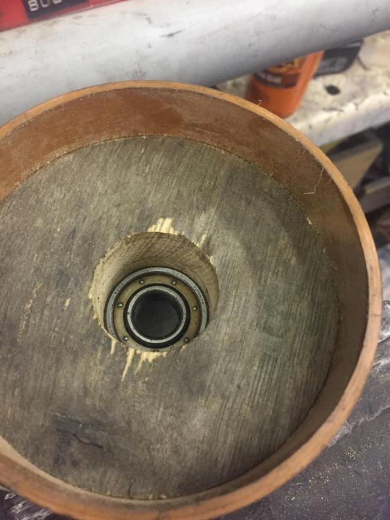

  1. So I went the cheap arsed route and as advised I replaced the skateboard bearings with some ABEC9 ones adding another £4:99 to the cost of the build (£12:00 now) it runs quieter and tracks true so just a can of paint and i’m done. apart from making a 6” wheel and an adjustable work rest :-) cheers for the advice that i’ve received along the build.
  2. Cheers for the ...well interesting reply Mark Thomas lol, I think part of the noise was one of the small rollers was catching on the platen plate every revolution. Thanks for the information on bearings, the new ones i’m Looking at are abec9. so I ran the grinder for half an hour sharpening everything I could :-) and here’s what I found: 1/ the heat generated softens the contact adhesive I glued the wheels together with.. 2/ the cheap Chinese belts don’t last long and have thick joints that bump the work piece every revolution 3/ I platen wheel shafts are too short, causing the nuts to back off. solutions are: redo wheels with epoxy resin and new abec9 bearings (£4.99 for 8) or take the plunge and buy a set of nylon wheels from Poland (£70 posted) buy better belts :-( replace the wheel shafts..

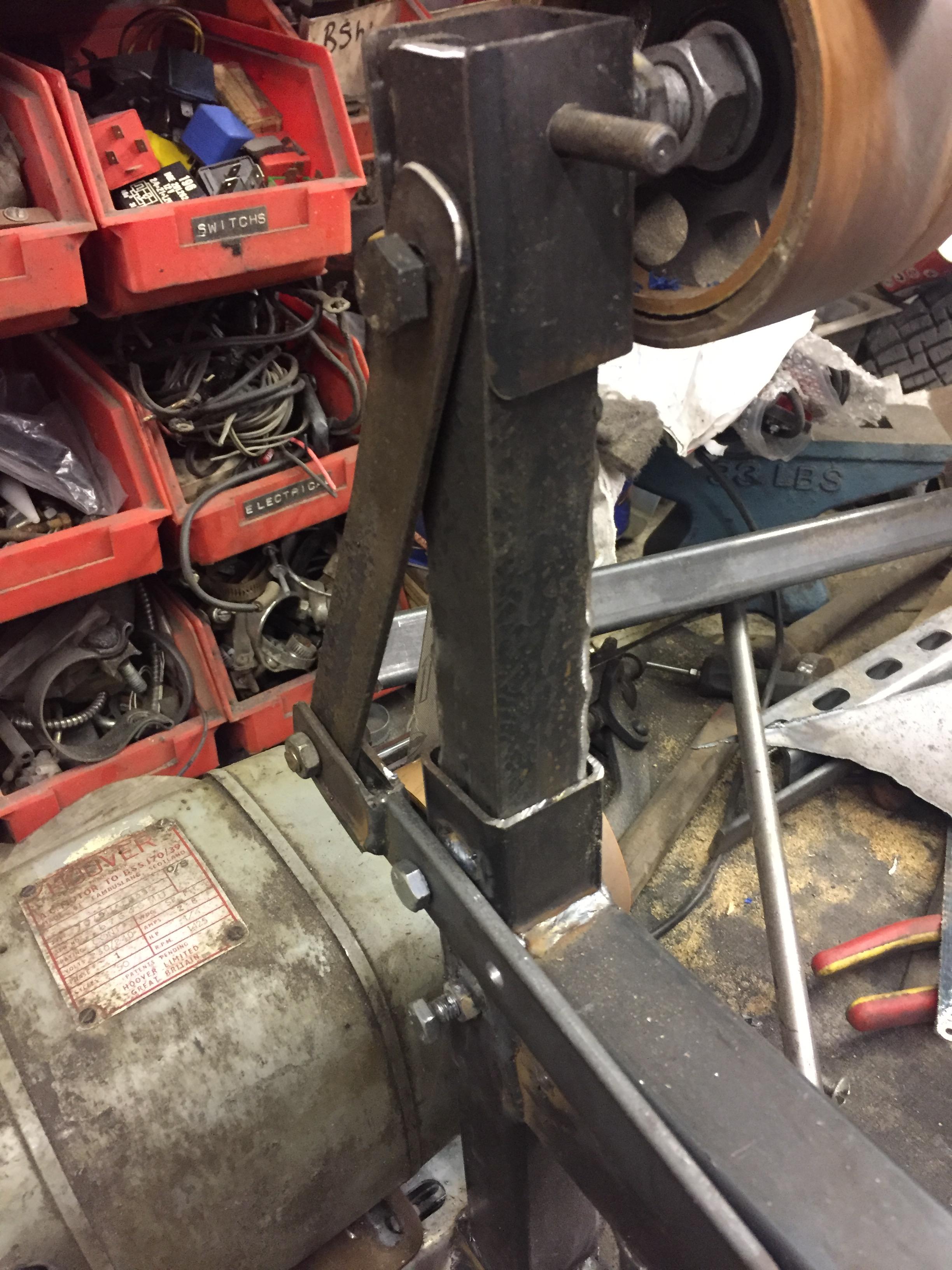

  5. Today crowned the adjuster arm and made a lever to pull the tension arm in for easier belt replacement. Test run.. a little noisy but I’ll replace the skateboard bearings with something a bit better. I’m happy with the grinder that has only cost me £8:00 ( for the 6 belts from China incl postage) video below :-) cheers Kevin 69E3BED9-23EC-407A-80F5-291155FA821D.MOV

  8. So tonight I roughed out the tracking adjuster, I hope the pictures tell the story...

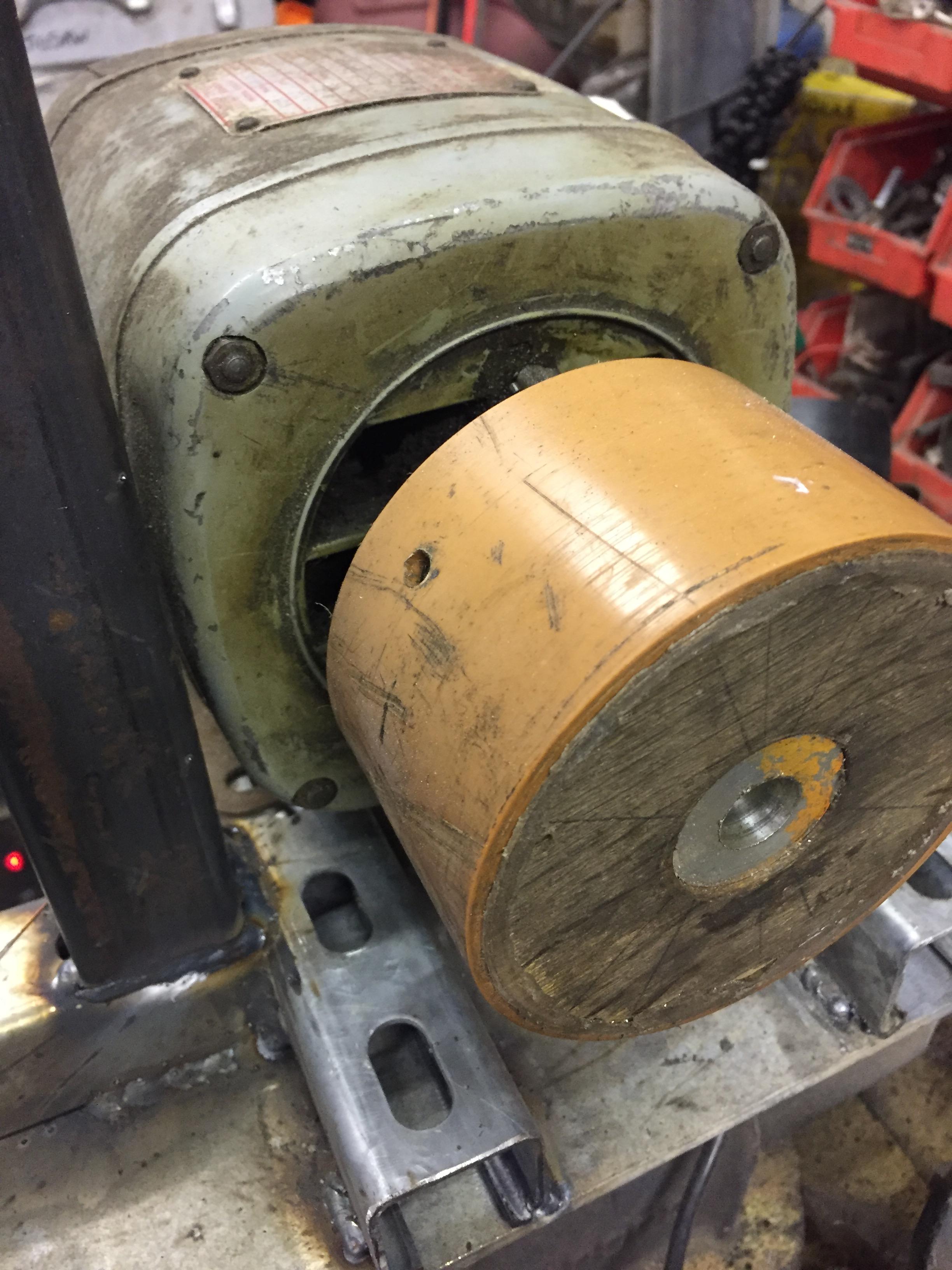

  10. I had a bit of a delay due to waiting for some 2x72 belts to come from China, 6 assorted belts for £7.09 including shipping.. they’ve arrived so now onwards again, I converted the 4” waste pipe pulley to a fixed wheel for the motor buy turning a shaft up on the lathe with a hole to fit the motors output shaft. I drilled and tapped the shaft and put in a grub screw to hold it onto the motor shaft I then welded up the frame parts that I could now cut to size with the belt roughly in place. I had a pulley wheel off a Land Rover belt tensioner that I was going to use for the adjuster wheel but a quick search revealed that I had no tubes to fit it, so I cut and glued some 4” pipe to fit. I also needed some box section to fit inside the box section I had built the frame from, another bodge required... 2 bits of angle iron ground to make a touch fit and then welded together... Tomorrow i’ll Get on with the tension wheel adjuster for belt alignment but i’m Please so for and it’s only cost the price of the belts from China :-)

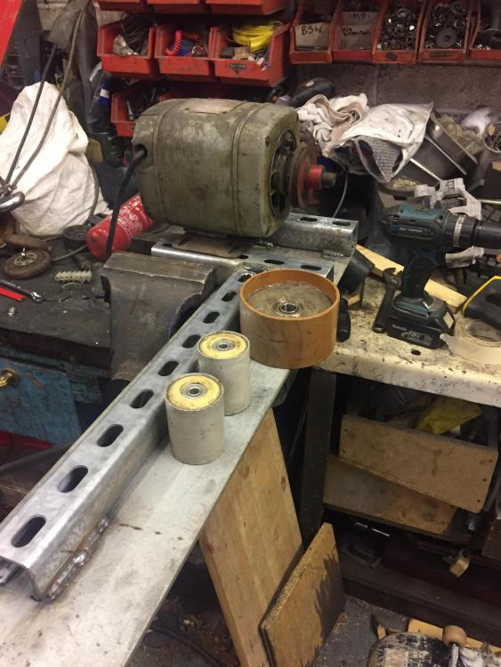

  15. I want a belt grinder but I can't afford one.... i know I'll make one with the stuff I have laying around, I have an old hoover electric motor and some bits of metal to start the frame, and some skateboard wheels. i turned the skateboard wheels down on the lathe to fit into some plumbing waste pipe, 2 skate wheels into each wheel, then for a bigger wheel I got some sewer pipe, I turned down 2 disks to fit inside the pipe from some oak floorboards and drilled them to fit some wheel bearings in... I've ordered some belts from China and I just need to make a drive wheel to fit the motor and loads of other stuff but I'll keep updating as I go ...
