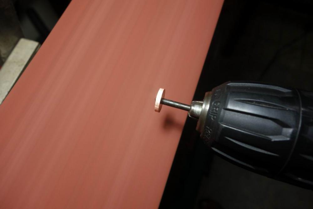

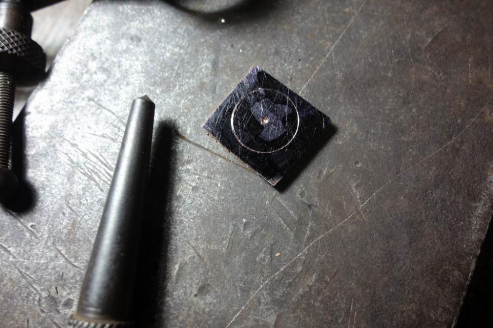

That's another work of art!  How did you make the "button" that embellishes the riveted tang?
Thanks a Lot for Your reply, Lou L!
They are made easy without a lathe.
In this case I took copper  2 mm thickness, M3 thread on the tang and a cordless screwdriver.
There are only e few fhings to be aware of......
keep the scribed compass line single and thin
dont roll it while grinding, push down in facetes
coming near the scribed line change from coarse grit to grit 100-150
keeping pushing down facetes until You reach the scribed line as even and near as possible.
attach it to the screwdriver and go to slack belt grinding
start it running before You hit the belt.
after rounding go to an angle and give it a bevel
The more precise You prepare, the more round it gets.
Cheers

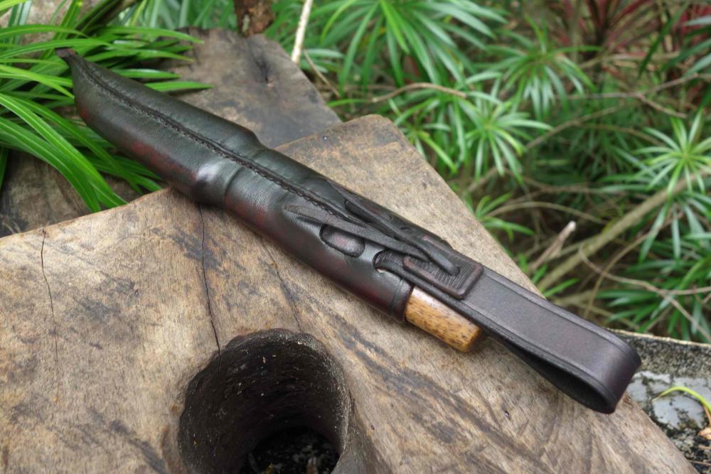

Amazing, really love this knife! I think it would be nice with a matching bone sheath, just an idea.
Think I'm going to be trying to make something similar to this (doubt it will be of the same high standard)
Thanks for sharing! :D
Thanks MastaStan!......with a matching bone sheath is in deed a nice idea.Sadly it would raise the price of the knife merciless, and bound to custom agreements this one goes out with a leather sheath....but I will do that on another one.
Looking forward to Your Puukoo!
  • 2 weeks later...
Those Scandinavian sheaths are a world apart for themselves.
In most cases I need 2-3 attempts before I get it right ...difficult stuff
So it takes always several days or sometimes weeks before I am able to rouse myself up and complete the job.....
Leather is half tanned with a raw hide core and blade section is lined with wood.
Cheers
