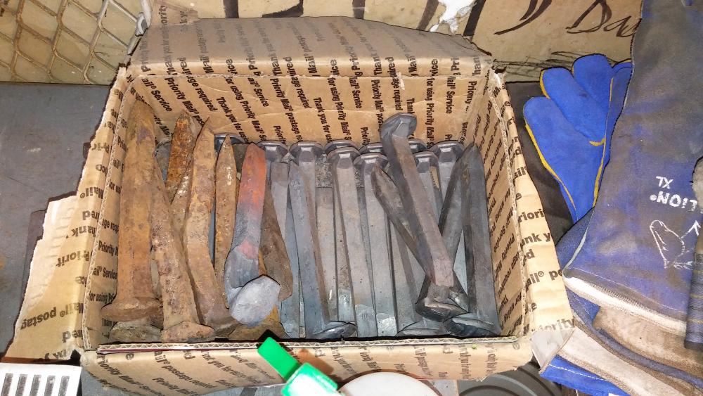

I will be doing a bit of everything, around the house projects, hinges, hooks, decorative pieces. And a lot of knives and axes as well. As well as general shop fabrication as well. I have 1095 and 1065 and 15n20 in a moderate quantity for now for knife making and making Damascus billets (eventually). and some angle iron.  Have a few coil springs and access to axles and leaf springs, i just have to go pick them up :P.
Heres my small pile. Have to keep it inside. But theres a couple big rig king pins (hammers one day?) input shaft to a 13 speed semi tranny, coil springs from the front of a F350(they made all my tooling). Its just in the corner of my garage. Theres another pic of my new long stuff. Square stock, tube etc.  Not alot , but its what I got. Then misc. small stuff in a box, then my box of mostly new rail spikes.  Its not a huge pile, but Its more then what I need for now.  :-)
