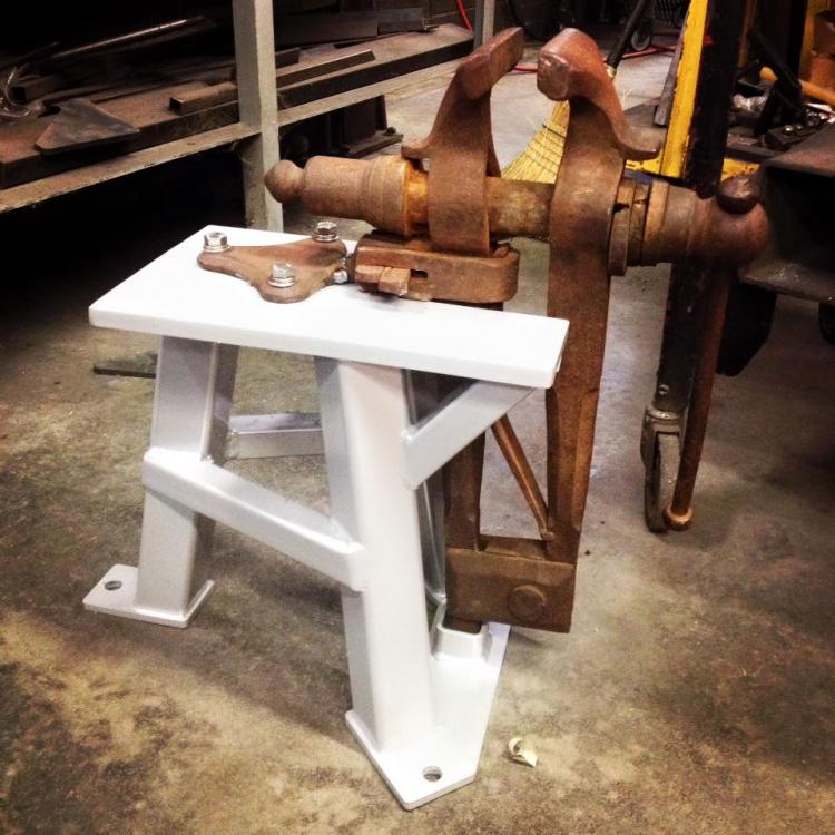

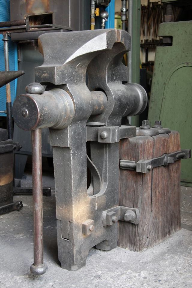

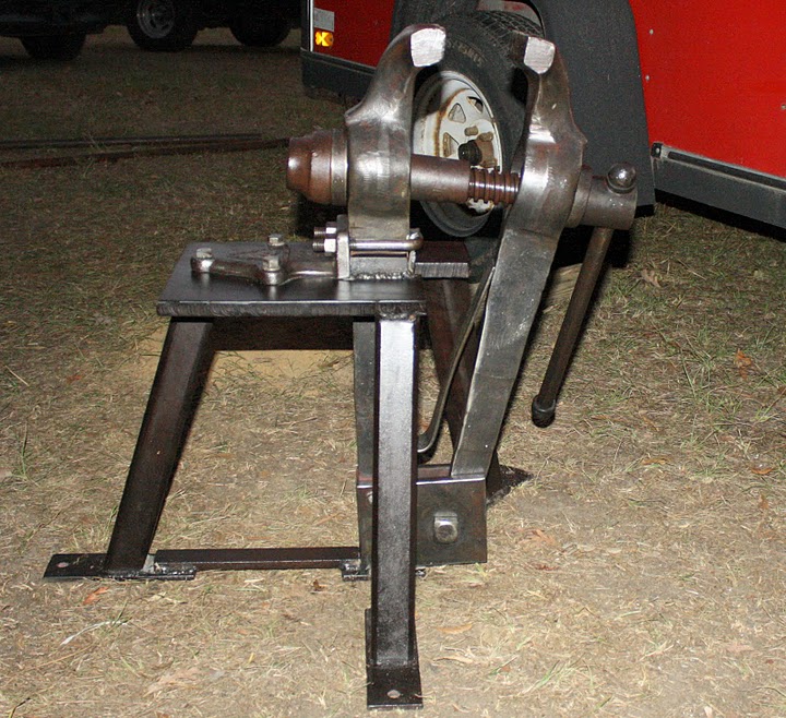

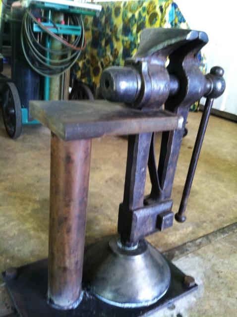

John McPherson Posted March 23, 2017 Share Posted March 23, 2017 Heavy vises are often mounted low to be used as striking vises, so a heavy stand with access on all sides is called for. These suggestions help? Quote Link to comment Share on other sites More sharing options...
