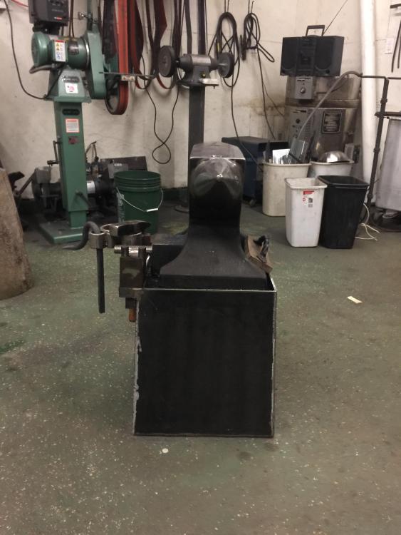

DuEulear Posted January 26, 2017 Share Posted January 26, 2017 my good old stump finally outlived its usefulness as it was slightly too high and wobbeled so i decided to make a new stand out of 1/4 plate. I went with a european style sand filled box with a small modification ( i added a through hole in the base on 1 side just the right size to fit my floor jack so i can pick it up and move it when i need to. ). Ive only forged on it once so far but i seem to be getting more hit outa my peddinghaus than i used to and it dosent wiggle anymore. Enjoy Quote Link to comment Share on other sites More sharing options...
