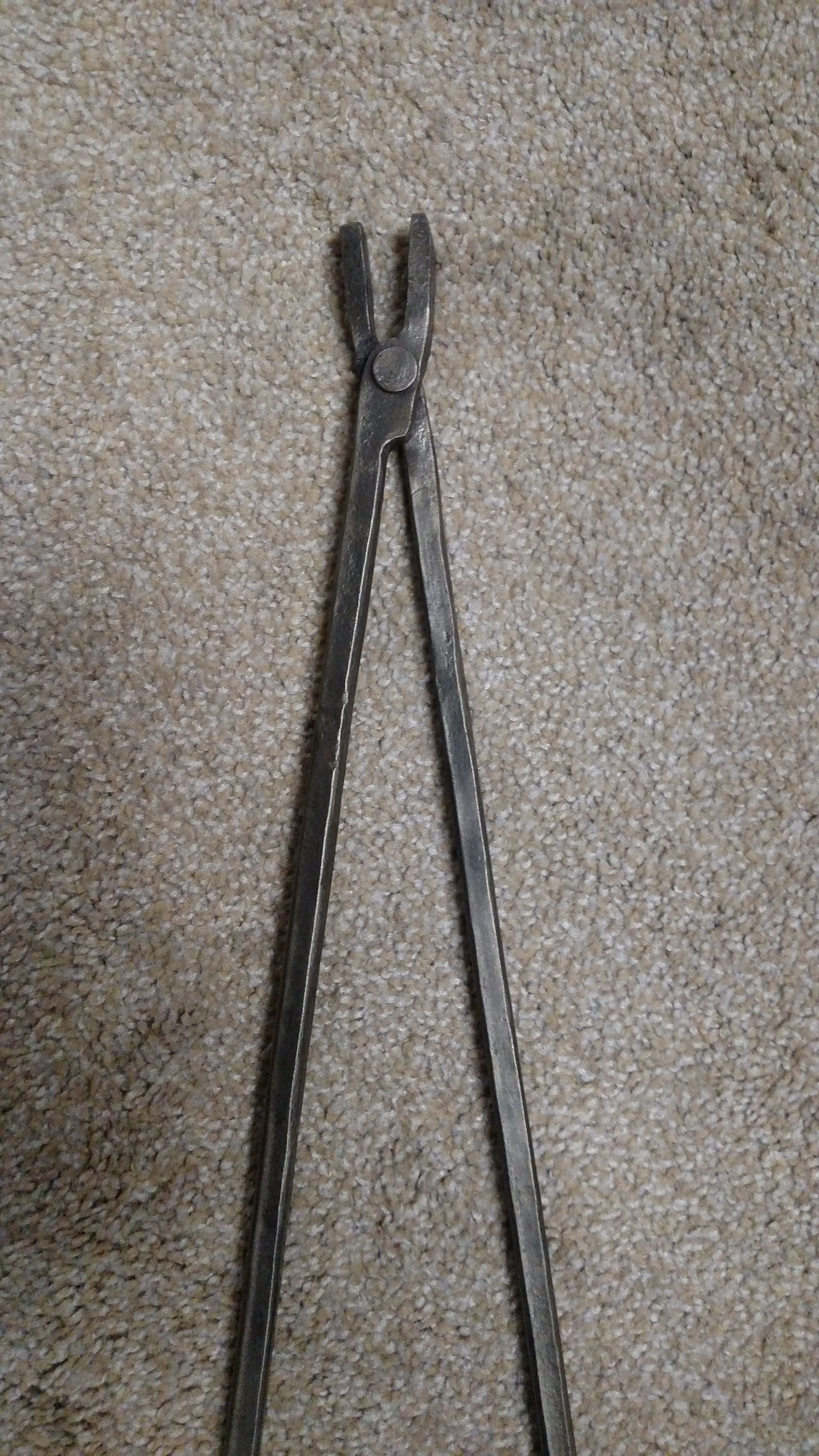

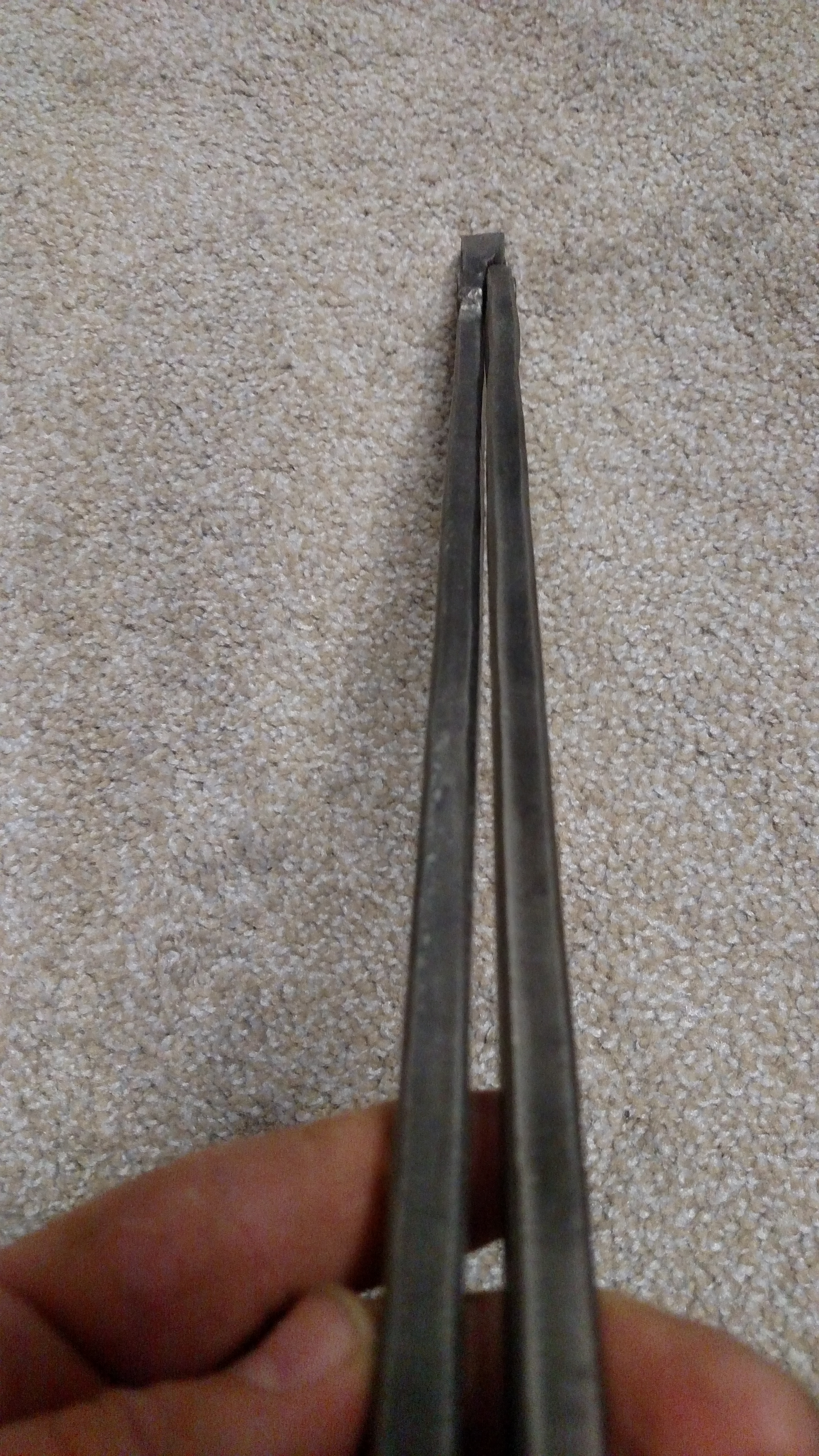

Flat jaw tongs

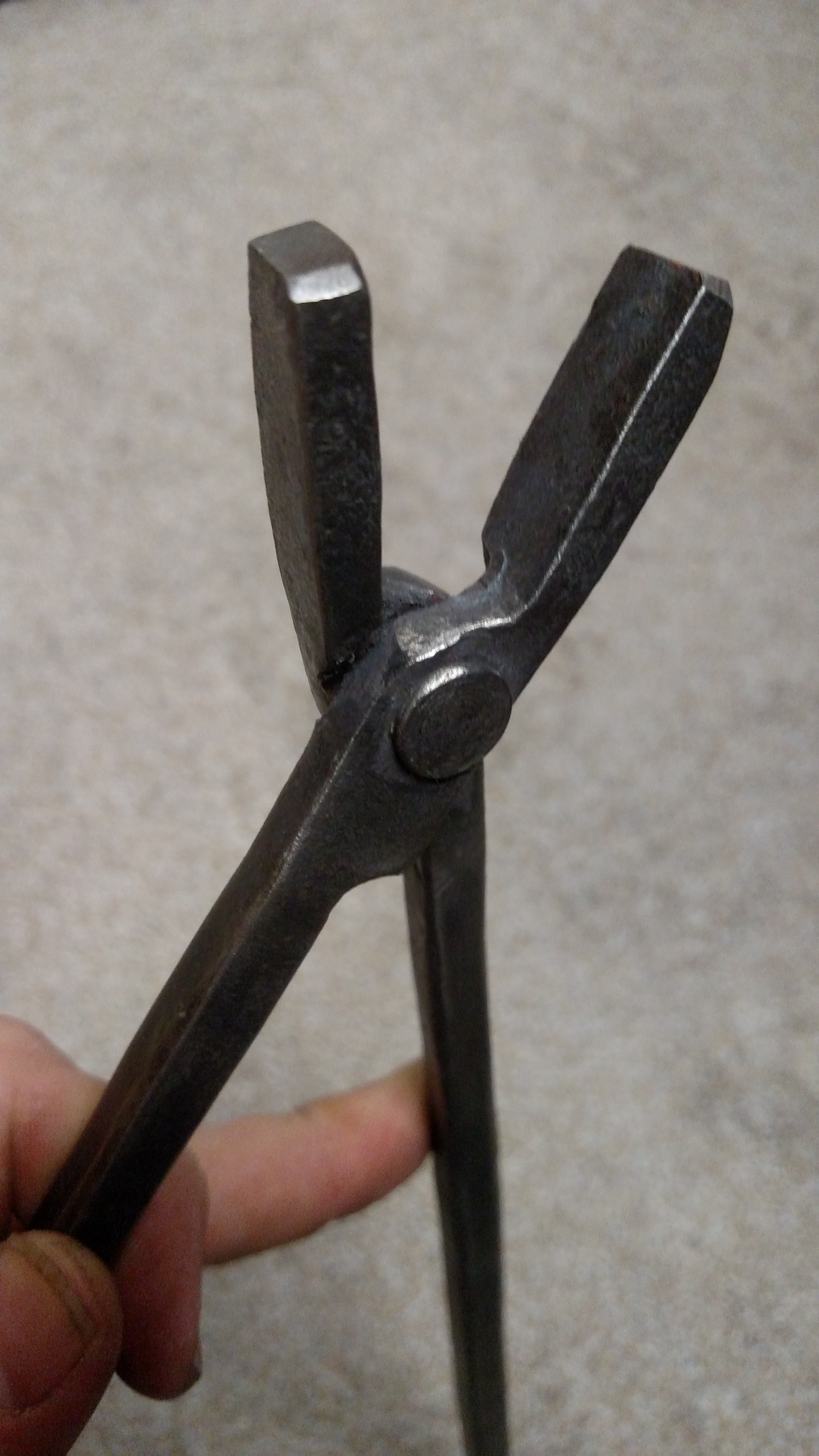

Hey guys I want your opinion on these. I've made about 15 pairs now, and I am still having an issue with the tongs having a little wiggle- it's not a lot, but even this pair while I hold one rein I can move the other probably 1/8" one way or the other.
When I rivet it I set the rivet, then open and close them until they are free moving, then put my material in the jaws and make it fit. I take another heat and go to the vise (while holding the 1/4" in the jaws) and adjust the reins, then I slightly tap the rivet 2-3 times to get it tightened back up, then free them up again with the open close motion. I also open and close quickly when they go in the quench bucket.

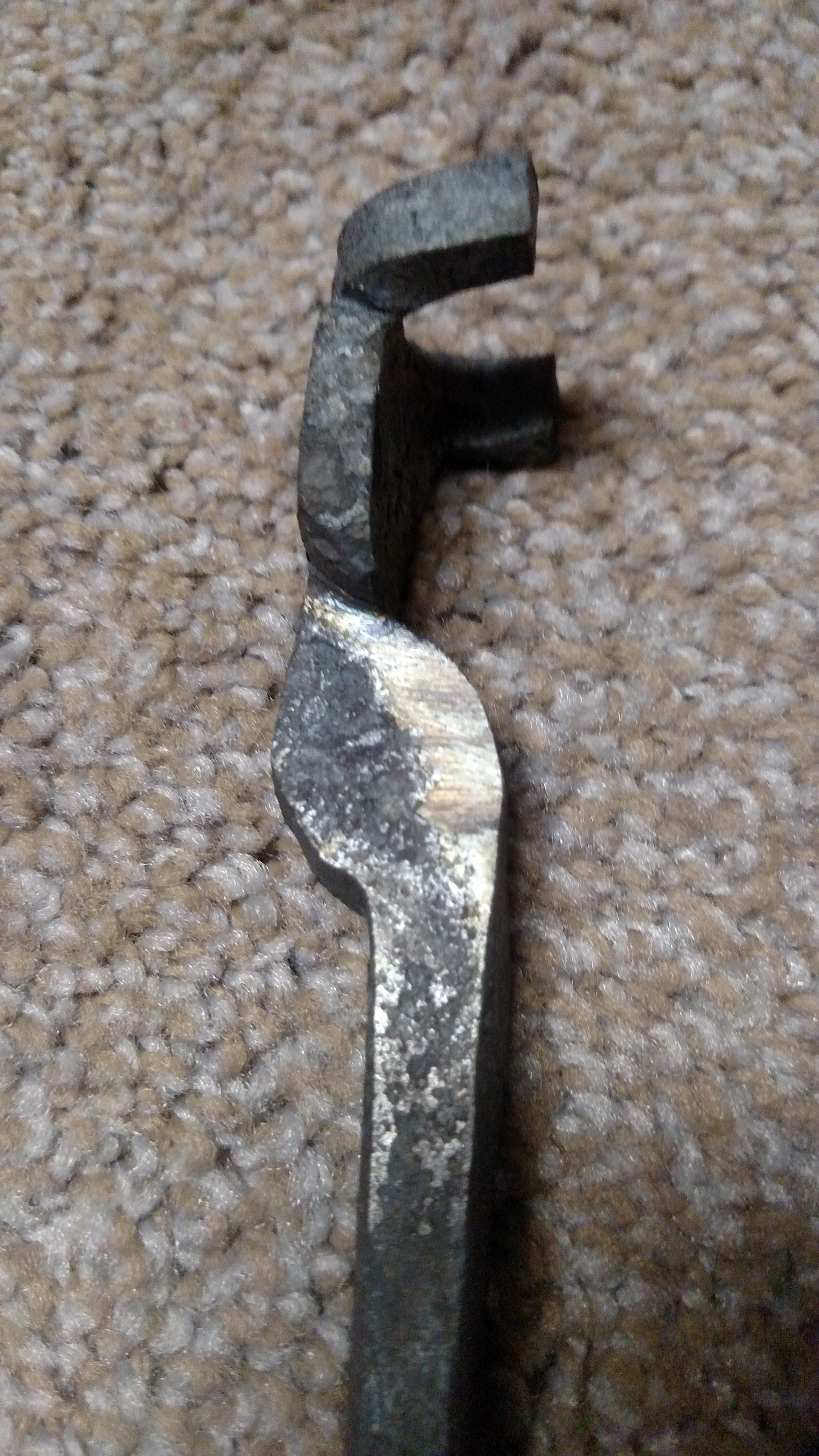

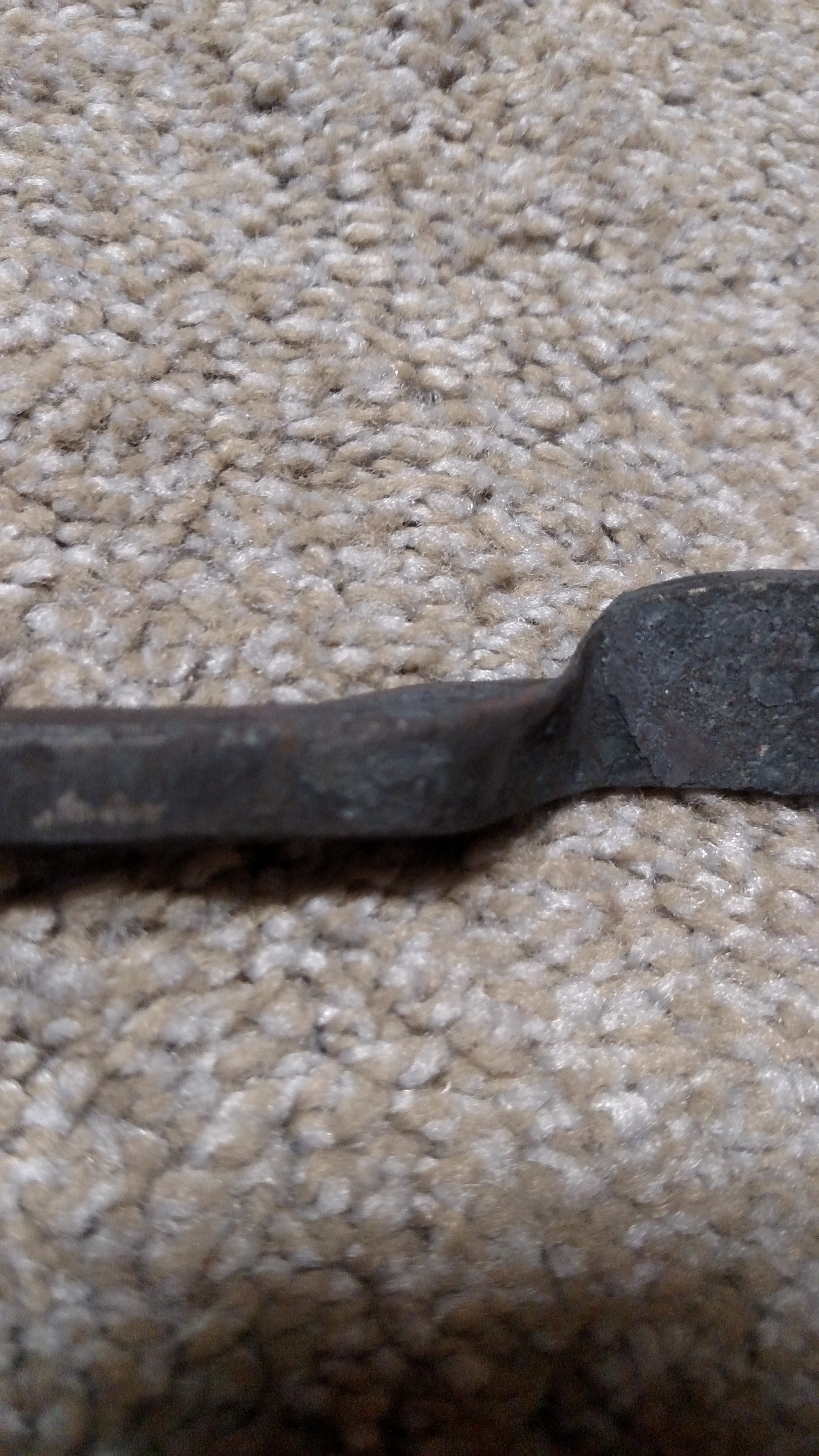

I included the last picture to show where I fire welded the rein onto the jaw portion. I forge the jaw and boss out of 1/2" and weld 3/8" square on for the reins, I'm wondering if the pitting shown in the picture is normal or if it can be prevented. I use borax as flux for the first 2 weld heats, I usually do a 3rd (no flux) just to clean it up and make sure there's no cold shuts. 'Sparkling' of the steel is pretty minimal when I take it out of the fire, so it's not like I'm pulling it out and it looks like a grinder hitting all 4 sides.
Any suggestions to help me get rid of the 'loose' feel (even tho it's not much) would be appreciated, as well as any other constructive criticism
Good looking Tongs. so the looseness is at the rivet? you can tap them cold on the anvil with a hammer on the rivet to tighten them usually.
A few of my tongs are like that, i think i drifted the hole a little too big.

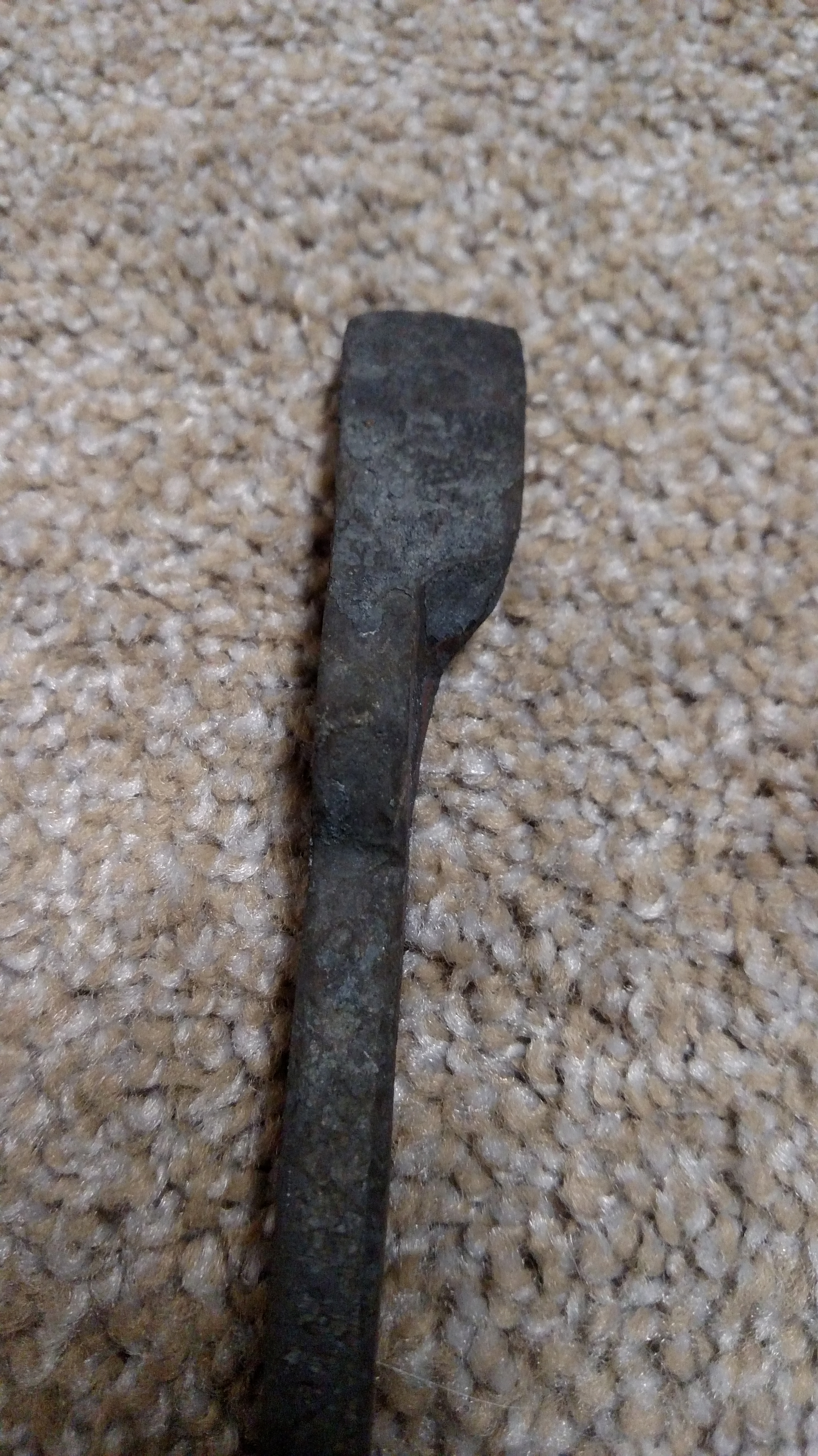

Hi Donniev,  Your last photo seems to show a "lump" on the matching surface of the pivot. I have always found that the flatter and smoother I can keep these surfaces, the tighter
everything fits together.
Another question: Did you cut a notch in the side you peined the rivet? A couple little chisel cuts in the hole the rivet gets peined on locks the rivet in the hole so it can't turn. This makes the tongs pivot on ONE hide and makes for a tighter fit. There's less wobble because the rivet only has to size itself in ONE hole when you work it after peining.
PVF's observation and tip are solid good ones. Where that little bump is is causing you to lever laterally against the rivet when you're freeing it up after peining, wallowing the holes out instead of just freeing and fitting them.
Match the bolsters and try notching the rivet hole on the peined side.
I have not tried to put those 4 cuts in the hole yet, I'll give that a try, thanks.
I'll also make certain that the boss area is as flat as possible, I had not noticed that

A boss that's not flat on the bearing surfaces probably is the problem, other than a hole that's too large.  Usually when you hot set your rivet it will swell up enough to fill the gap in the holes if the holes aren't too large.
I had a problem with a couple of tongs that were loose and wobbly like your's and I drilled out the rivet, flattened the inside of the bosses to a "perfect" fit and no 'mo wobble!
Getting nice clean flat bosses is a good use for a set hammer.
A few minutes with a file on the inside case of each boss. It should only be cleanup to smooth the mating faces since you've forged them pretty nicely.

I don't think there is much wrong with your technique/method that you are using, and using a flatter/set hammer would be beneficial.
My suggestion would be to use a different choice of material sizes, go to 5/8" square to form the jaw, and use 3/8" square or round for the reins. The 5/8" would better make 3/4" wide when you forge the first stepdown.
Then as you forge the next stage, you can bring it down to allow for a scarf to blend to the 3/8" bar after welding, upset and scarf the 3/8" bar to suit for welding.
The reason I advise this is that it is preferable to have the jaws at least as twice as wide as the reins, and the thickness of the boss to be 1/2 of the width of the jaw, (in this instance)
this puts the edge of the rein onto the centreline,  which then allows the reins to be in line with each other when in the working position,
In the picture, as you look down the reins you can see the tapering gap, which also throws the tongs out of line when in use, and tends to prise the pivoting area apart if you use a bar rack to support them when not in use.
Another minor coment, the boss does not need to be as long as it is in the pics, it would be advisable to put the rivet  in the centre not to one end as shown, again this gives more equal bearing area around the rivet, and reduces 'slop'.

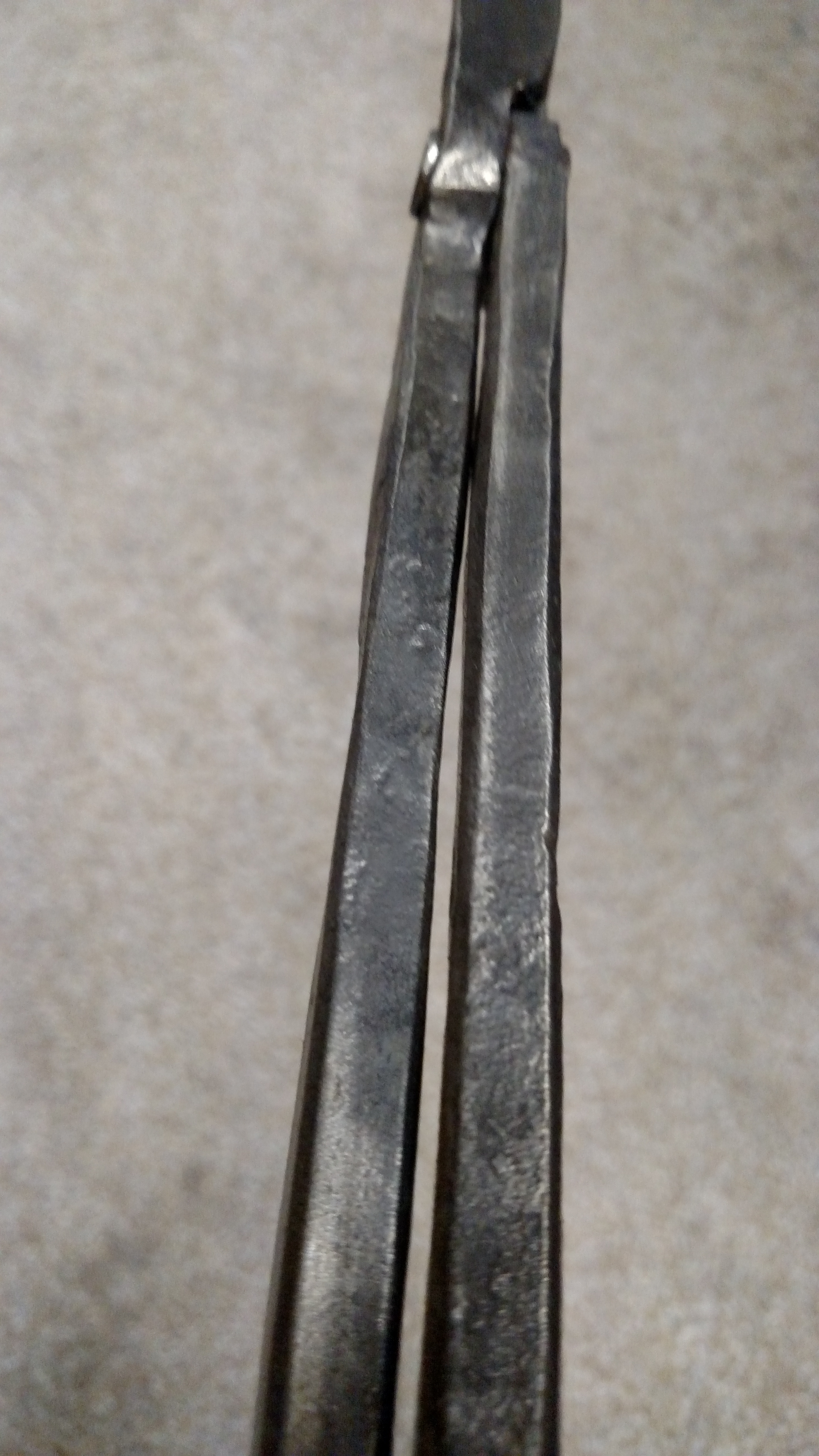

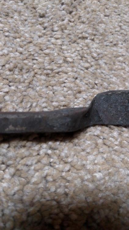

John thanks for the feedback. I was just out forging and got about 80% done with my next pair, but I ran out of coal. I made the boss area a bit smaller, and tried to make certain I had it laying flat, but as you can see, it was far from perfect. I think part of it was that I was using 5/8" instead of 1/2" (what I'm used to working with) I've never had that much metal obviously sticking out. The length of the boss has varied so far, I'm not measuring when I do the set down from the boss to the reins because I'm sure that the more pairs I make, the more it will become muscle memory.
I filed down the extra metal on the edge of the boss, so it should be flat now. Just for the heck of it I forged these just like a right handed person would, it really only changed how I was standing in relation to the anvil, and I'm sure that may have lended some help to the ugliness of em.

Muscle memory is fine, but it will come easier if you measure and mark at the start,
I think you will also find that as you forge items, you get a "natural flow" to what you are doing it becomes difficult when you try to consciously make two items identical, try making a few scroll ends and you will see what I am getting at,
No prizes for making it difficult for yourself, do what comes naturally. What you have there looks to be on the right track, take care with the 'ears' and forge them when hot, or they will crack and become a weak point.
