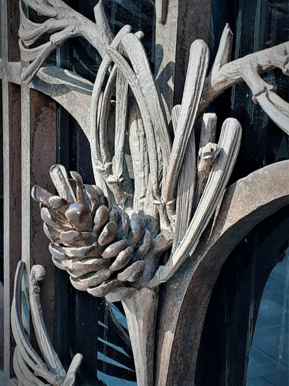

JHCC Posted February 16 Share Posted February 16 13 hours ago, Frosty said: silicon bronze no sweat Oh, really? <strokes chin thoughtfully> Also, don't forget how vigorously Edgar Brandt embraced the artistic possibilities of oxyfuel welding. Quote Link to comment Share on other sites More sharing options...
Frosty Posted February 17 Share Posted February 17 Yes, it welds surprisingly easily and even easier with a light sprinkle of Peterson's #1 blue flux. Frosty The Lucky. Quote Link to comment Share on other sites More sharing options...
