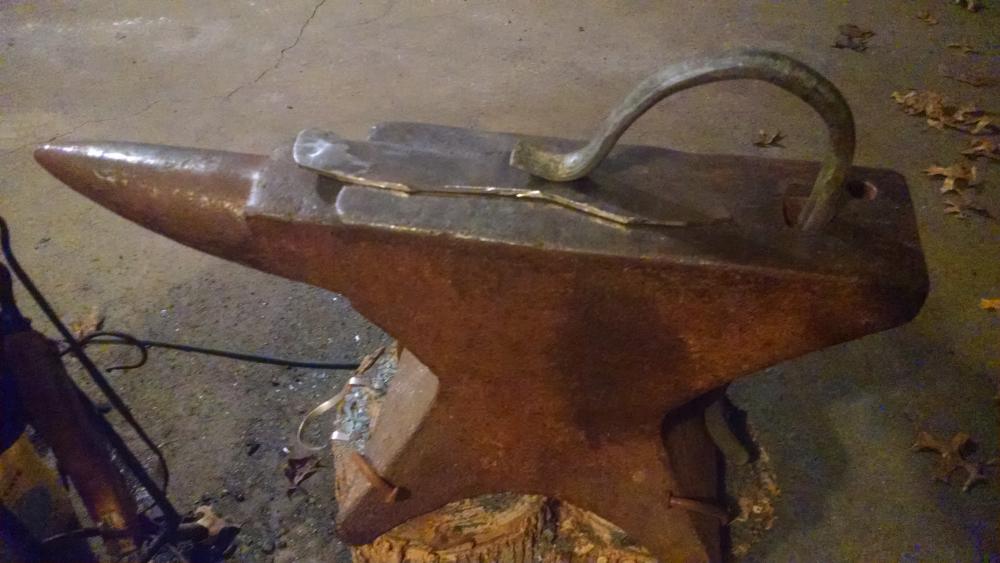

It works!
I had a bear of a time trying to get a square corner on the thing, but that's how the cookie crumbles.  It's functional and has a nice line to it, so I'm happy.  The next one is going to be a bit heavier in the arm cross section.  I might just weld on a piece of leaf spring if I have any left.
A good bit of exercise.  Now to make some more......

Here's the one I threw together a while back. Like so many things meant to be replaced later, it's still going strong.
(One detail: make sure the underside where the holdfast touches your workpiece is smooth. Any burrs or ridges can really mess up a finished surface. Don't ask me how I know this.)

Now that I have a proper bottom swage, I'm hoping the next ones come out better.  I'm a huge fan of that square corner.... just wish the steel would cooperate with me!IMG_3792.thumb.jpg.3f9c8cd074468bb2fd0ec
