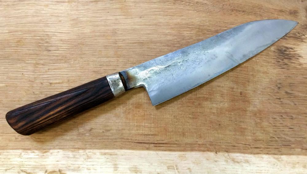

Realizing I can always improve and it's good to have further instruction. I took a class with Arnon Kartmazov weekend before last. I was not able to make the third day so Arnon made the handle and Nitzan Lillie did the stainless steel ferrule. I forged the 1095 blade and Arnon sand blasted it. Hardened in oil at 1450F, tempered in oil at 350F twice. Clayed spine before hardening. Handle is torch toasted hickory, then sanded and waxed.
Is that a 7 inch blade Rashelle? its a bit hard to tell the dimensions on a photo.

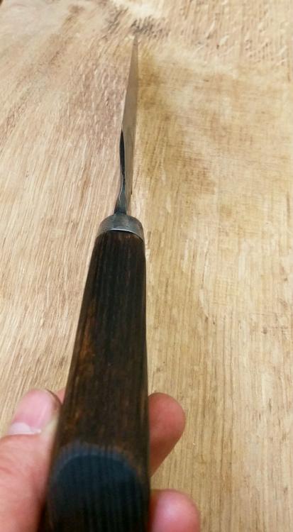

The angle of the spine to the blade looks perfect. My knuckles hit the cutting board with western style chef knives so I have to cut over the edge of the bench.
that bunka/santoku shape is so much better. I can almost squeeze a pencil between my fingers and the board.
it looks great, I could stare at that for hours.
From the heal of the bade to the tip in a straight line, disregarding the slight curve is 7 5/8". Thank you yahoo2. I grin when I look at it even at pictures of it. Prior to this my favorite kitchen knife was a french chef knife followed by a small craft knife I demo as a first knife for youth students. After the class I went and made a small Japanese hammer, the tongs for holding each end of the knife, and started one of those wooden blade straighteners for just in case.
Oh Yes!  That is a great Knife!  Great size.  Would be right at home in any woman's kitchen.

I learned a lot of new things during this class. For example I never realized that the Japanese chef knives were suppose to have the fullered grooves at the base of the blade for finger holds and that the bevel at the base is thicker for chopping where the bevel at the tip is longer and thinner for slicing.
Nice shape to that Rashelle, close to and better then my favorite kitchen knife, I'd say. If I ever get the knife bug I'd like to make one like that.
Cool, Steve and you're welcome. We put the fullered groove in with the cross pein. Feels nice and lightens the blade. My assistant at work (who's on this site somewhere), wife's a chef and she liked the lightness and feel of the blade. I might of mentioned to her now he will need to get a good belt sander, for himself to make chef knives with. She agreed.  Heehee.
Thank you Daswulf. I plan on making more so I can remember and ingrain it into myself. Definitely a style I want to remember, same as for the forging order of it.
