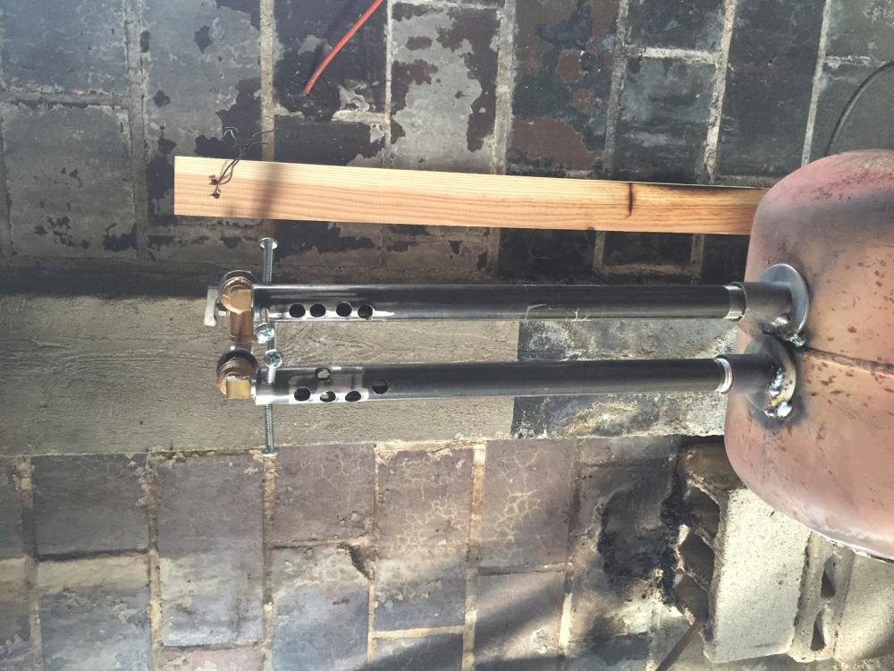

My son and I built this forge from some videos we found on youtube. It will heat metal fine. Its just not hot enough to weld anything. I have seen some people say a one burner forge can weld steel, but our is two burners and it still doesn't get hot enough for that. Take a look and let me know what you think the problem might be.

Your Mig tips are way too deep in your burner tubes to get an effective draw of air - your design looks like the Dave Hammer design (kind of) but his gas tip is visible from the air intakes.  Your mig tips seem to be almost inside your forge.
You also didn't specify the insulation used, or if you're using any reflective coating.  Are you using a regulator?  What gas pressure are you using?  If you have a low pressure regulator suitable for a propane grill, you're not getting enough gas.
It also appears that you're using white teflon tape - this is a bad mistake if you're using propane.  Yellow tape is rated for propane, while is for plumbing with water.  Your front door is really big too.

the problem is that your rows of holes create massive turbulence. Some turbulence  is needed for good fuel gas and air mixing; that would be a little turbulence, not massive amounts, which is like trying to get good performance out a car with the hand brake engaged. the other problem with a row of holes is that nearly everyone who takes this rout places their gas jet near the back of the rows, instead of mounting the jet on 1/8" pipe, so that they can slide it forward and experiment to find where its best position might be (probably in the middle of the forward holes). Probably the easiest fix at this point would be to build two Frosty "T" burners and screw these easily constructed powerful burners into the forge, in place of those poorly designed and way overly long burners you are suffering with at present. But, don't throw you present burners away; instead offer them to the first person who tells you how wonderful the design looks on YouTube. You can save them some wasted effort and money.
I think I have experienced that turbulence you are talking about. The flame can be erratic at times. Probably due to the air holes.
The tips aren't into the forge but they are deep into the pipe. It makes a nice blue green flame. The weird thing is that the area right below the flame isn't nearly as hot as the area around the flame.

The door is big but it closes and there is a much smaller hole that we use to put the metal in and out. You can't really see that from the photo. The regulator is one I got from amazon. It's adjustable, but it might not be as adjustable as needed. I'll look at it and see if there is any marking that indicate the flow.

The work and expense you've invested in that forge probably looks like a waste right now; it isn't. In fact your problems are minor and easily fixed, IF you address them one at a time.
You said "It makes a nice blue-green flame. The weird thing is that the area right below the flame isn't nearly as hot as the area around the flame."
A blue-green flame is a seriously reducing flame, which is shown by the fact that it has to finish combustion elsewhere in the forge interior; this is why the flame impingment area is cooler than its surrounding area. The area where the flame impinges should be hotter than its surroundings; not cooler.
To prove my point, light up the forge, and then walk over to the light switch. Turn off the switch and watch all the pretty blue carbon monoxide rich flames exiting out the exhaust opening.
Your next step is to build the Two "T" burners ans screw them into the forge; the other changes you need to make are simply add-on work, but I'm not giving any more advice until you act on this.

Over the ceramic wool you should put casting. That will stop e wool from flaking off and going in your lungs. It should also get you to welding heat. You can also put an ir reflective coating over that which will save money and be more efficient in heating your steel. Your burner might be wrong too, or you are running propane at too low of a pressure. Hope this helps
