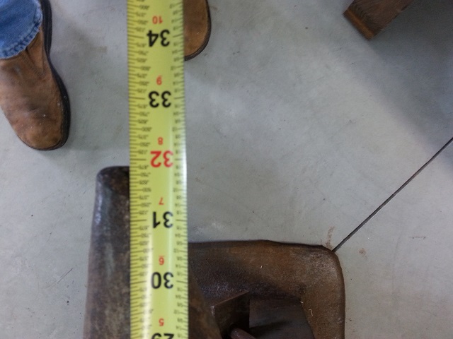

jerryt Posted February 17, 2016 Share Posted February 17, 2016 A fellow about an hour away contacted me about this anvil. He thinks it came "from the railroad" to a family which sold it to him years ago when they sold their farm. No identifying marks that I can see from the pictures he sent. He thinks it weighs 4-500 lbs. 5" wide x 32 " long. Hardy is 1.25" square. Came to him on the damaged cast iron base. I see a large 6 and a small 1 in picture number 5. I'm trying to determine what to offer for it. He has a smaller anvil that meets his needs and is willing to part with this one. I sure would appreciate some help in identifying this and placing a value on it before I go to look at it. Thanks, Jerry Quote Link to comment Share on other sites More sharing options...
Frank Turley Posted February 17, 2016 Share Posted February 17, 2016 If the '6' is stamped under the horn side of the waist, it may be a Hay-Budden. I don't think other anvil manufacturers put numbers there. Hay-Buddens are highly valued and highly coveted anvils. Quote Link to comment Share on other sites More sharing options...
Crazy Ivan Posted February 17, 2016 Share Posted February 17, 2016 2nd for a Hay Budden. Looks just like my old one. If there is an hourglass indentation underneath the feet, it's almost definitely a Hay Budden. Quote Link to comment Share on other sites More sharing options...
jerryt Posted February 17, 2016 Author Share Posted February 17, 2016 Frank, I went back to him. The "6" is on the waist under the horn. Now to find some info on the various versions of Hay-Budens in the larger sizes. Thanks. Jerry Quote Link to comment Share on other sites More sharing options...
jerryt Posted February 17, 2016 Author Share Posted February 17, 2016 Thanks Frank and Ivan. What is your assessment of condition (given the rust-covered surface) and is there a place where I can find out the different sizes Hay-Buden made? Jerry Quote Link to comment Share on other sites More sharing options...
Frank Turley Posted February 17, 2016 Share Posted February 17, 2016 The face can be cleaned up with a disc sander. The chunks out of the step and heel shouldn't be a problem. Hay-Budden started in Brooklyn, NY, beginning about 1890. They made anvils 400, 500 pounds, and more. The book "Anvils in America" by Postman talks about the history. $1.00 a pound would be a super deal. If it were me, I would finagle up to $2.50/pound...less if possible. Quote Link to comment Share on other sites More sharing options...
arkie Posted February 17, 2016 Share Posted February 17, 2016 jerryt, Look at the front foot (under the horn). You may be able to make out a stamped serial number. Looks like a HB to me too. Quote Link to comment Share on other sites More sharing options...
Direwolf Posted February 18, 2016 Share Posted February 18, 2016 Hi Jerryt, definitely a Hay Budden as the others pointed out.. As to the size, it is not 400- 500 pounds, the combined weight of anvil and stand is though. I have a number of them from 50-400 lbs, I quick measured a 310 lb one it is 34 inches x 5 inch face, with 1.25 hardy hole, and a 375 lb that is 36 x 6 inch face, 1.5 hardy, that matches Mr Postman's table in Anvils in America which gives the dimensions for a 300 lb anvil as 5" x 21" face, 13" horn and 1.25" hardy. So I would feel confident to estimate the one you picture in a range from 275 to 300 lbs, perhaps a little more or less. The logo and weight are always stamped on the side you look at if you are standing with your right hand on the horn and left on the heel as in the picture third from the top, the weight will be below the logo. They are great anvils some of the best made. As Frank pointed out it would clean up nice. Due to the rust you may not be able to make out the logo or weight but a little wire brushing might reveal something. If you go look check the rebound with a ball bearing preferably 1-inch or tap around on the face with a hammer. I hope this info helps you. Quote Link to comment Share on other sites More sharing options...

jerryt Posted February 18, 2016 Author Share Posted February 18, 2016 Update: I looked at it and struck it repeatedly. IMO, the table was not consistent in rebound or ring. No obvious damage but I was just not impressed with the sound. Maybe that is characteristic of Hay-Buddens (if that is what this anvil is). I've never seen a H-B before. There were no other identifying marks. The stand is open in the center so I could feel the bottom. No hourglass recess. Totally flat on the bottom. Anyway, given that the brand is not clearly determinable, I felt he wanted to much for the anvil (started at $1,000 and came down to $750). I went as high as $600. No deal. Quote Link to comment Share on other sites More sharing options...
ThomasPowers Posted February 18, 2016 Share Posted February 18, 2016 If the anvil is tightly fastened down it won't ring. The rebound is of grave concern. Some of the early HBs had a very shallow rim to them that have been known to wear flat over a long life. I have one like that, you almost have to dust it to see the hourglass. That face looks more like the one on my Trenton though---thickness Quote Link to comment Share on other sites More sharing options...
jerryt Posted February 18, 2016 Author Share Posted February 18, 2016 Crap! Lost my post again!!! I'm not a typist. Anvil is tightly secured to the base and base thickness is about 3/4". Rebound varied, particularly near the Hardy. The flat of the horn had no rebound at all. Made me wonder if the top is tool steel and body is cast, similar to Fisher. My Fishers have the tool steel extended from the table fully across the flat of the horn step and across the top of the horn. I don't know how the H-Bs were made. Quote Link to comment Share on other sites More sharing options...
ThomasPowers Posted February 18, 2016 Share Posted February 18, 2016 No; A lot of anvils have an unhardened horn; Fishers are one of the few that steeled the horns. Any buzz when checking rebound? (any denting too?) Quote Link to comment Share on other sites More sharing options...
jerryt Posted February 18, 2016 Author Share Posted February 18, 2016 No noticable buzzing. I used his small 16 oz ball peen. Did not strike hard enough to dent. You think I may have made a mistake walking away at that price? Quote Link to comment Share on other sites More sharing options...
ThomasPowers Posted February 18, 2016 Share Posted February 18, 2016 As I'm averaging about US$1 a pound for the last 1000 pounds of anvils I have bought I would say no. I've learned to walk away without a backwards glance if I think the price too high. Sometimes I'll leave my card if I think they have just been misled by outrageous prices on the net; but may come to their senses. Getting started you may not profit from a large anvil as much as a small one---easier to haul around until you get a secure dedicated shop set up and truthfully; I have more hours smithing on my 93# A&H than on my 515# Fisher---though every minute on the Fisher reminds me why the big ones are *nice*---and why Fishers are particularly nice! Of course I am notoriously cheap and hunting stuff down cheap is how I enjoy time off. Quote Link to comment Share on other sites More sharing options...
