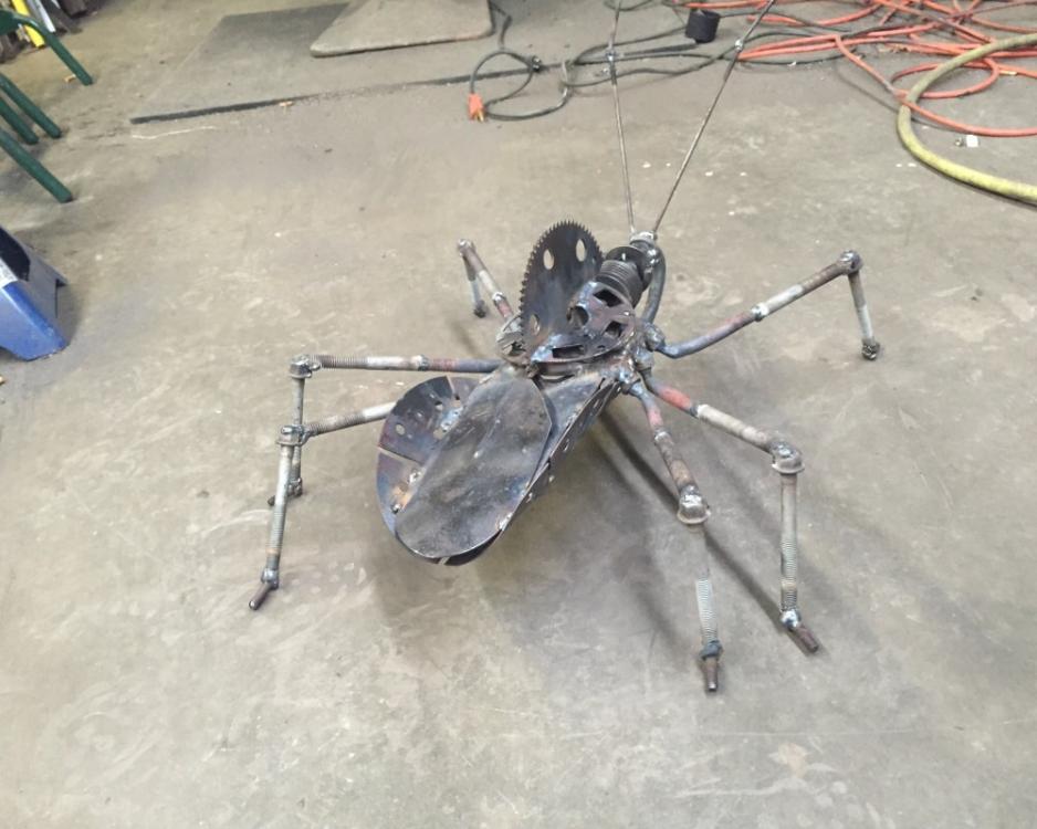

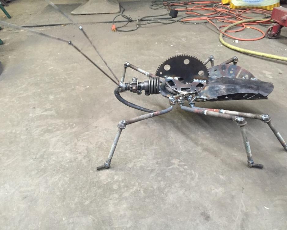

Daswulf Posted January 27, 2016 Share Posted January 27, 2016 Assassin bug. Head is on a spring and moves have a little cleanup to do but I really wanted to post it. Quote Link to comment Share on other sites More sharing options...
ausfire Posted January 27, 2016 Share Posted January 27, 2016 Das, that is amazing. You have the proportions just right. That looks like a bendix drive from a starter motor for the head, and what an impressive feeder tube/sting. That thing could really give you a hurry-up. I see a tile cutting blade and a blade from a radiator fan (or is it a garden trowel?) in the shield section. Anyway, great choice of components ... I really like that! Quote Link to comment Share on other sites More sharing options...
Daswulf Posted January 27, 2016 Author Share Posted January 27, 2016 Thanks Aus. Yup the head is the drive from a starter motor. Wings are fan blade. The belly portion and sides of the back spine are from a clutch plate with the nasty part removed. And the center spine is the gear from a manual window regulator. I'll get more pictures once it's cleaned up. Quote Link to comment Share on other sites More sharing options...

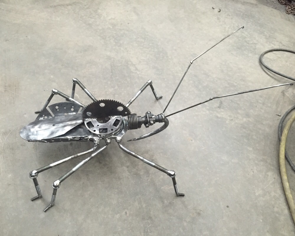

Daswulf Posted January 28, 2016 Author Share Posted January 28, 2016 Cleaned him up a bit. A couple tweaks. I was worried the antennae were too sharp so I scrolled the ends. Didn't mention before but the head is on a spring and with any movement it bobs for a while. I had wanted to use springs on other pieces to make movement but hadn't. This one was already set up with it and I like the results. Also it's 31" long with the antennae and 18" wide and roughly 12# I think I might let this guy rust a bit to add some color then seal it. Ive read that scrapartoz used a saltwater spray to do a controlled rusting, then water spray and once he liked the results used fish oil. While I don't think I'll be using fish oil on stuff anytime soon ( probably boiled linseed oil) I'm curious what anyone else has done for a controlled rust and sealant. Other then a store bought chemical specifically for it. Would like home brew remedies. Or, what do you think as it sits? Quote Link to comment Share on other sites More sharing options...
ausfire Posted January 28, 2016 Share Posted January 28, 2016 Looks great cleaned up, Das. I use a clear finish for mine if they are indoor pieces, but for outdoor work a coat of Rustmasters works well. You can rust them quickly with peroxide if that's the effect you want. Another scrapologist I know uses a 50/50 mix of marine varnish and Penetrol. I wondered about that window winder cog on the assassin's back. It didn't look right at first because our bugs don't have that. However, on doing some research I found that you guys have an assassin bug known as a 'wheel bug' and it does have that crest on its back! Nice attention to detail there, Das!! Quote Link to comment Share on other sites More sharing options...
Daswulf Posted January 28, 2016 Author Share Posted January 28, 2016 Thanks for the info Aus. Yup, the ones in my area have the "wheel". That's the one i know of. while googling them i did see many different versions. Some even colorful, but this is the one i'm used to. so what do you think? should i rust it to add color or leave it steel? Quote Link to comment Share on other sites More sharing options...
ausfire Posted January 28, 2016 Share Posted January 28, 2016 Our assassin bugs are orange. You can see 'em coming to get ya! I like the steel finish, but it's up to you. Is this one a keeper or for sale? If you're like me, I want to keep all of them, as they all have their own character. With an exhibition coming up though, I am obliged to make some for sale. With your assassin bug I would keep it shiny steel with a clear lacquer and give it an indoor location. If it goes in the garden it will rust anyway with time. Quote Link to comment Share on other sites More sharing options...
Daswulf Posted January 28, 2016 Author Share Posted January 28, 2016 Ours blend in pretty well with their darker grey color. They almost have a touch of brown. I'm like you in that I want to keep them all too, but I'm willing to let them go to a new home. Aside from commissions, I'm going to keep at it and maybe try to show at an arts festival in Pittsburgh this summer. I think for the time being Ill leave this one raw and keep him indoors until I decide. Quote Link to comment Share on other sites More sharing options...
