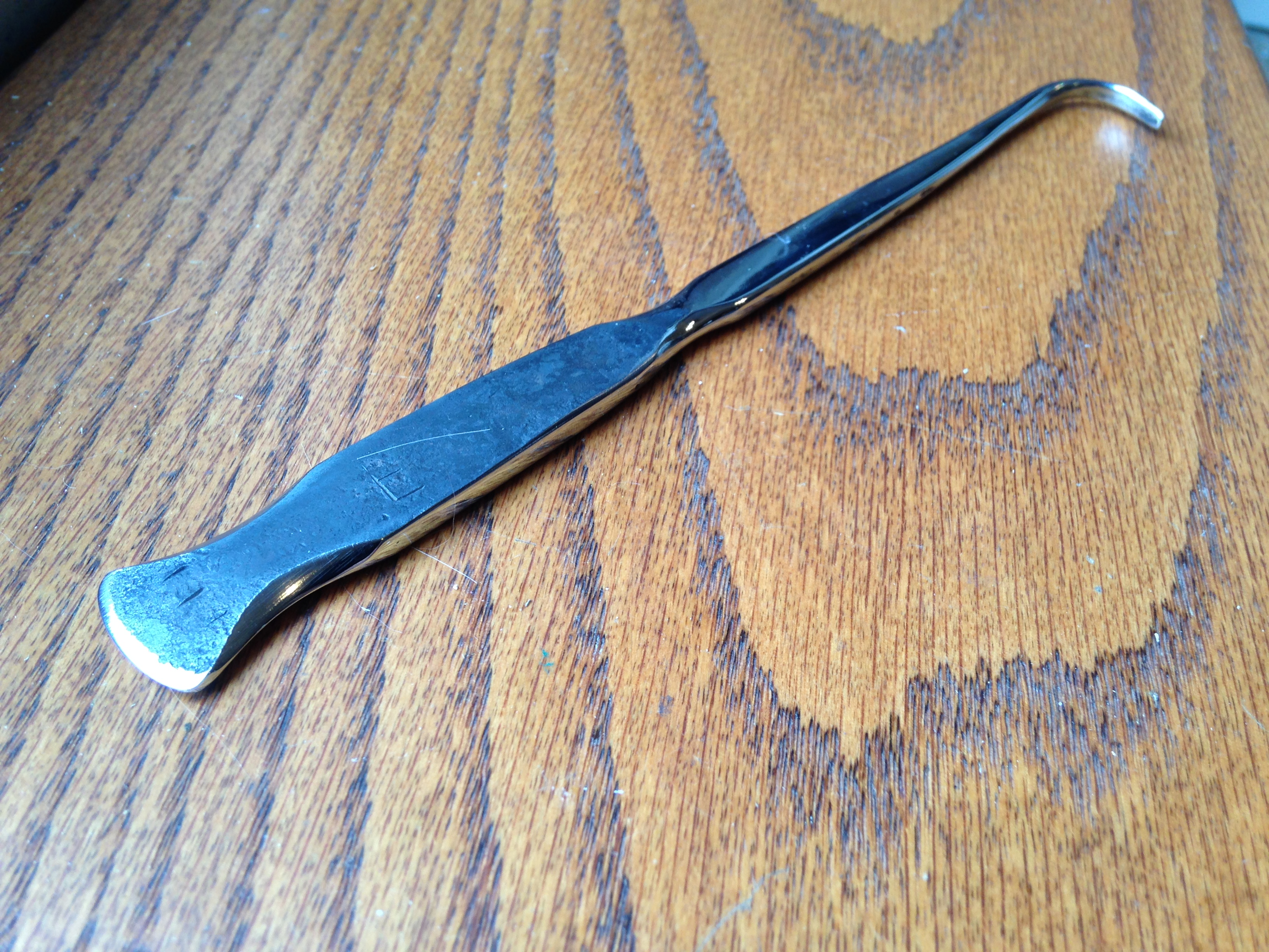

Show me your.... aneurysm hooks??
I'm not a gambling man, but I'm almost willing to bet this'll be a first here on the forum lol.
An aneurysm hook is an instrument used in the embalming process. I made this one out of some stainless. Intentionally left the flat of the handle "forge finished", as my friend Raymond Richard calls it (maybe everybody else does too, but I first saw and heard it from him). I considered stamping a name on it, but then decided against it but you can see where I messed around with the "E". It's just a prototype.

Pretty nice piece, well done.  I wonder what the market's like?

Thank you Frosty! The Egyptians did do just that, with a somewhat similar instrument. This one is used for blunt dissection on one end and then the hook end is used to "raise" arteries and veins.
I'm not sure what the market is like but I do know that most of the stuff available is flimsy and mostly made overseas. This piece is pretty heavy duty compared to anything I've seen in my 25 years in this business. I showed it to a couple of colleagues already and they were willing to pay me $50 for one. I tend to think a lot of funeral directors/embalmers are content with the $25 hooks they get from their chemical suppliers, but who knows. This one took me 2 hours from lighting the forge to wiping the rouge off, I'm sure with some practice I can get one done in an hour.
$50 is pretty reasonable and 2 hrs isn't bad at all, SS is harder to work than most steels. You need to get a good touch mark on it, it has BIG bragging rights. Morticians don't have a lot to impress each other with at get togethers. Not counting creepy stories that is, they're a black humored trade you  know. So, good custom made mortician tools might be a gold mine.

cool, I'd add their initials like Glenn suggested, you could have some fun with file work on the corners, but that may be overkill.

If I can whittle that down to an hour, I'll gladly earn $50/hour during some of my "down time". Yeah, the stainless is noticeably tougher to work than mild. I'm still at less than a dozen times at the forge and SOMEHOW I've wound up working stainless more than half the time, which was NOT the original plan ;) I don't mind the tough to work part, it's the rapid cooling that eats up time and gets frustrating. I bet I could make one of these out of mild in a fraction of the time.
As far as a finial, I think that's a great idea. The only hurdle is that both ends of this particular instrument get used, but I could easily add a skull and bevel down the edge of the crown of the skull so that it can still be used for blunt dissection...

Add their initials and personalize it for them.
Yes, definitely! In fact the inspiration to me for making these was so that I could personalize a couple and give them to the guys who work for me as part of their xmas gifts, but it looks like it's going to be xmas in January this year. Or February.... March?
So put the anvil closer to the forge for working SS.
