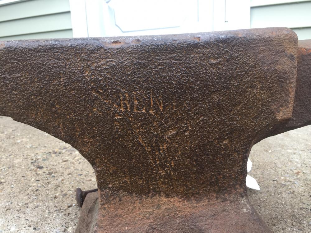

FrankS Posted January 3, 2016 Author Share Posted January 3, 2016 here are the markings Quote Link to comment Share on other sites More sharing options...

Frozenforge Posted January 3, 2016 Share Posted January 3, 2016 Welcome to the forum. Im sure there is a group in your area that you could get with for an introductory experience. Looks like S/N is 56456 which would have been made in 1905. It appears to be in excellent condition and ready to be put to use! Quote Link to comment Share on other sites More sharing options...

FrankS Posted January 4, 2016 Author Share Posted January 4, 2016 I've read that some Trentons were imported from Germany?, and some made in Columbus Ohio. Is this so? How can one tell? Here's a pic of the underside. Quote Link to comment Share on other sites More sharing options...
wd&mlteach Posted January 4, 2016 Share Posted January 4, 2016 According to Anvils in America (Postman, 1998), early Trenton anvils were most likely imported from Europe. Postman suggests that these anvils could have been produced by German or English makers. I would agree as I have owned two early Trenton anvils and they were different. One of them had all of the characteristics of a Peter Wright, except for the name and and stamped stone weight. The other did not, it was almost more generic and plain. I recommend that you pick up a copy of the Postman book as it is wonderful. The book will explain the manufacturing process of the domestic Trentons and several other popular anvils. The book will also clear up most of your other questions related to your anvil. Quote Link to comment Share on other sites More sharing options...

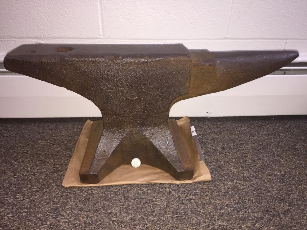

Bayshore Forge Posted January 13, 2016 Share Posted January 13, 2016 I also recently acquired a Trenton. I'm no expert but I think mine is of European decent, as from what I can tell mine does not have the same hourglass shape in the bottom. Pics below. Quote Link to comment Share on other sites More sharing options...
Black Frog Posted January 13, 2016 Share Posted January 13, 2016 Bayshore, yes your Trenton is from Germany. It was forged in multiple pieces, if you look at the lines on the underside of the base you can see the core block where the feet were forge welded on. Cool stuff! Quote Link to comment Share on other sites More sharing options...
