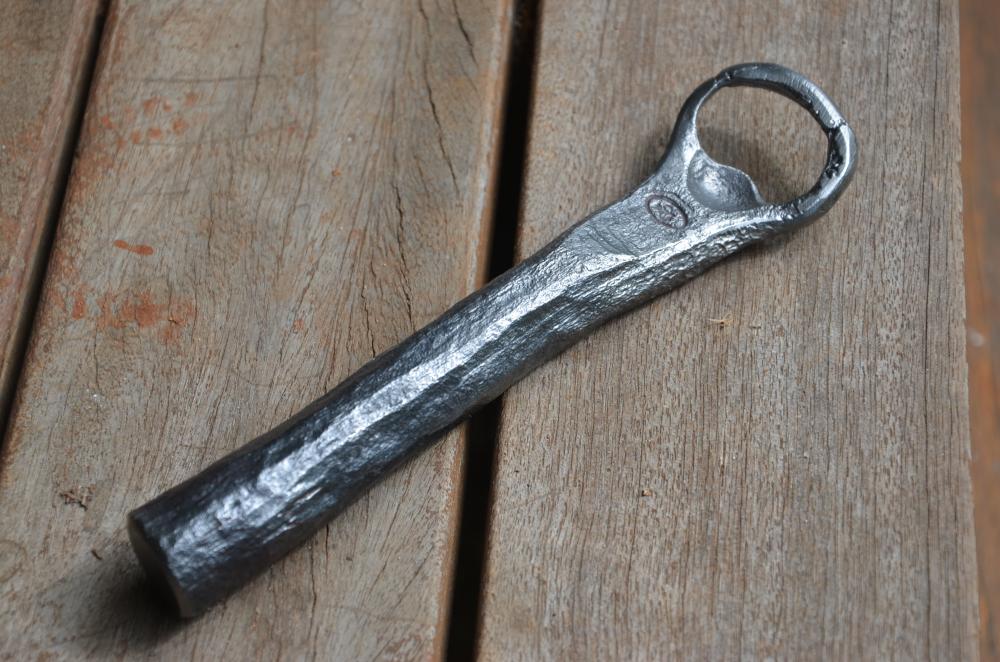

ausfire Posted January 1, 2016 Share Posted January 1, 2016 I have many failed attempts as forging a wrought iron bottle opener. Sometimes I barely get past the first punching before the iron splits and cracks, even at sparky heat. Today I finally managed to get a bottle opener to completion that actually works. Made from a 7/8" bar, it's scruffy at best, and you can see where it almost gave way in the loop. But it's as close as I can get. I really want to forge a good one for two reasons: I've come to like the rough, laminated, wood grain lustre of the wrought, and secondly, I have truck loads of the stuff. Any ideas on how to forge a better looking loop? (Using side blast charcoal forge) Quote Link to comment Share on other sites More sharing options...
DSW Posted January 1, 2016 Share Posted January 1, 2016 I'm thinking the issue has to do with the direction of the "grain" running. I'm wondering if instead of punching/drifting, if you did a wrap and weld, then opened up the "loop". That way the grain is always wraping the loop rather than being cut by it. Quote Link to comment Share on other sites More sharing options...
ThomasPowers Posted January 1, 2016 Share Posted January 1, 2016 What DSW said. Practical Blacksmithing by Richardson written in the wrought iron transition era has several threads on how to avoid punching and drifting wrought iron and as DSW mentions welding is a common method of making a hole in WI. Besides which a good weld could be a decorative feature---perhaps not dressing it to be invisible but leaving it proud? Quote Link to comment Share on other sites More sharing options...

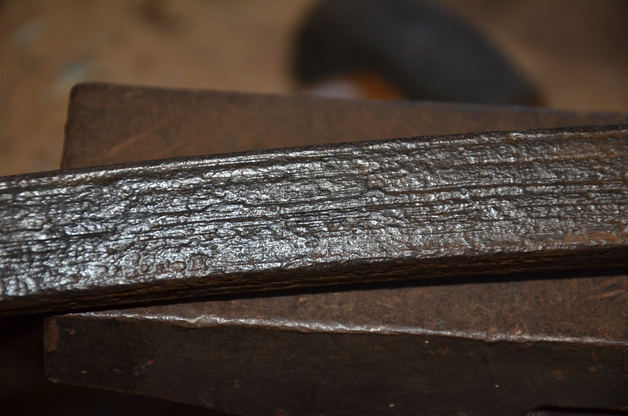

ausfire Posted January 2, 2016 Author Share Posted January 2, 2016 I have never spark tested it, but just look for the woodgrain effect. Like on this old piece off a buggy:: Quote Link to comment Share on other sites More sharing options...
arkie Posted January 2, 2016 Share Posted January 2, 2016 That looks like wrought for sure. Do you have a spare piece that is say, 1/2" round or square. Cut across one end about halfway, bend it back over in your vise and, if wrought, you'll see the fiber structure. If it's modern steel, you'll see a crystalline structure. Quote Link to comment Share on other sites More sharing options...

Alan Evans Posted January 4, 2016 Share Posted January 4, 2016 As far as working the bottle opener and preventing the cracks... You could either work two at a time (head to head) so the strain was less likely to cause any delamination or punch burst out when you punch the holes...maybe even punching the holes at right angles to one another so that the pressure was not trying to cause the fibres to part in the same plane, then cut them apart after punching. The normal way though when working wrought iron is to take a welding heat before you start and consolidate the end grain where it has been cut...this was "usual practise" when the main cutting system was a hot chisel or hot or cold set. Of course wrought-iron comes in many different qualities so maybe try some other sources. I seem to remember that the best was "triple crown" which had gone through the shingling hammer and rollers three times cutting and stacking the short lengths into a lump which was then fire welded together and which meant that any hot short/sulphur inclusions were only on one of the fibres, and surrounded by sound metal. You don't want to work it sparkly, but white hot is good. (hot as you can get without sparkles) Alan Quote Link to comment Share on other sites More sharing options...
ausfire Posted January 5, 2016 Author Share Posted January 5, 2016 Alan, thanks for your comments. The head to head method, working from the centre of the bar sounds feasible. It would certainly help prevent the breakout on the top side of the hole. Might take some practice! I'm not sure about the quality of the wrought. The old rail spikes seem to have finer laminations than the big 3/4 bolts. Anyway, I'll keep trying - white hot but not sparkly. That's a very fine line! Quote Link to comment Share on other sites More sharing options...
Alan Evans Posted January 5, 2016 Share Posted January 5, 2016 If either of the above methods don't solve the problems....As you know the easiest fire weld to do is a chain link, the scarfs hold themselves in place so all you have to do is get the temperature correct and tap it together. You might consider making this style of ring ended bottle openers, by splitting the end of the bar and forming a ring on the end by fire welding in the same way as you would scarf and weld a chain link. If you are looking for a lump in the middle to act as a hook on the bottle cap you could split the bar into three. Cut the centre leg short, and form the outer two legs into the ring and weld together. Alan Quote Link to comment Share on other sites More sharing options...
