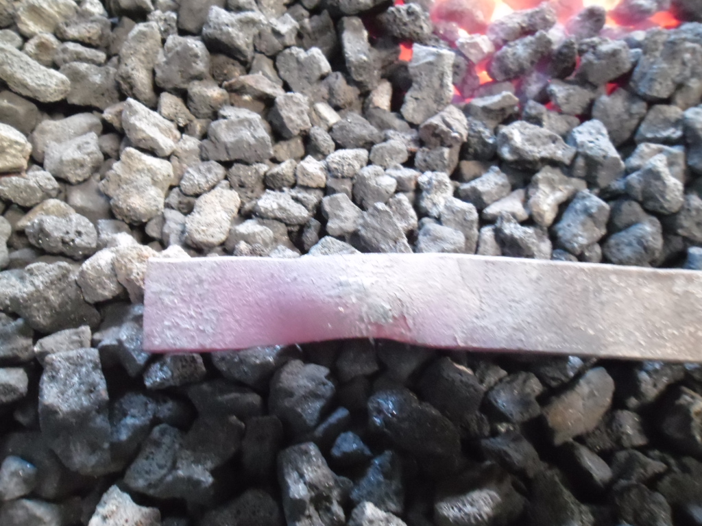

the iron dwarf Posted November 21, 2015 Author Share Posted November 21, 2015 drifted a hole in some 25mm square ( 1" ) today Quote Link to comment Share on other sites More sharing options...
the iron dwarf Posted November 22, 2015 Author Share Posted November 22, 2015 here is the tool I made for it Quote Link to comment Share on other sites More sharing options...

the iron dwarf Posted December 23, 2015 Author Share Posted December 23, 2015 waiting for vids to be posted, measured speed with 3hp 200 bar powerpack at least 32mm a sec I later found it was low on oil and it got faster after that, next vid will show speed when my friend gets time to post it.. dont know the GPH of the powerpack, it is one from my geka minicrop I try to set the stroke so the tool is not far above the work to speed things up so some strokes are less than a second on the downstroke. cylinder goes to 250bar but at 200 bar I get just over 10 tons so 12.5 or 13 tons is quite likely and within specs for the cylinder. I dont have much time free to experiment and need to work out what it can do and how to make tooling for it, I did make a hole through 25mm square as an early test but as I did not have a stripper plate fitted I did it gradually a little bit at a time turning it over, even with the rounded tool I used I think it would have gone straight through making a 25mm hole in 25mm square but I did not want the stock stuck on the tool ( pic of the test piece tomorrow ). may also make another vid of it tomorrow Quote Link to comment Share on other sites More sharing options...
