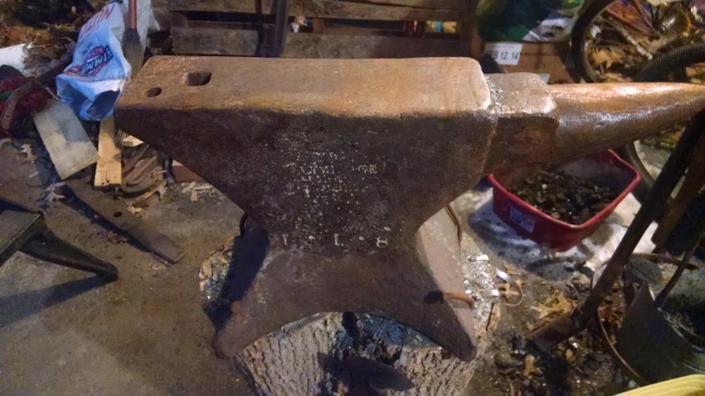

TwistedCustoms Posted December 14, 2015 Share Posted December 14, 2015 I found this one over the weekend. I'm pretty happy with the condition. Rebound is great from the cut plate back to the hardy. It gets a little dead over the heel. Not sure what to make of that but the heel "looks" good. I just started stripping the paint this morning and I'm happy with it. I got a good price and the seller is a great guy so a new friend to boot! I'm going out this afternoon to forge with it. I couldn't, wait to see the imprint better so I went ahead and brushed it off but my favorite way to remove rust and paint is to put hot metal on the anvil and forge it into something useful! Happy hunting to all my fellow anvil stalkers. Quote Link to comment Share on other sites More sharing options...
MarkDobson Posted December 14, 2015 Share Posted December 14, 2015 nice anvil. the reason you lose rebound behind the hardy is because you dont have as much mass under the heel. no pritchel means its pretty old, if i remember correctly that means is pre 1850's or earlier. im sure one of the guys with more knowledge on anvils will correct me if my date is off Quote Link to comment Share on other sites More sharing options...
JHCC Posted December 14, 2015 Share Posted December 14, 2015 Good score! I have an M&H Armitage Mousehole as well; mine's 148 lbs (marked 1*1*8) and has great rebound. As I understand it, Mousehole used the M&H marking from 1820 to 1835 and started adding pritchel holes circa 1830. Interestingly, my M&H does have a pritchel, so although it's not much newer than yours, it stands on the other side of that era marker. Quote Link to comment Share on other sites More sharing options...
ThomasPowers Posted December 14, 2015 Share Posted December 14, 2015 Don't forget that a lot of older anvils had pritchels retrofitted, usual way to determine if original or added is the earlier ones were punched and retrofitted ones were drilled...check the bottom of the heel for evidence of punching... Quote Link to comment Share on other sites More sharing options...

TwistedCustoms Posted December 14, 2015 Author Share Posted December 14, 2015 2 hours ago, JHCC said: Good score! I have an M&H Armitage Mousehole as well; mine's 148 lbs (marked 1*1*8) and has great rebound. As I understand it, Mousehole used the M&H marking from 1820 to 1835 and started adding pritchel holes circa 1830. Interestingly, my M&H does have a pritchel, so although it's not much newer than yours, it stands on the other side of that era marker. I believe the 1820-1835 date is correct. My other mouse hole is later, lighter, in much worse condition, has a pritchel and has great rebound on the heel. The one posted in this thread is thicker and wider in the heel and all rebound evaporates behind the hardy. Go figure. At any rate, I forged on it a couple of hours this afternoon and I love it! Quote Link to comment Share on other sites More sharing options...
Fatfudd Posted December 15, 2015 Share Posted December 15, 2015 I have several very early Mousehole anvils and your's corresponds to a 1820 to 1830 make. I have a similar anvil with the M&H logo and a pritchel hole that dates from the 1830 t0 1835 era, Mine all have great rebounds and are wonderful anvils to work on. Good score, it may be 185+ years old but it will outlast all of us if it is carefully used! Make something om it and show us how it has taught you to be a blacksmith. Quote Link to comment Share on other sites More sharing options...
JHCC Posted December 15, 2015 Share Posted December 15, 2015 6 hours ago, ThomasPowers said: Don't forget that a lot of older anvils had pritchels retrofitted, usual way to determine if original or added is the earlier ones were punched and retrofitted ones were drilled...check the bottom of the heel for evidence of punching... Well, I checked. I'm guessing punched, as there is a slight bulging on the underside, and I don't see any obvious drill marks inside the hole. Anything else I should be looking for? Quote Link to comment Share on other sites More sharing options...
Fatfudd Posted December 15, 2015 Share Posted December 15, 2015 From what i can see your anvil does not have a pritchel hole, that's why I said its date of manufacture is between 1820 and 1830. The only hole I see in your pictures is the hardy hole which would have been punched. Quote Link to comment Share on other sites More sharing options...

falsevacuum Posted December 17, 2015 Share Posted December 17, 2015 The coloring on the edge looks a little off. Is it possible this anvil was welded up? Or am I mis-seeing things? Quote Link to comment Share on other sites More sharing options...
Ian Sayers Posted December 17, 2015 Share Posted December 17, 2015 does it have a handling hole in the throat, under the horn? Quote Link to comment Share on other sites More sharing options...
TwistedCustoms Posted December 19, 2015 Author Share Posted December 19, 2015 On 12/17/2015 at 2:58 AM, falsevacuum said: The coloring on the edge looks a little off. Is it possible this anvil was welded up? Or am I mis-seeing things? I don't believe its been welded, the rebound is flawless over the whole face from edge to edge. Someone painted over rust and I photographed it right after wire brushing it off. On 12/17/2015 at 3:06 PM, Ian Sayers said: does it have a handling hole in the throat, under the horn? Yes, handling hole front and back. Quote Link to comment Share on other sites More sharing options...

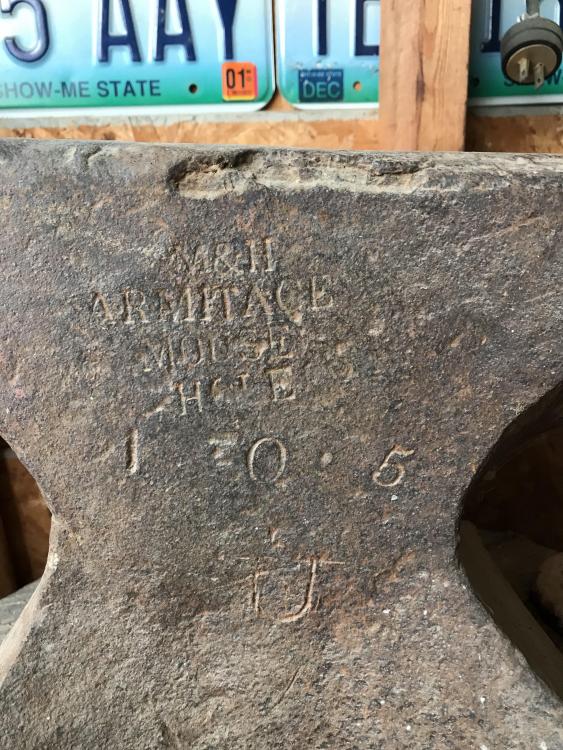

SEMO forge Posted April 12, 2018 Share Posted April 12, 2018 i was working for a man at my church yesterday and found this anvil, can you guys help me date it at all? it feels like mine in weight (about 115lbs) the farm was bought in the 1880s and i don't know when the anvil was bought (with the farm or after) Quote Link to comment Share on other sites More sharing options...
arkie Posted April 12, 2018 Share Posted April 12, 2018 I recommend that those of you with the Mousehole anvils lay your hands on a copy of Richard Postman's "Mousehole Forge" book. Either purchase or library loan...fantastic reading about the history of the Mousehole forge and the area. I'm not a history buff, and don't have a Mousehole anvil, but I believe I've read it about three times now. Quote Link to comment Share on other sites More sharing options...
ThomasPowers Posted April 12, 2018 Share Posted April 12, 2018 The weight is clearly stamped in the CWT system, (used for older English Anvils): 1.0.5 is 1 x 112 + 0 x 28 + 5 = 117 pounds, however stamped weight is often a few pounds different than what shows up when we weigh it on the bathroom scale. (American anvils are stamped in pounds and European anvils in kg---except some sold in America which use pounds...) If I'm see the stampings correctly and reading postman's book correctly: M & H ARMITAGE MOUSE HOLE [weight stamp] was used circa 1820 to 1835---does the anvil have a pritchel hole in the face? Quote Link to comment Share on other sites More sharing options...
SEMO forge Posted May 2, 2018 Share Posted May 2, 2018 it does not have a pritchel hole Quote Link to comment Share on other sites More sharing options...
JHCC Posted May 2, 2018 Share Posted May 2, 2018 Probably 1820-1830, then. Quote Link to comment Share on other sites More sharing options...
