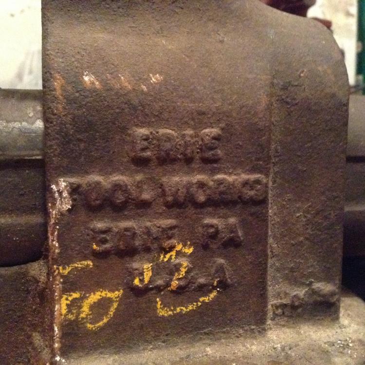

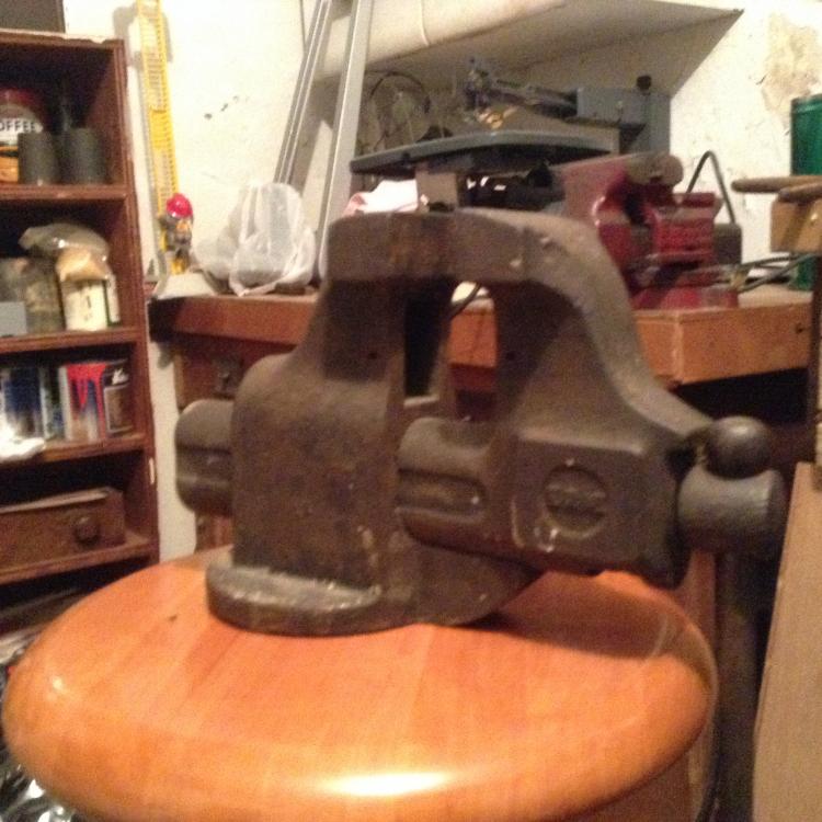

Yeah smoggy I hope i will be able to but who knows. I saw a guy in this thread post a picture of a vise that I don't quite know the name of, but it seems like it would work good. It was Vaughn who posted it. Nice and small and I have used them in my shop class before and they work pretty well. Anyways, here is my vise. It is made by Erie vises and the jaws are 4in. Thanks

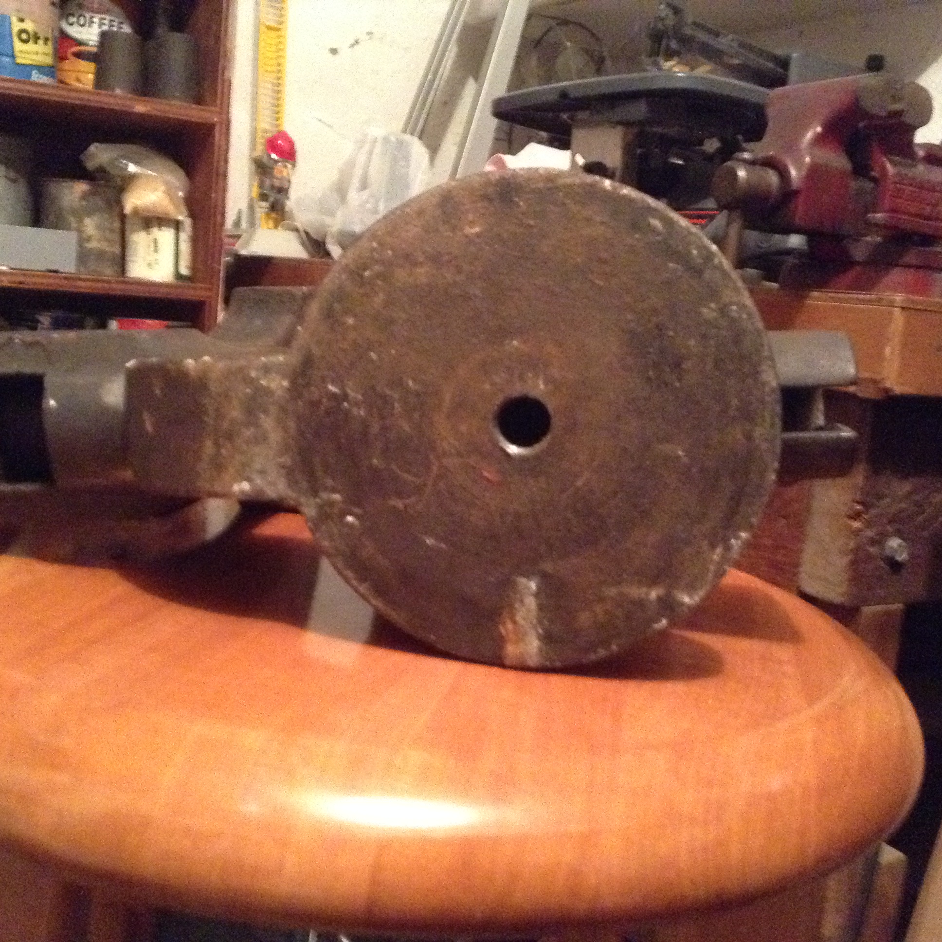

With the threaded center hole, you could make a real simple hardy stem and have that girl working pretty quick.  However, with only one bolt hole, you're always running into the thing wanting to unscrew if you don't turn your stock the right direction.  Not a major concern, but something to think about.  It'll want to loosen up as you hammer on stuff, etc.

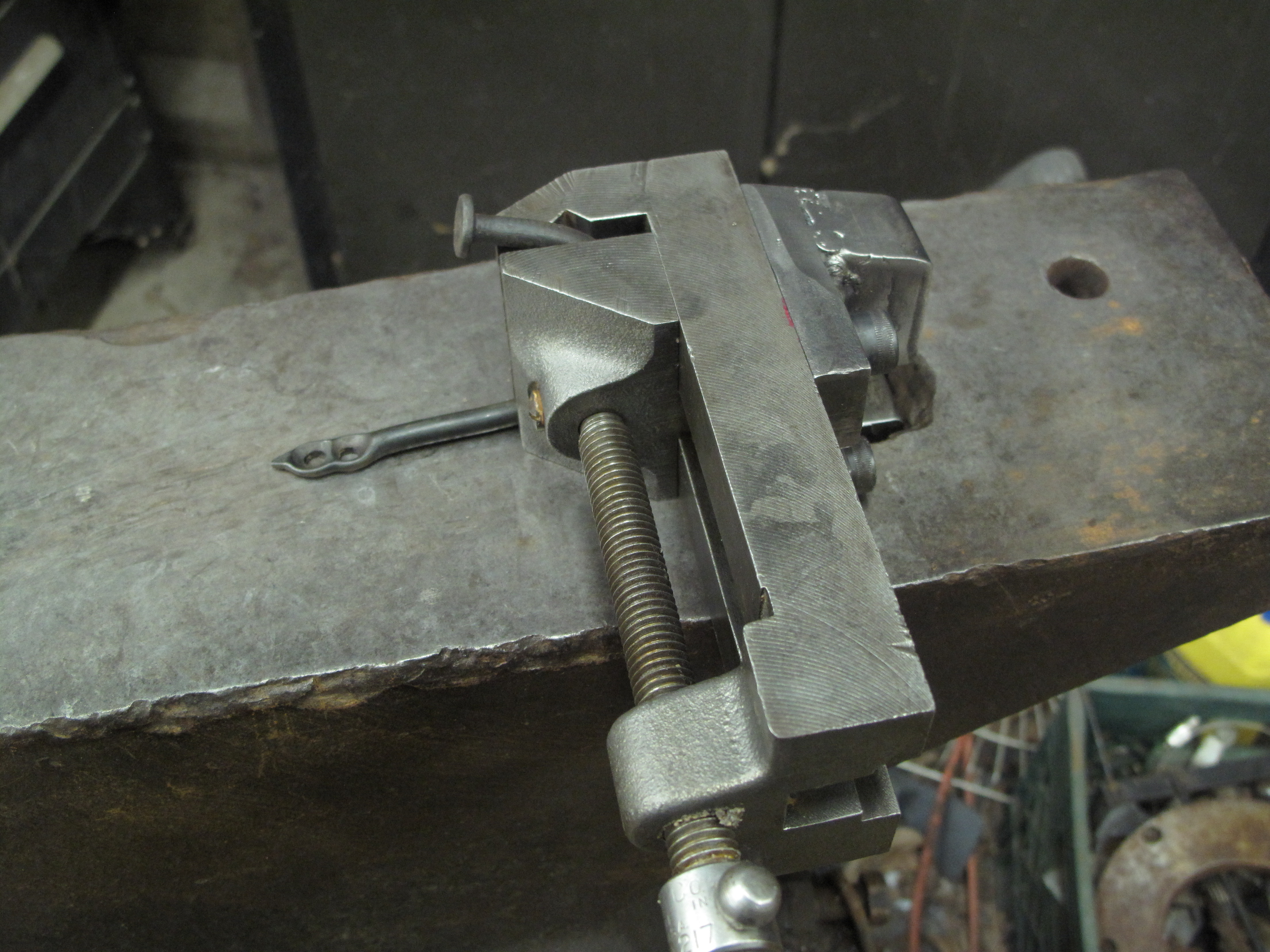

The only problem I can see is that the jaws are fairly far from the face of the anvil, so you'll only be able to grab stock that's big enough to span the gap if you wanted to upset an end for making a rivet or the like.  As Swede mentioned, you might be better off making two types of brackets, one that will mount directly to the hardy hole and one that mounts to the side of the stump so the vise can act as a third hand to hold metal while you punch and drift.
Definitely a workable piece of kit, though.  No harm in using it, seeing what you like and don't like, then modifying it in the future.
