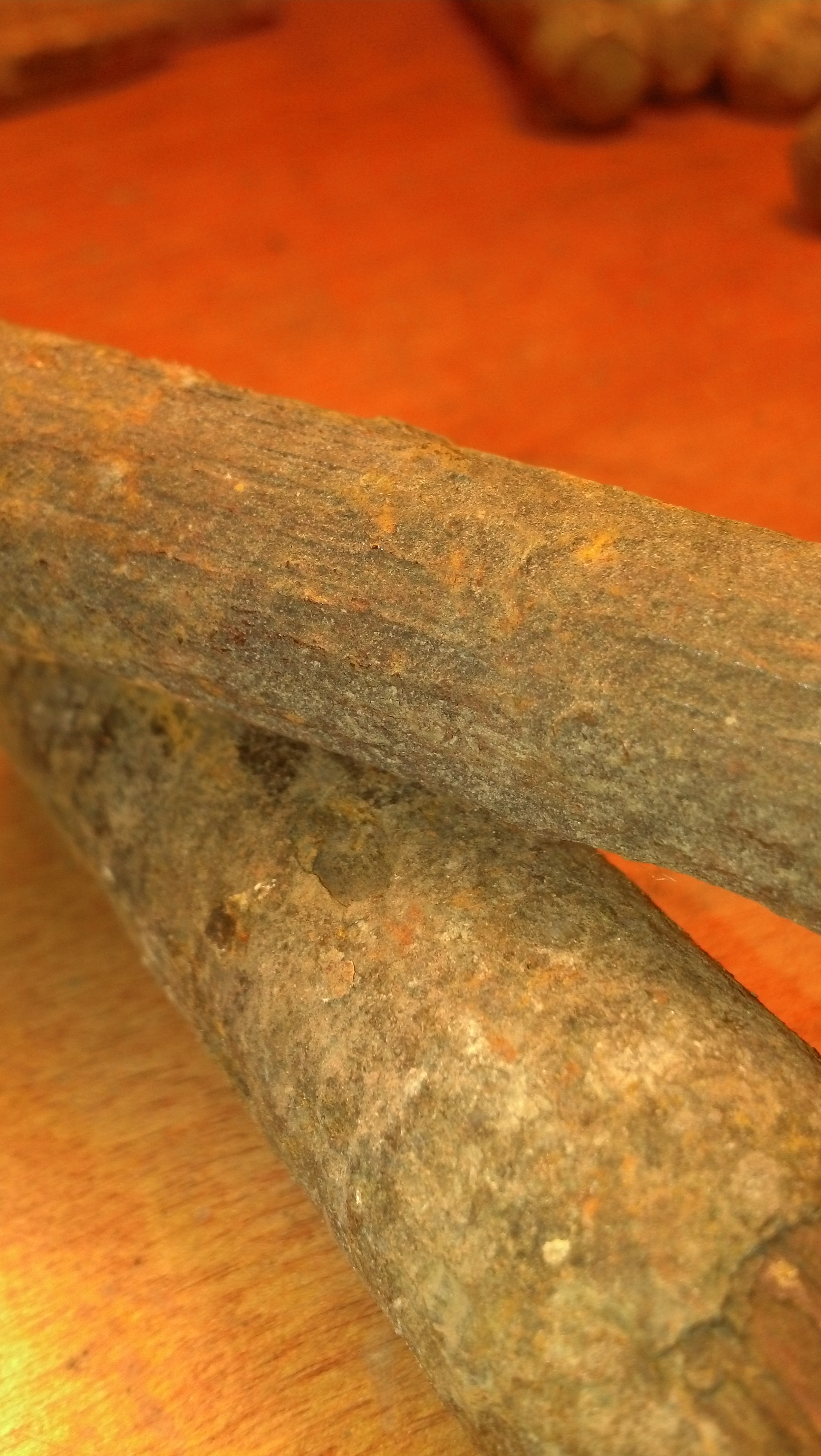

 Hello to all, thank you in advance for your time and consideration. I have recently come across what I think is a healthy pile of wrought iron. I believe all pieces are wrought except for the spike on the right in the second pic(3 in last pic). I would try to cut and bend or spark test if my angle grinder was not on vacation...(funny how tools go on then never return from vacation)All show grain where rust was knocked off. Looking for a more practiced eye to confirm my guesses.
 Just a thought, if wrought doesn't harden, could I bring it up to temp, quench and try to bend in vice? Should still bend,? Or have I missed something,  still new to all this. Thanks again.
Sorry so many pics...lots of different pieces to identify.
Yes that is wrought iron. The woodgrain look is a dead giveaway.
As to bending. Either bend it cold if you have the capabilities, or heat and bend. No need to quench.
 Thank you for a speedy reply, thought I got lucky on this one, hard to be sure without someone who knows though.

Classic pattern for rusted wrought iron.
Note: Not all wrought iron is very low carbon; and very low carbon mild steel will bend after quenching too so that methodology is right out.
