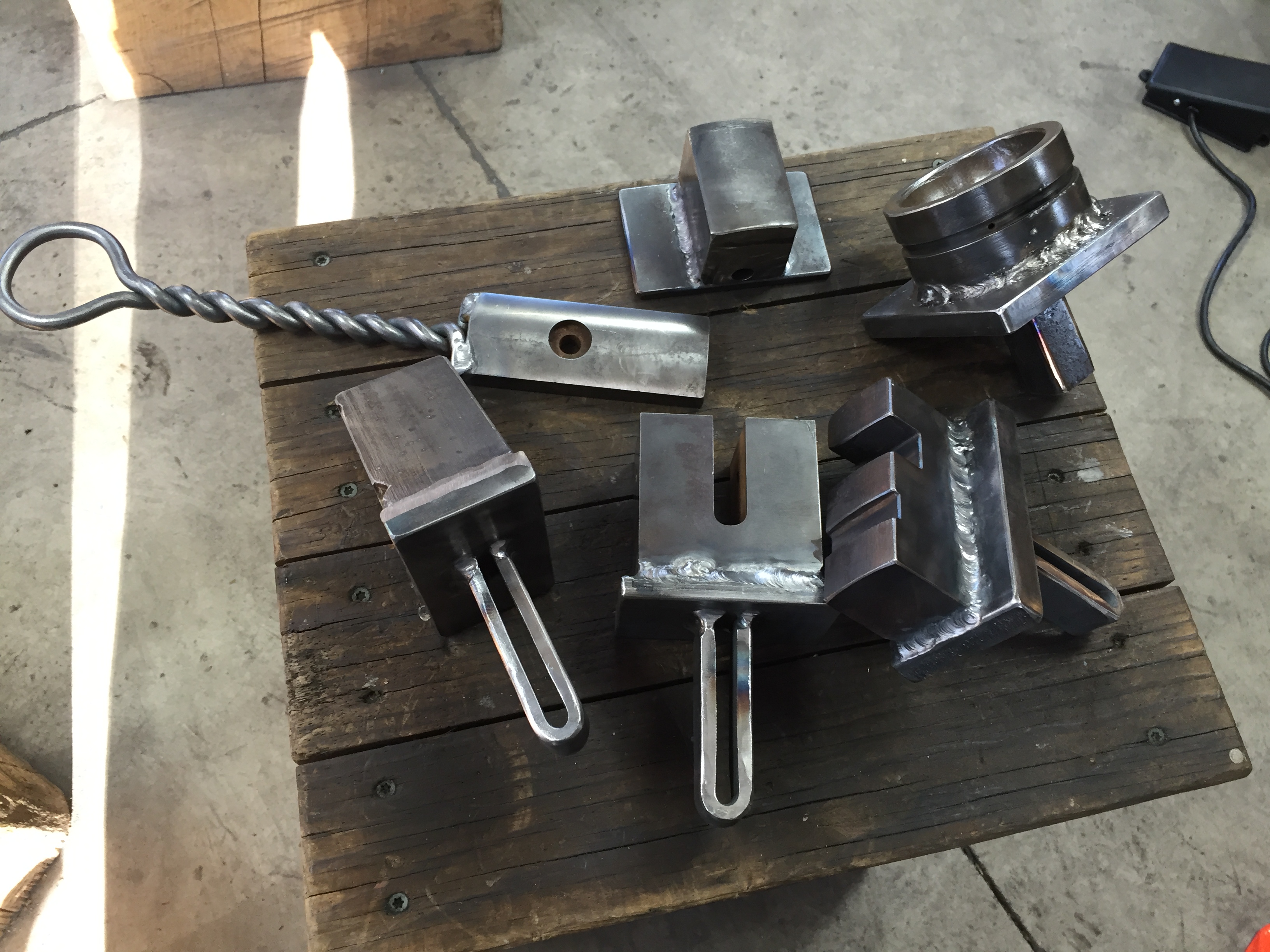

I just made up some anvil bottom and treadle hammer tools from some found tool steel stock. Pictured is a simple handle design that I use.. 5/16 twisted stock with a 2 1/2 diameter ring. They work well because you can move the tool in all directions without a tight grip on just a shaft. Works well with gloves on also. Easy to make give one a try.. Hope this helps.
Jim

Jim nice handle !! I will have to make one like that & try   Thanks

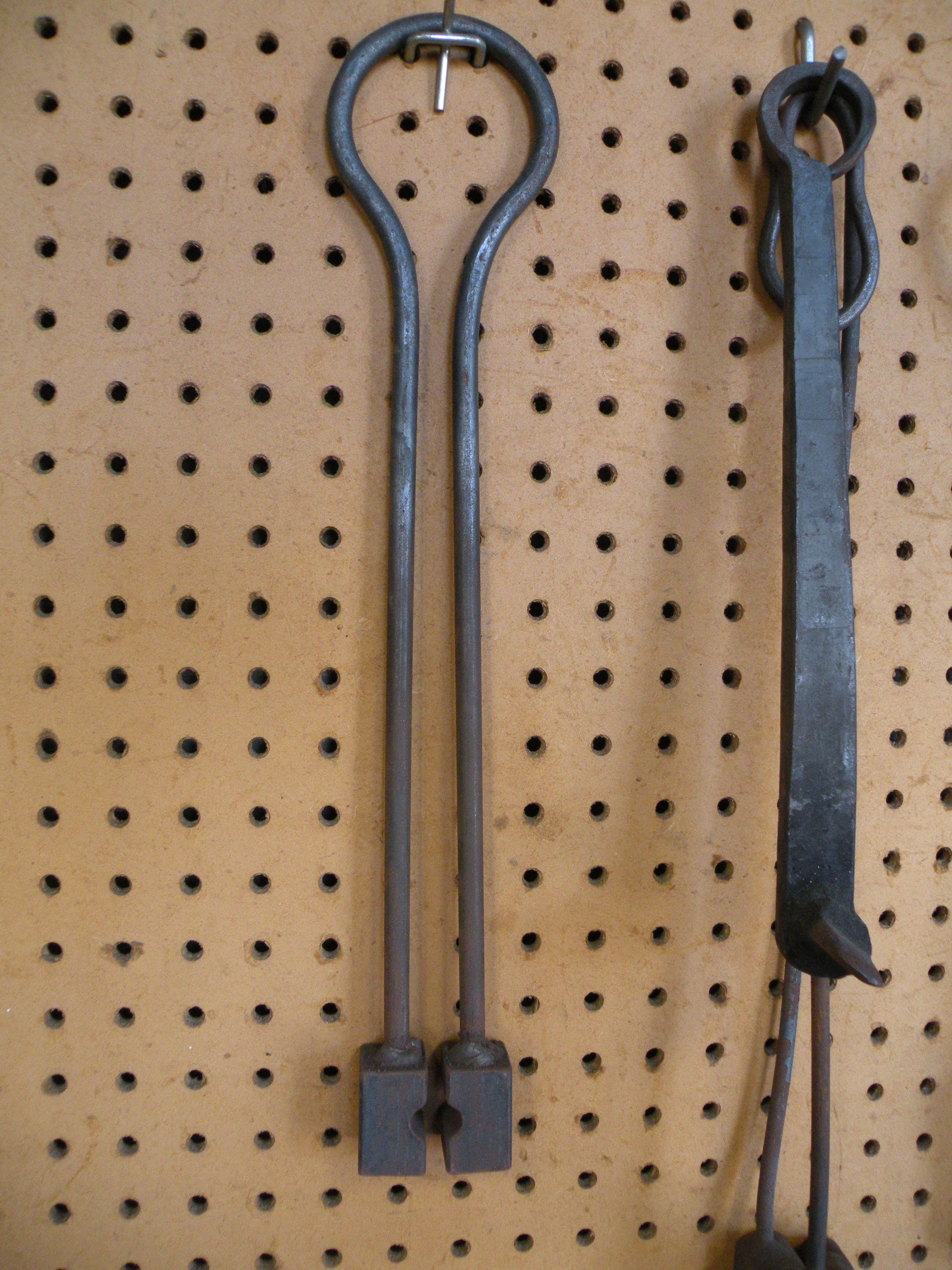

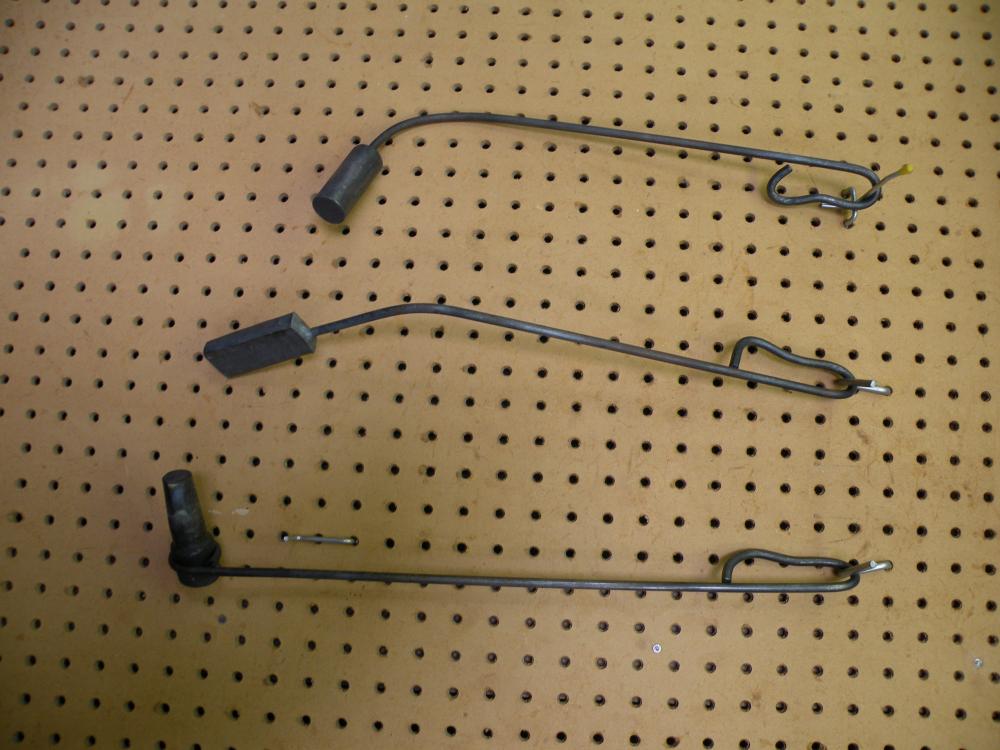

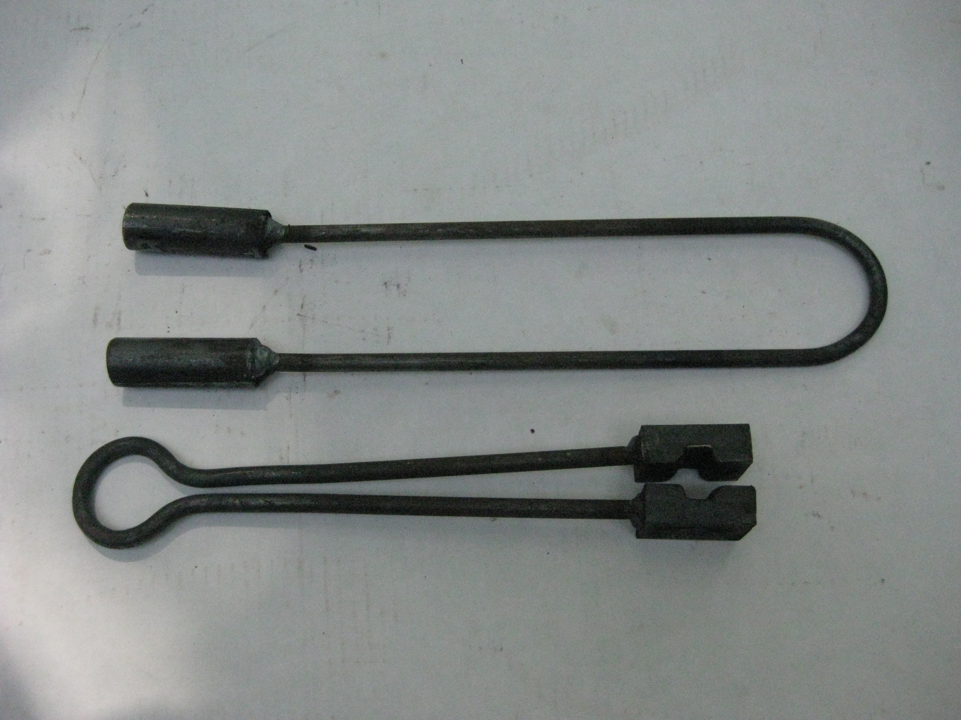

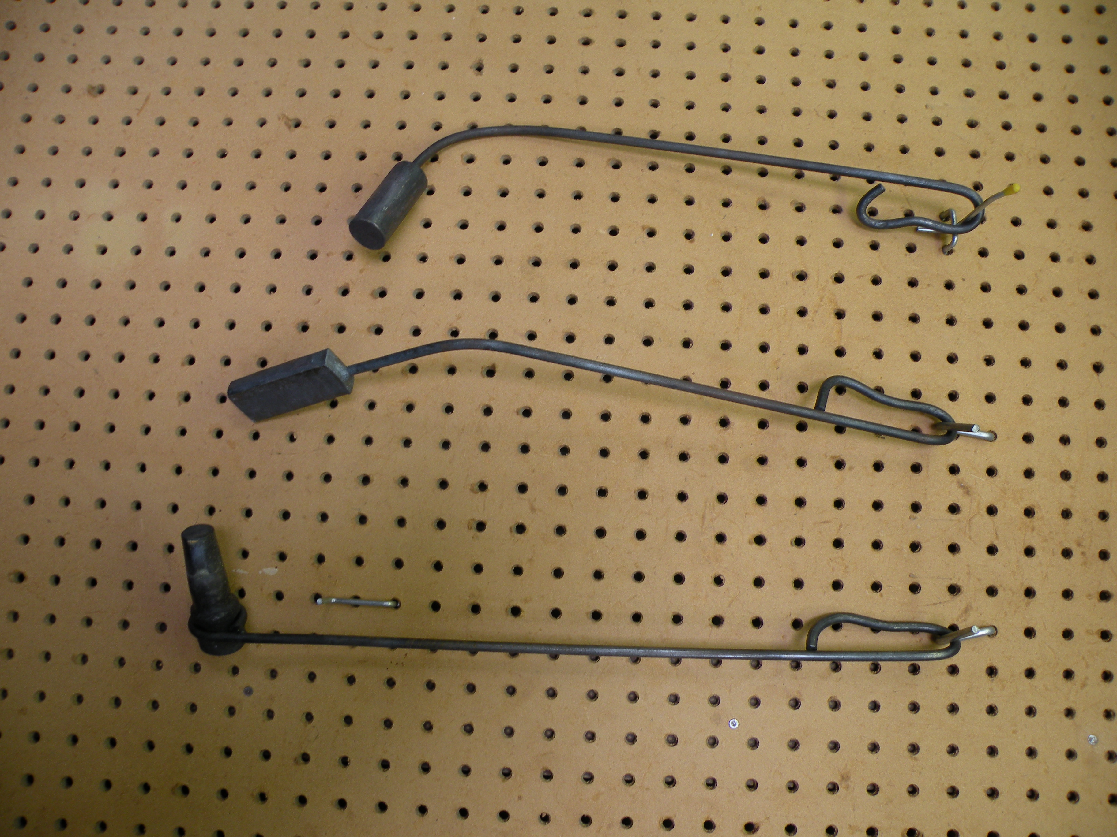

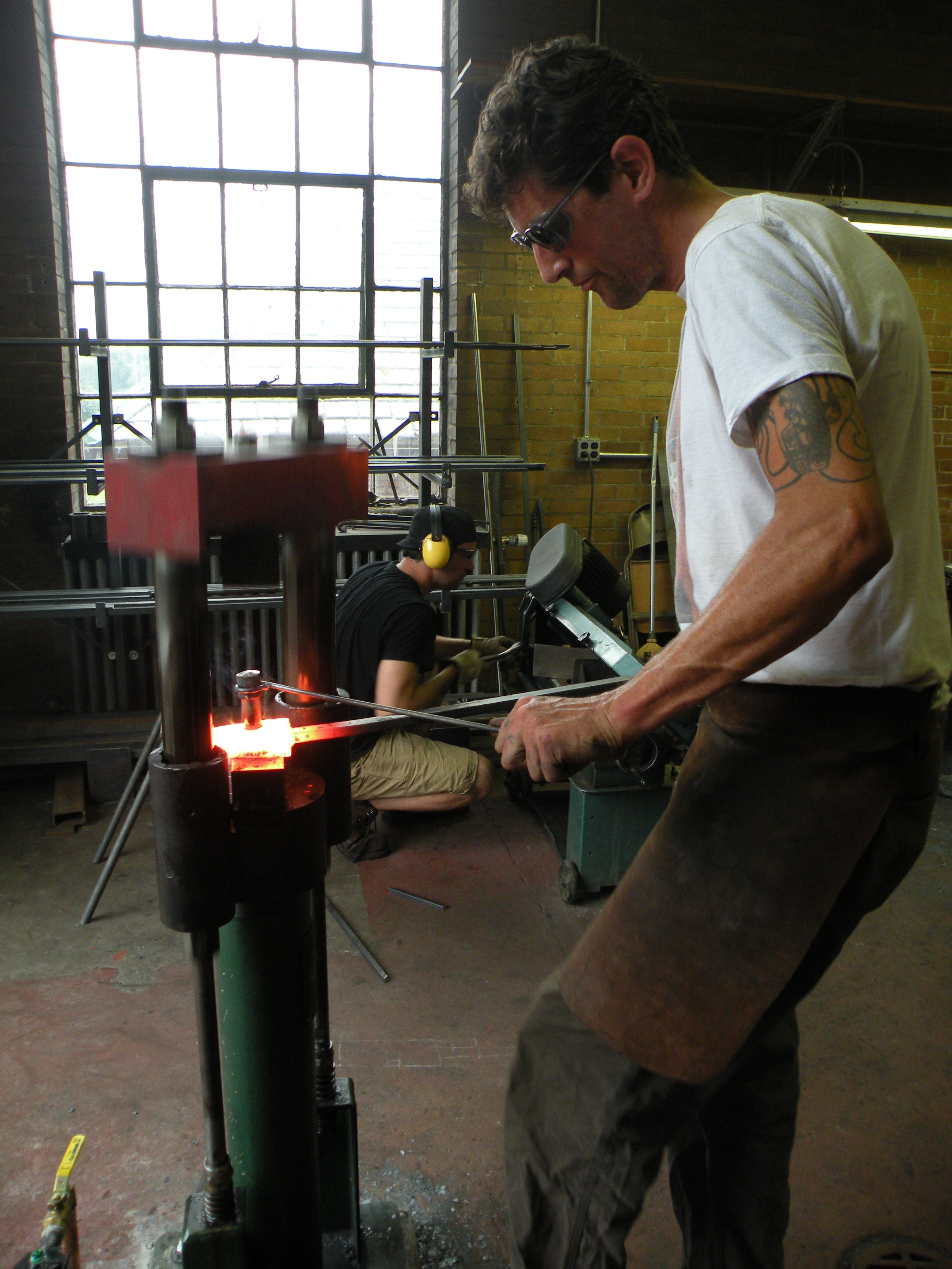

I thought I had a few picts that showed the handles on the power hammer tooling at the college better, but it looks like most were of the working ends of the tools vs the handles. I did find one showing some of the rod and loop handles and one of Warren using the bottom punch in the power hammer as well as two so so picts of a returning loop handle used on fullering or necking dies.The one from the college and the 2nd of ones I made there to do my top tools and tenons for my forge legs. I bent the last one around a bit too far. I should have left a bigger space between the rods and kept them parallel like the one the college has. If you aren't careful you can get pinched a bit in the back near the loop. Nothing that really hurts, but enough to feel it if you forget.

DSW...  please, more info on the power hammer in he photo !
