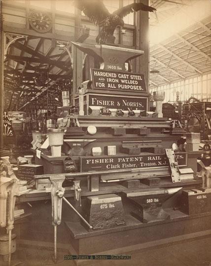

I'm sure Josh will chime in at some point on this. Fisher made what I believe was a 1400lb anvil for the Centennial Expo in Phila. I think he's commented that NJ State Museum may have that anvil.
c022385.thumb.jpg.33e6b81d4c11752230e909

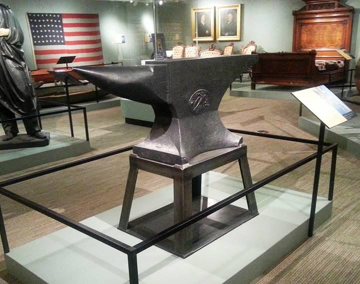

The one in that display above is now in the New Jersey State Museum.11866343_722726031165139_299859834684726
The big FISHER in the NJ State Museum is about 60" long, the face is 9", and it is about 22" tall.  It is said to be 1400 lb, but has never been weighed on a certified scale.  If it ever comes off exhibit, I will try to borrow it, and the first stop would be a weigh-in.
I am sure the English anvil makers also made big anvils for these exhibitions.  I hope they too survive to this day.

Nothing will happen with the Big Fisher until at least Jan 2018, and NJ gets a new Governor.  The present administration has de-funded the museum so much, that it is operating on a shoe-string budget.  No displays will be changed until then.  They are not interested in any weigh-in.  The museum has the anvil on display in a "made in NJ" section.  They were not interested in displaying any smaller Fisher anvils that reflected what the company produced in quantity.  I offered to lend them anything.
