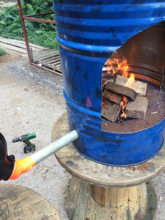

55_side_blast.thumb.JPG.ebe9123b1ee84698
Y&D
Here is a pic of a 55 side blast.
The tweer pipe is duct taped into the blower and stuck thru a ragged hole  in the side of the drum cut with a chisel.  The drum was lined with red clay that we spent about a hour hammering into the bottom of it.  It took about 3 hours to build the whole thing, and this was in a country were I didn't speak the language!  It was not pretty but it was up and running on day one.
